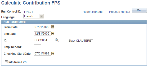

Use the Calculate Contribution FPS page (RUNCTL_FPA1100) to run the Calls for Entitlement SQR process (FPA1100) that identifies and calculates employee contributions.
Navigation:
This example illustrates the fields and controls on the Calculate Contribution FPS page. You can find definitions for the fields and controls later on this page.
Field or Control |
Description |
From Date and End Date |
The end date is automatically set to six months after the start date, but you can modify this date. |
ID and Empl Rcd Nbr (employee record number) |
Enter one or both. When left blank, the system calculates all employees' contributions. |
Checking Start Date |
The system checks that no retroactive modifications affect existing calculations between the check start date and the semester start date. By default, the period checked is 10 years. |
Info From FPS |
Select to import required data from the home organization. |
Click Run. The system identifies employee deductions by employee ID, semester, title number, and sequence number.
