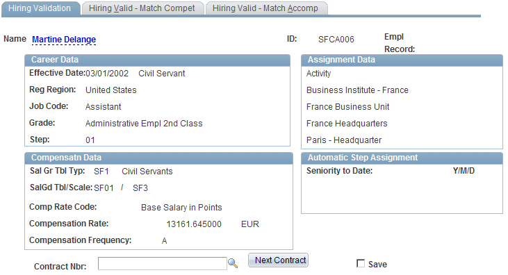

Use the Hiring Validation page (FPAEERATIFY_PNL1) to validate the hire.
You can select only those employees who have existing records and whose hiring must be manually validated. You can't select employees whose hiring validation is automatic.
Navigation:
This example illustrates the fields and controls on the Hiring Validation page. You can find definitions for the fields and controls later on this page.
To validate the hiring process:
Review the displayed data, including data on the other pages of the component.
Click Next Contract to create a contract.
Select Save to validate the hire.
If the employee is lacking competencies or accomplishments, the system issues a message but the process continues. Once you save the page, the employee's status is Active.
