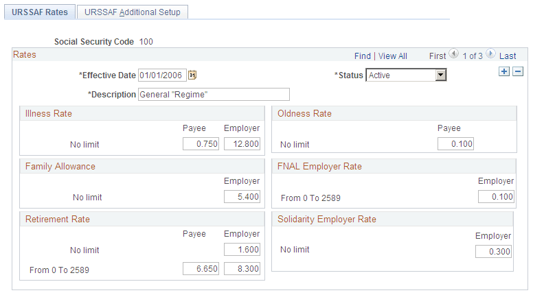

Use the URSSAF Rates page (GPFR_URS_RATES) to review the URSSAF rates for illness, old age, family benefits, FNAL Employer, and Retirement rates.
Navigation:
This example illustrates the fields and controls on the URSSAF Rates page. You can find definitions for the fields and controls later on this page.
Field or Control |
Description |
Illness Rate |
Displays the illness contribution rates for Payee and Employer. |
Family Allowance |
Displays the rate for family allowance. |
Retirement Rate |
Displays the two contributions towards the retirement rate. The employer pays a rate based on the entire funding base. This is displayed opposite No Limit. The second contribution, paid by both payee and employer, is applied to a funding base limited to Ceiling A. |
Oldness Rate |
Displays the contribution rate for old age benefits. |
FNAL Employer Rate |
Displays the rate that applies to a funding base limited to Ceiling A. Note: FNAL contributions not limited to Ceiling A are maintained on the Variables By Category page. Only FNAL contributions limited to Ceiling A are maintained on the URSSAF Rates page. |
Solidarity Employer Rate |
Displays the solidarity contribution rate. |
Note: Several of the contribution sections on this page display the comment No limit. This means that the contributions for each section are not based on an earning ceiling. They are calculated from the entire funding base, with no limit.

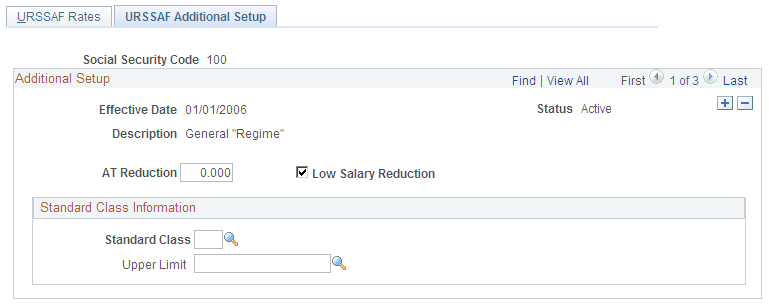

Use the URSSAF Additional Setup page (GPFR_URS_GENERAL) to view (and if necessary, modify) additional URSSAF parameters.
Navigation:
This example illustrates the fields and controls on the URSSAF Additional Setup page. You can find definitions for the fields and controls later on this page.
Field or Control |
Description |
Social Security Code |
Displays the payees' existing contribution class—not that of the standard class. |
AT Reduction |
Displays the percentage amount of the reduction in the work accident rate if the contribution class (régime) qualifies for a reduction. You can adjust this amount if necessary. |
Low Salary Reduction |
Select this check box to trigger the Fillon reduction if the payee earns a low salary. |
Standard Class |
Displays the standard class to which payees are assigned if they become ineligible for their original class. For example, payees in some contribution classes contribute using the rates for their class if their monthly salary is less than or equal to the SMIC (minimum monthly salary). When payees belonging to one of these classes earn more than the SMIC, they automatically begin contributing using the rates in effect for the standard class. These rates apply only to the portion of the salary that exceeds the earning limit. |
Upper Limit |
