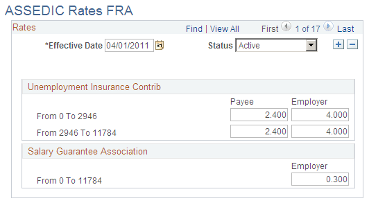

Use the ASSEDIC Rates FRA page (GPFR_ASS_RATES) to set up rates for ASSEDIC contributions.
PeopleSoft delivers these rates, but you can maintain them when the government issues updates.

This example illustrates the fields and controls on the ASSEDIC Rates FRA page. You can find definitions for the fields and controls later on this page.
Unemployment Insurance Contrib (unemployment insurance contributions)
The fields in this region display the Payee and Employer contribution percentages for the portion of gross salary below the A ceiling and Payee and Employer contribution percentages for the portion of gross salary below the B ceiling but above the A ceiling.
Note: The field names in this region are dynamically displayed based on the values entered on the Ceilings page. These values change each year
Salary Guarantee Association
The field in this region displays the Employer contribution percentage for FNGS.
Note: There is only an employer contribution percentage for FNGS, not for payees. This rate is based on the B ceiling, which is displayed dynamically. If the gross salary is over this limit, the contribution is still based on the B ceiling.
