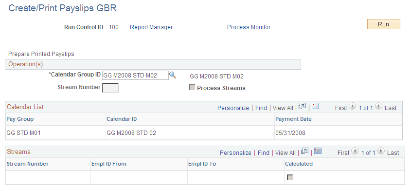

Use the Create/Print Payslips GBR page (GPGB_PSLIP) to run the Printed Payslip Job PSJob process (GPGBPYSP).
This job runs the Payslip Preparation process (GPGB_PSLIP_X), followed by the Printed Payslip SQR report (GPGBPSLP), and the Create Self Service Payslip process (GP_EPAY). You must set up payslips on the payslip definition pages before running the payslip processes.

This example illustrates the fields and controls on the Create/Print Payslips GBR page.
Operations
Field or Control |
Description |
Calendar Group ID |
Select the calendar group for which you want to load payslip result data. |
Stream Number and Process Streams |
Select the stream for which you want to load payslip result data. Stream and Process Stream fields are as defined on the Streams and Payroll/Absence Run Control pages. If you have defined them for processing, then you can use them to select results. |
Calendar List
Field or Control |
Description |
Pay Group |
Displays the pay group for which you are loading payslip result data. |
Calendar ID |
Displays the calendar ID for which you are loading payslip result data. |
Payment Date |
Displays the payment date for which you are loading payslip result data. |

Streams
Field or Control |
Description |
Stream Number |
Select the streams you are using to load data into the payslip printing tables. |
Calculated |
Indicates which streams have been calculated. |
