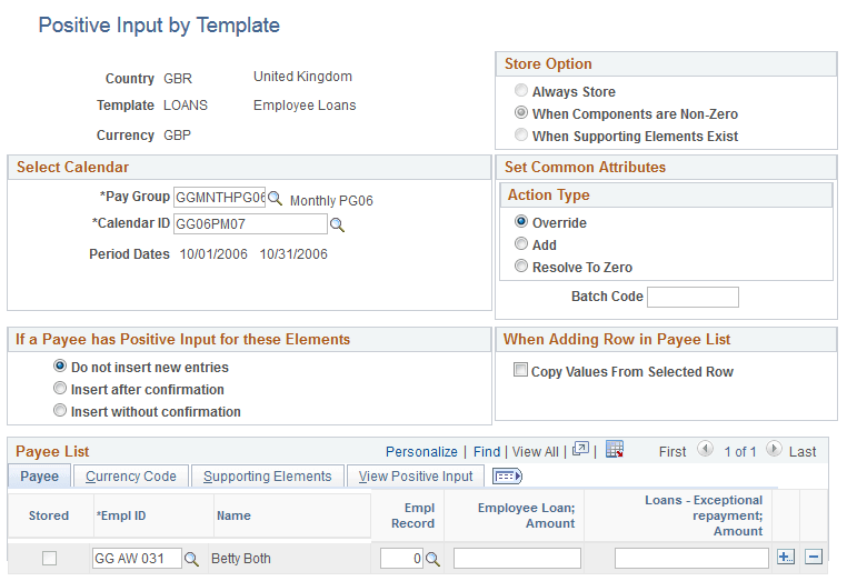

Use the Positive Input by Template page (GP_PI_BULK_SSN) to use the template delivered for the UK to enter positive input for loans.
Navigation:
This example illustrates the fields and controls on the Positive Input by Template page.
Field or Control |
Description |
Action Type |
Select one of these options: Override: To override the repayment amount for the pay period. Add: To enter an additional repayment amount or an exceptional amount. |
Employee Loan: Amount |
Enter the override or additional amount. Leave this field blank if the positive input is for an exceptional amount. |
Loan – Exceptional repayment: Amount |
Enter the exceptional amount. Leave this field blank if the positive input is for an override or additional amount. |

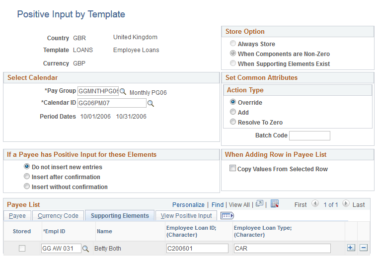

Supporting Elements
Access the Supporting Elements tab.
This example illustrates the fields and controls on the Supporting Elements tab of the Positive Input by Template page.
Field or Control |
Description |
Employee Loan ID (Character) |
Enter the loan ID defined for this loan on the Employee Loans page. |
Employee Loan Type (Character) |
Enter the loan type. |
