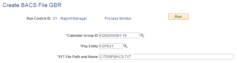

Use the Create BACS File GBR page (GPGB_BANK_EFT) to run the Create the EFT File SQR process (GPGBEFT).
This process creates a fixed-length ASCII file that can be used as input to BACS processing software. The system displays as valid values only those calendar run IDs that have had the banking finalize step run.

This example illustrates the fields and controls on the Create BACS File GBR page.
Field or Control |
Description |
EFT File Path and Name (electronic file transfer file path and name) |
Enter the path and file name for location of the EFT file that you want to create. |
