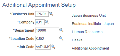

Use the Additional Appointment Setup page (AA_SETUP_JPN) to enter the dummy business unit, company, department, location, and job codes to populate required entry fields on the Job record for additional appointments.
Navigation:
This example illustrates the fields and controls on the Additional Appointment Setup page. You can find definitions for the fields and controls later on this page.
The prompt values for the Business Unit, Company, Department, and Location Code fields are the valid codes set up in the respective setup tables for your PeopleSoft database. In each field, select the single dummy code that you defined for use with additional appointments.
| Field or Control | Description |
| Job Code | AADUMY is the default value. |
The system uses the values on this page to populate the Job record so that it can be saved.
