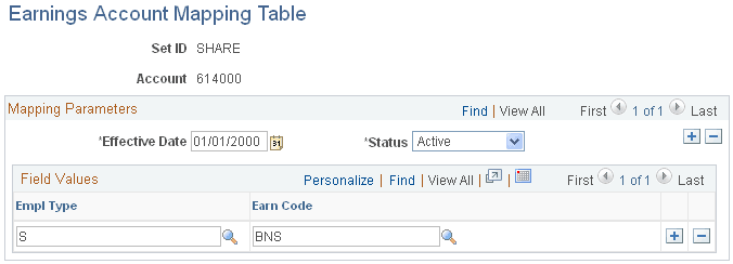

Use the Earnings Account Mapping Table page (HP_ERN_ACCT) to map earnings field values to accounts.
Navigation:
This example illustrates the fields and controls on the Earnings Account Mapping Table page.
To map earnings field values to accounts:
Select the effective date and status of the earnings account mapping.
Select values in each of the fields displayed in the grid to map them to the earnings account. The grid only displays the fields you selected on the Earnings Account Template page.

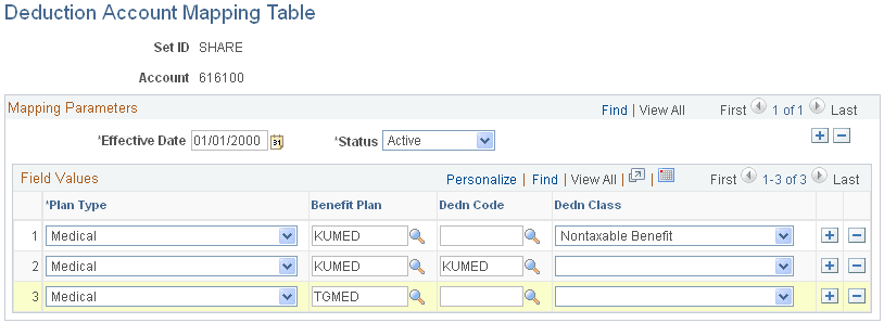

Use the Deduction Account Mapping Table page (HP_DED_ACCT) to map deductions field values to accounts.
Navigation:
This example illustrates the fields and controls on the Deduction Account Mapping Table.
To map field values to deduction accounts:
Select the effective date and status of the deduction account mapping.
Select values in each of the fields displayed in the grid to map them to the deduction account. The grid only displays the fields you selected on the Deductions Account Template page, with the exception of Plan Type, which is required for deduction account mappings.

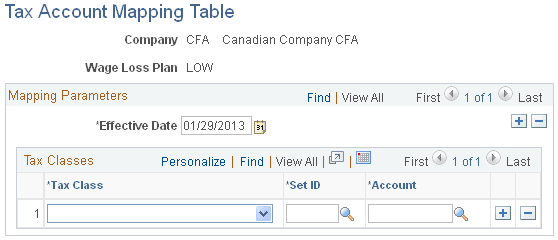

(CAN) Use the Tax Account Mapping Table page (HP_CTX_ACCT) to map wage loss plans, companies and tax classes to accounts.
Navigation:
This example illustrates the fields and controls on the Tax Accounting Mapping Table page.
Canadian tax accounts are connected to companies and wage loss plans. Connect tax classes with accounts and map these rows to companies and wage loss plans.
To map companies and wage loss plans to tax classes and accounts:
Select the effective date of the tax account mapping.
Associate tax classes with accounts to map to this company and wage loss plan.

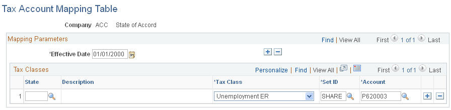

(USA) Use the Tax Account Mapping Table page (HP_TAX_ACCT) to map companies and tax classes to accounts.
Navigation:
U.S. tax accounts are connected to companies. Connect tax classes with accounts and map these rows to companies.
To map companies to tax classes and accounts:
Associate tax classes with accounts to map to this company.
