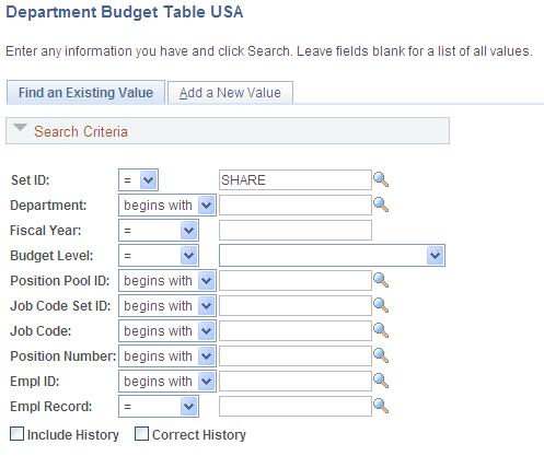

Department Budget Table Search Page
Once you select the budgeting level for a department, enter budgeting information using the Department Budget Table component. When you select Department Budget Table CAN or Department Budget Table USA from the menu, the Department Budget Table search page appears. The budget level you specify in the search page enables you to pinpoint the level of detail you want to see in the Department Budget Table component.
This example illustrates the fields and controls on the Department Budget Table search page.
In the search page, you must select the SetID, Department,Fiscal Year, and Budget Level for the department budget you that are defining. The information you specify here displays at the top of each of the each page in the Department Budget Table component.
Select a Budget Level from the following options:
Appointment: If selected, also select an EmplID. The EmplID can be for a full time employee, part time employee, contractors, and so on. Also select an Empl Record for the selected person.
Department: Select if you are defining the department budget at the department level.
Jobcode: If selected, also select a valid Job Code.
Position Pool: If selected, also select a Position Pool ID.
Position: If selected, also select a Position Number.
When you've specified the department budget information, select OK.

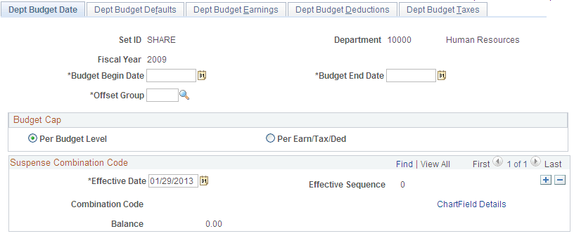

(CAN) Use the Dept Budget Date (department budget date) page (DEPT_BUDGET_DATE) to define the fiscal year budget's begin and end-dates as well as other department budget information.
Note: (USA) The Dept Budget Date (department budget date) page (DEPT_BUDGET_TAX) for USA is similar to the one for Canada.
Navigation:
This example illustrates the fields and controls on the Dept Budget Date page.
The options on the Dept Budget Date page are available only when you create a new department budget or access an existing budget in correction mode.
Field or Control |
Description |
Budget Begin Date and Budget End Date |
Enter the begin and end dates of this department budget. |
Offset Group |
Enter an offset group to specify the offset combination code to be used for each type of transaction. |
Budget Cap
Field or Control |
Description |
Budget Cap |
Specify the type of budget cap for this department budget. At each budget level, define a cap as follows:
Overall budget and earnings caps are maintained on the Dept Budget Earnings page. Separate caps for taxes and deductions are maintained on the Dept Budgets Deduction and Dept Budget Taxes (U.S. and Canada) pages, respectively. |
Suspense Combination Code
Field or Control |
Description |
Combination Code |
Select the ChartField Details link to specify a suspense combination code. The encumbrance and actuals processes will charge all unfunded amounts to this account enabling the encumbrance and actuals processes to continue posting to the specified combination code even when the funding source is exhausted or inactive. Indicate at least one suspense combination code and indicate the effective date of the suspense combination code for each department budget. The combination code you use here cannot be used anywhere else in the department budget. Don't correct this combination code after it has been used; instead, enter a new, effective-dated suspense combination code. |

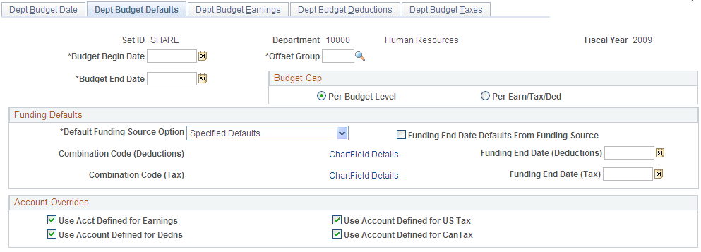

Use the Dept Budget Defaults (department budget defaults) page (DEPT_BUDGET_DFLT) to set up budget defaults, such as funding source option, default deduction and tax funding sources.
Navigation:
This example illustrates the fields and controls on the Dept Budget Defaults page.
Funding Defaults
Field or Control |
Description |
Default Funding Source Option |
Indicate if the Default Funding Source Option is Specified Defaults, Distrib over Actual Earnings or Earnings Funding Source If there is no Default Funding Source Option, select No Defaults. The default value, whether you create a budget manually or use one of the budget creation processes, is Actual Distrib over Actual Earnings. The system uses the funding source (combination code) specified for earnings as a default for deductions and taxes and distributes deductions and taxes over actual earnings unless you specify funding sources on the Dept Budget Deductions and Dept Budget Taxes pages. When Distrib over Actual Earnings or Earnings Funding Source is the Default Funding Source Option, the system hides the Combination Code (Deductions), Funding End Date (Deductions), Combination Code (Tax), and Funding End Date (Tax) fields and the system uses the funding source (combination code) specified for earnings as a default for deductions and taxes. When you select Specified Default, the system displays the Combination Code (Deductions), Funding End Date (Deductions), Combination Code (Tax), and Funding End Date (Tax) fields for you to specify the default funding options. |
Funding End Date Defaults From Funding Source |
Select this check box if you want the default funding end date for all new earnings, deductions, and tax rows, and for new encumbrance definitions, to be the funding end date from the Funding Source Information page. This option applies regardless of the method you use to create your fiscal year budget. Note: Changes on the Funding Source Information page do not affect existing funding end dates in the department budget; the system uses this setting only to set the default funding end date in newly created rows of budget data. |
Exclusion Fringe Group |
Select a group of fringe expenses to exclude from funding from the earnings funding source. This field is informational only and will be used as a default on Dept Budget Earnings page. This field is available only when the Default Funding Source Option is Actual or Earnings. |
Combination Code (Deductions) |
If the Default Funding Source Option is Actual, enter a default combination code for deductions. The value in appears in the Combination Code field on the Dept Budget Deductions page, but you can override it. |
Funding End Date (Deductions) |
Enter the date (if applicable) on which the deductions combination code ends. If you do not enter a date, the system creates encumbrances for the current fiscal year only, but the funding source remains available for future fiscal years. If the Funding End Date Defaults From Funding Source field is selected, the default value is the funding end date that is defined on the Funding Source Information page. |
Combination Code (Tax) |
Enter a default combination code for taxes. The value appears in the Combination Code field on the Dept Budget Taxes page, but you can override it. |
Funding End Date (Tax) |
Enter the date (if applicable) on which the tax combination code (funding source) ends. If you do not enter a date, the system creates encumbrances for the current fiscal year only, but the funding source remains available for future fiscal years. If the Funding End Date Defaults From Funding Source field is selected, the default value is the funding end date that is defined on the Funding Source Information page. |
Account Overrides
Field or Control |
Description |
Use Acct Defined for Earnings, Use Acct Defined for Dedns, Use Acct Defined for US Tax, and Use Acct Defined for Can Tax |
Select to enable account mapping for earnings, deductions, U.S. taxes, or Canadian taxes. The Actuals Distribution uses the account mapping you set up on the account mapping tables to map earnings, deductions, or taxes to a different account than the one associated with the specified combination codes. |

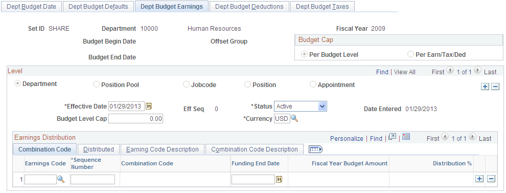

Use the Dept Budget Earnings (department budget earnings) page (DEPT_BUDGET_ERN) to establish department budgets for employee earnings in each department of your organization.
Navigation:
This example illustrates the fields and controls on the Dept Budget Earnings page.
Field or Control |
Description |
Budget Level Cap and Currency |
Enter the budget level cap that you want to place on this budget level. The cap is used to ensure that the sum of all lower-level budgets doesn't exceed this higher-level budget cap. It isn't used for checking funds during the processing of encumbrances and actuals. Also select a currency code. |
Earnings Distribution
Use this grid to establish multiple funding sources and (optionally) specify a Funding End Date for each source. Funding sources are defined using a combination code that represents a valid General Ledger ChartField combination.
Establish one entry for each budget level in which the earnings code is blank. This entry is the default funding source and is used as the funding for all earnings where a specific entry for an earnings code hasn't been established.
Field or Control |
Description |
Earnings Code |
Select an earnings code to establish a budget for particular earnings type. Establish budgets for as many different types of earnings as needed. |
% Effort (percentage of effort) |
Represents a university's estimate of activity attributable to and associated with a specific grant (or funding source) for the defined begin and end-dates. This field was designed for those higher education customers who need to track a "percentage of effort" as defined in the OMB A-21 regulations. |
Select a group of fringe expenses to exclude from funding from the earnings combination code. If you leave this field blank, the system funds all fringe costs from the combination code. This field is available only when the Default Funding Source Option is Actual or Earnings. |
Redirect Combination Code |
If you have specified a fringe group, you can select a combination code to fund the fringe expenses included in the selected group. Individual fringe costs within the fringe group that have a funding source specified on the Dept Budget Deductions or Dept Budget Taxes pages are funded by those sources, not this redirect combination code. The system does not override the account associated with this combination code even if the appropriate override is selected on the Dept Budget Data page. |

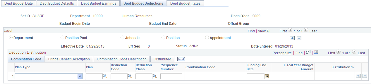

Use the Dept Budget Deductions (department budget deductions) page (DEPT_BUDGET_DED) to budget for employer-paid deductions in each department of your organization.
Navigation:
This example illustrates the fields and controls on the Dept Budget Deductions page.
Field or Control |
Description |
Deduction Budget Cap |
If you selected Per Earn/Tax/Ded as the Budget Cap value on the Dept Budget Date page, the system displays the Deduction Budget Cap field. Use this field to define budget caps individually for earnings, deductions, and taxes. Enter the deduction budget cap that you want to place on this budget level. The cap is used to ensure that the sum of all lower-level budgets doesn't exceed this higher-level budget. It isn't used for checking funds during the processing of encumbrances and actuals. |
Deduction Distribution
Establish multiple deduction-plan types and (optionally) specify a Funding End Date for each of those plans. Funding sources are defined using a combination code that represents a valid General Ledger ChartField combination.
Establish one entry for each budget level in which the deduction Plan Type, Plan, Ded Cd, and Ded Class are blank. This entry is the default funding source and is used as the funding for all deductions where a specific entry for a deduction type hasn't been established.
Field or Control |
Description |
Plan Type, Plan, Deduction Code,and Deduction Class |
Select a deduction plan type, plan, deduction code, and deduction class from the available options. |
Override |
Indicates if this funding source overrides the default funding source established on Dept Budget Earnings page. |
Note: If you make an entry in one of these fields (Plan, Deduction Code, or Deduction Class), you must enter all fields.

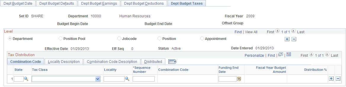

Use the Dept Budget Taxes (department budget taxes) page (DEPT_BUDGET_CTX) to budget for employer-paid taxes in each Canadian department of your organization.
Navigation:
This example illustrates the fields and controls on the Dept Budget Taxes page.
Field or Control |
Description |
Tax Budget Cap |
If you selected Per Earn/Tax/Ded as the Budget Cap value on the Dept Budget Data page, the system displays the Tax Budget Cap field. Use this field to define budget caps individually for earnings, deductions, and taxes. Enter the Tax Budget Cap that you want to place on this budget level. The cap is used to ensure that the sum of all lower-level budgets doesn't exceed this higher-level budget. It isn't used for checking funds during the processing of encumbrances and actuals. |
Tax Distribution
Establish multiple state or province taxes and tax classes and (optionally) specify a Funding End Date for each of those classes. Funding sources are defined using a combination code that represents a valid General Ledger ChartField combination.
Establish one entry for each budget level in which the deduction Tax Class, State or Province, and Locality (U.S. only) are blank. This entry is the default funding source and is used as the funding for all tax classes where a specific entry for a Tax Class hasn't been established.
Field or Control |
Description |
State or Province,Tax Class, and Locality |
Specify a budget for a particular type of tax. (For U.S. federal tax, enter $U. as the state) |
