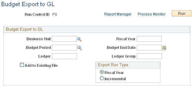

Use the Budget Export to GL page (RUNCTL_BUD014) to publish Human Resource department budget data to PeopleSoft Commitment Control budget ledgers.

This example illustrates the fields and controls on the Budget Export to GL page.

Business Unit |
Enter the business unit that corresponds to the department budget data you want to export. The export process exports budget data for all departments with the selected business unit using commitment accounting processing (as indicated on the Departments component). The relationships established during the TableSet Controls set up determine which departments are affiliated with a particular business unit. See Setting Up Business Units for General Ledger Integration. |
Fiscal Year |
Enter the fiscal year of the data you want to copy PeopleSoft General Ledger. |
Budget End Date |
Enter the budget end date of the budget you want to copy to PeopleSoft General Ledger. The Budget End Date and Fiscal Year work together to identify a particular set of budget data. |
Ledger |
Indicate which PeopleSoft General Ledger (GL) ledger to which you are sending the budget data. |
Ledger Group |
Indicate which GL ledger group the GL ledger is a part of. |
Add to Existing File |
Select this check box to add data to an output flat file previously created by this process. To replace the existing flat file with a new one, deselect this option. |
Export Run Type |
Select one of the following export run types: Fiscal Year: The system processes the entire budget for the specified fiscal year for all departments within the selected business unit. Incremental: The system processes the department budget data for all departments where data changes made online may have altered the department budget content. In most cases, these changes are to department and position data. |
Publish the budget data you processed using the Export Data to Budgets process. To do this, use the Batch Publish page in the Manage Integration Rules, Process menu.
Enter BUD014 in the Process Name field.
