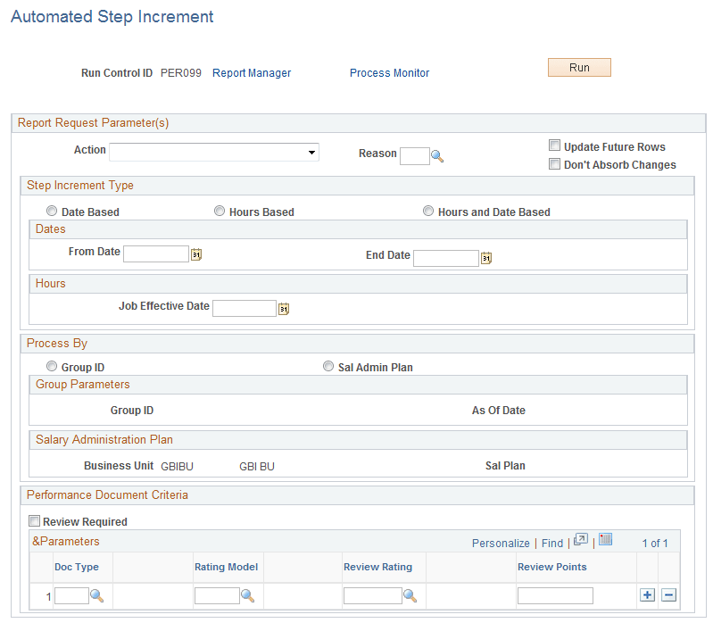

Use the Automated Step Increment page (RUNCTL_CMP007) to automatically move workers to the next salary step when they complete the required time in the current step.
Navigation:
(Classic)
(Fluid) Select the Workforce Administrator home page and click the Compensation Administration tile. On the left navigation, select
This example illustrates the fields and controls on the Automated Step Increment page.
Field or Control |
Description |
Action and Reason |
Enter the action and reason for the workers who are receiving a step increase. |
Update Future Rows |
When you select this option, the process updates all existing future effective-dated rows (rows that have an effective date that is later than the End Date) in addition to the effective-dated rows it is adding. |
Don't Absorb Changes |
Select to ensure that the salary premium of the processed workers does not absorb any salary changes even if the salary plan has an associated absorbing rate code. This option only applies to workers who have a target compensation rate and are assigned to a salary plan with the automatically calculated premium function enabled. |
From Date and End Date |
Enter the date range that you want to process. |
Job Effective Date |
If you use PeopleSoft Payroll for North America, enter the effective date of the new job. Otherwise, the system calculates this date as: (actual step entry date) + (months to next step increment). |
Process By
Field or Control |
Description |
Group ID |
Select to process by group ID. The Group ID field becomes available for you to select the group ID of the worker group that you want to process. |
Sal Admin Plan (salary administration plan) |
Select to process by salary administration plan. The Business Unit and fields become available for you to select the salary plan that you want to process. |
Performance Document Criteria
Field or Control |
Description |
Review Required |
Select this check box if a performance review is required. |
Doc Type (document type) |
Select a value for the performance review. |
Rating Model |
Select a value. These values come from the Rating Model table. |
Review Rating |
Review Points |
Enter the number of points associated with the performance review. |

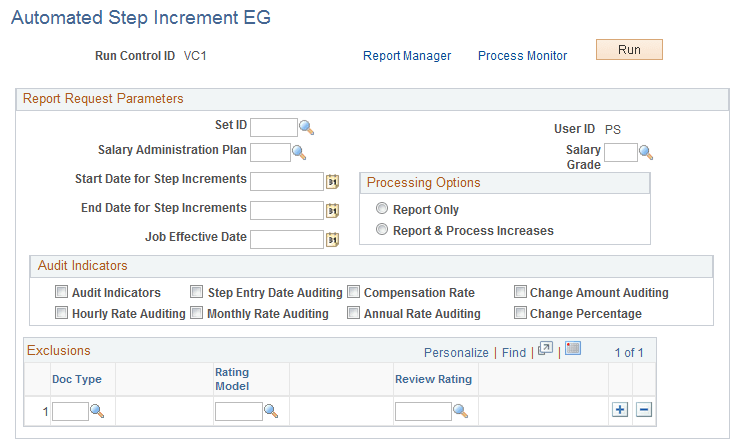

Use the Automated Step Increment EG page (RUNCTL_CMP107) to automatically move workers to the next salary step when they complete the required time in the current step.
Navigation:
This example illustrates the fields and controls on the Automated Step Increment EG page.
Field or Control |
Description |
Start Date for Step Increments and End Date for Step Increments |
Enter the start and end date of the period for which you want to process salary increases. Only workers who are in the specified salary plan during this time period are eligible for a step progression. |
Processing Options
Field or Control |
Description |
Report Only |
Select if you want a report of the step increases for this plan and grade within the time periods, but you do not want to process the increases at this time. |
Report & Process Increases |
Select if you want to process the increases and produce a report. |
Audit Indicators
Select the indicators that you want to include in audit information:
Audit Indicators
Step Entry Date
Compensation Rate
Change Amount
Hourly Rate
Monthly Rate
Annual Rate
Change Percentage
Based on your selections, the report records the items you selected for the employees and period for which you are processing salary increases. Audits identify errors that would occur when you trying to move workers to the next salary step when they complete the required time in the current step. If you review the report and notice any errors, make the appropriate corrections before you process an employee's step increase.
Exclusions
Field or Control |
Description |
Rating Model |
Review Rating |
