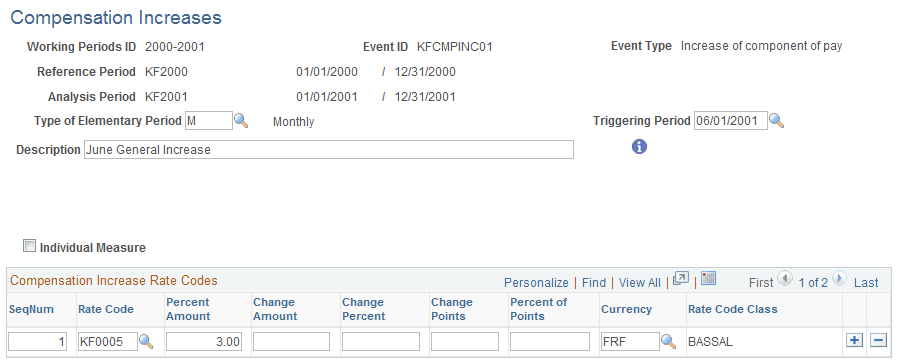

Simulate a compensation increase event.

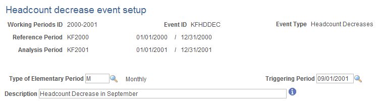

Simulate a headcount decrease.

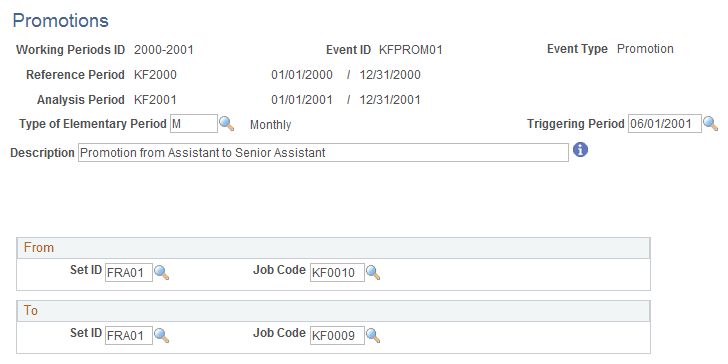

Simulate a promotion.
A promotion is defined as a move from one Job Code to another Job Code.

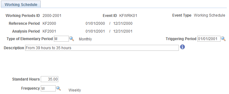

Define a working schedule.
A working schedules event determines the effect of changing the working schedule for a group of workers.

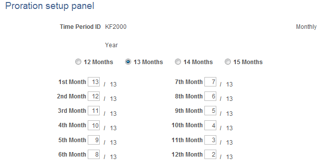

Define proration rules.

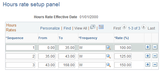

Define hours rates.

LMS_INCREASE |
Define a compensation increase event. |
LMS_LEAVES |
Define a headcount decrease event. |
LMS_PROMOTION |
Simulate promotions for all people in a group. |

LMS_WRK_SCHEDULE |
Define work weeks for the calculations. |
LMS_PRORATION |
Define the proration schemes. |
LMS_HOURS_RATE |
Define the overtime rates used for simulating the working schedules event. Use this page only for the Salary Forecasting calculation process. |

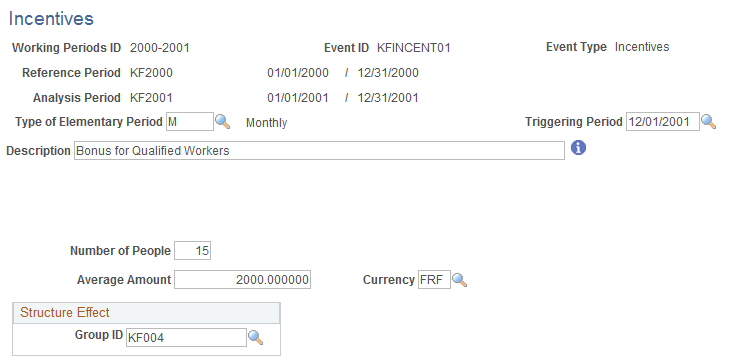

Use the Incentive event setup panel or Incentives page (LMS_INCENTIVES) to set up a future award for a group.
Navigation:
This example illustrates the fields and controls on the Incentives page.
Field or Control |
Description |
Number of People |
Enter the number of people who receive a lump sum incentive award. |
Average Amount |
Enter the average amount each person is to receive. For example, if you select 5 for the number of people and 500 for the average amount, the calculation adds 5 times 500.00 EUR, or 2500.00 EUR, to the triggering period. |
Structure Effect |
Enter the Group ID to receive this award. Refer to the Understanding Technical Details topic for information about the structure effect. |
Use the Salary Increase event setup or Compensation Increases page (LMS_INCREASE) to define a compensation increase event.
Navigation:
This example illustrates the fields and controls on the Compensation Increases page.
Field or Control |
Description |
Individual Measure |
Select if the increase is an individual measure. This check box relates to La Masse Salariale method of analysis. It classifies compensation increases into three categories: general increases (applies to the overall simulated population); increases by category (a category being a subset of the overall simulated population); and individual measure (the compensation increase is an increase for an individual). To simulate general increases, deselect this check box. |
Compensation Increase Rate Codes |
Define the rate codes to be increased. All people in a group with a compensation package containing specified compensation rate codes receive the increase that is specified on this page as of the triggering period of this event. Select the way to change a person's compensation for a given rate code from these choices: Percent Amount, Change Amount, Change Percent, Change Points, Percent of Points, Currency, and Rate Code Class. Specify any components of pay and any increases. Depending on the component type, fill in the fields as follows. (Fields not related to certain component types are unavailable for selection.) If the component type is flat amount or hourly, enter either a Percent Amount or a Change Amount. If the component type is percentage, enter only a Change Percent. If the component type is points, enter either a Percent of Points or a Change Points. |
Use the Headcount decrease event setup or Headcount Decreases page (LMS_LEAVES) to define a headcount decrease event.
Navigation:
This example illustrates the fields and controls on the Headcount decrease event setup page.
Field or Control |
Description |
Description |
Enter a description of the headcount decrease event. Specify the group to which this event applies on the Scenario Definition page. For example, if five workers retire as of the date specified by the triggering period, create a group that includes those five workers. At the scenario level, attach this group to the headcount decrease event. |
Use the Promotion event setup panel or Promotions page (LMS_PROMOTION) to simulate promotions for all people in a group.
Navigation:
This example illustrates the fields and controls on the Promotions page.
Field or Control |
Description |
From |
Enter values in the SetID and Job Code fields for a group's current position. |
To |
Enter values in the SetID and Job Code fields for a group's promoted position. |
Use the Working Schedule page (LMS_WRK_SCHEDULE) to define work weeks for the calculations.
Navigation:
This example illustrates the fields and controls on the Working Schedule page.
Field or Control |
Description |
Standard Hours |
Enter the number of standard hours per frequency period. For example, 35 hours is standard hours for a weekly frequency. To simulate the effect of a group of people moving from 39 to 35 hours, enter the target frequency (35 hours a week) in this field. The group of people that will change its working schedule is defined at the scenario level. |
Frequency |
Enter the frequency of the standard hours that you select. |
Use the Proration setup panel page (LMS_PRORATION) to define the proration schemes.
Navigation:
This example illustrates the fields and controls on the Proration setup panel page.
Field or Control |
Description |
Time Period ID |
The system displays the Time Period ID that you entered. |
Period Type |
The system displays a period type of either Monthly or Semi-Monthly. |
Type of Elementary Period |
Depending on the combination of period type and type of elementary period that you selected, the system displays fields that enable you to rate how to pay per elementary period. |
12 Months |
Select to weigh each month equally. |
13 Months |
Select to weigh one month out of a year twice. |
14 Months |
Select to weigh one month out of a year three times. |
15 Months |
Select to weigh one month out of a year four times. The system calculates all the ratios, but you can modify them. For instance, if you select 13 Months, you could weight December twice (default calculation) or half-weight June and December. In this case, you would overwrite the default ratios. |
Use the Hours rate setup panel page (LMS_HOURS_RATE) to define the overtime rates used for simulating the working schedules event.
Navigation:
This example illustrates the fields and controls on the Hours rate setup panel page.
Field or Control |
Description |
Hours Rate Effective Date |
Enter the date these rates are effective. |
Sequence |
These numbers represent the sequence of counting hours. They are automatically generated. |
From and To |
Enter the first and last number in the range of hours. The first sequence must begin with 0. |
Frequency |
Enter the valid frequency for this range of hours. |
Rate (%) |
Enter the percentage rate for each sequence. |
