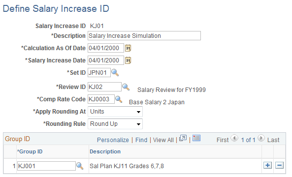

SALINC_ID_TBL_JPN |
Define a salary increase ID and associate a rate code, which must be of class DFRPAY and of type Flat Amount, and worker groups with it. You run the salary increase simulation by salary increase ID. |

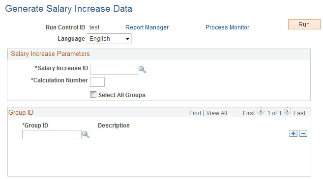

RUN_CMPCALC_JPN |
Enter the parameters for running the salary increase process and populating the Salary Increase Simulation table. |

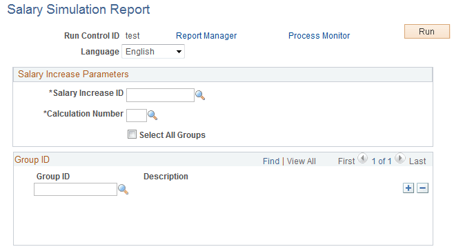

RUN_SALREPORT_JPN |
Run the Salary Simulation report (CMP020JP) that displays the results of the Salary Increase Simulation process. |

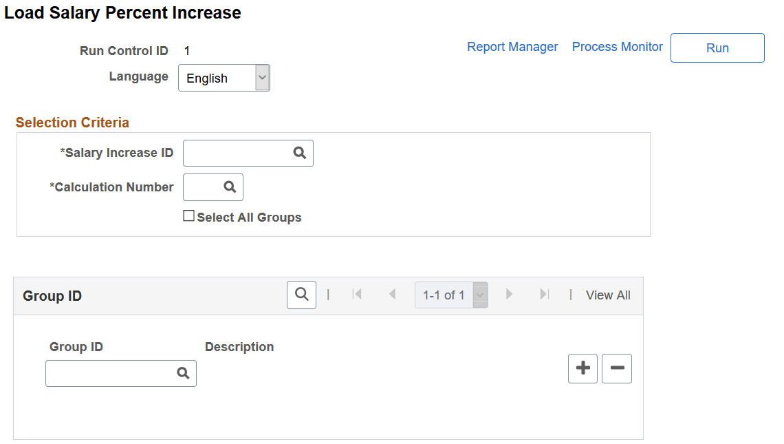

RUN_UP_SALINC_JPN |
Update worker job compensation records with the results of the salary increase and adjustment results. |

Use the Define Salary Increase ID page (SALINC_ID_TBL_JPN) to define a salary increase ID and associate a rate code, which must be of class DFRPAY and of type Flat Amount, and worker groups with it.
Navigation:
This example illustrates the fields and controls on the Define Salary Increase ID page.
Field or Control |
Description |
Calculation As Of Date |
Enter the effective date that the system uses to determine from which job compensation record it should get the worker's current data to calculate new data. For example, if the worker's review band earns a worker a 6 percent increase, the system must get the existing rate code amount to calculate the new rate code amount. |
Salary Increase Date |
Enter the effective date of the new job record that the system inserts for the worker for the review-based increased amount. The action and reason are Pay Rate Change and Salary Increase by Percentage. |
Comp Rate Code (compensation rate code) |
Enter the rate code. It must be of the class Defined Range Pay (DFRPAY) and of the type Flat Amount. You can add only one compensation rate code for each salary increase ID, and only one salary increase ID is associated with each simulation run. To run a simulation for a different compensation rate code, you must define additional salary increase IDs. Note: You cannot have more than one rate code of class DFRPAY on a single worker's Job Data - Compensation record. The process that populates the Salary Increase Simulation table includes all workers in the groups that you specify who have this compensation rate code as well as the currency code and frequency set in the Compensation Rate Code table for this rate code. If you have changed the default currency code or frequency from that set on the compensation rate table in the workers' job compensation record, then those workers go into error and are not included in the simulation. |
Apply Rounding At |
Select the numerical "place" at which to apply the rounding rule you select. |
Rounding Rule |
Select the rounding rule for the simulation process based on this salary increase ID. Options are:
Group ID |
Enter the group IDs for the workers being included in this process. You must enter at least one group ID to complete this process. If a worker in a group that you specify does not have the compensation rate code that you specified for processing, the system skips the worker without processing. |
Note: This salary update method retrieves the required percentage increase from the salary matrix table where you linked review bands to percentage increases, quartile by quartile.
Use the Generate Salary Increase Data page (RUN_CMPCALC_JPN) to enter the parameters for running the salary increase process and populating the Salary Increase Simulation table.
Navigation:
This example illustrates the fields and controls on the Generate Salary Increase Data page.
Field or Control |
Description |
Salary Increase ID |
Enter the salary increase ID for which to run the simulation. |
Calculation Number |
Enter the number that identifies a particular simulation in a series that you might run for comparison purposes. |
Select All Groups |
Select to have the system populate the Group ID group box with all groups that you originally associated with this salary increase ID. |
Group ID |
If you do not want to run the simulation for all the groups that you associated with this salary increase ID, deselect the Select All Groups check box and enter only those groups to process. |
Note: This process includes only workers with the single compensation rate code that is associated with the salary increase ID, but only if their currency code and frequency are the same as the compensation rate code default.
If you try to run a simulation with a combination of salary increase ID, calculation number, and group ID for which results exist, you get a warning. If you proceed, the results of the previous simulation are overwritten. To add groups to or remove them from an existing simulation and maintain the results of the previous simulation, change the calculation number.

Use the Salary Simulation Report page (RUN_SALREPORT_JPN) to run the Salary Simulation report (CMP020JP) that displays the results of the Salary Increase Simulation process.
Navigation:
This example illustrates the fields and controls on the Salary Simulation Report page.
Field or Control |
Description |
Enter the salary increase ID you ran the simulation for and for which you want the results reported. |
Enter the calculation number of the particular simulation you want reported. |
Select All Groups |
Select this check box if you want the system to populate the Group ID section with all the groups you originally associated with the Salary Increase ID. |
Group ID |
If you do not want to run the simulation for all the groups that you associated with this salary increase ID for this calculation number, deselect the Select All Groups check box and enter only groups that you want to process. |
Use the Load Salary Percent Increase page (RUN_UP_SALINC_JPN) to update worker job compensation records with the results of the salary increase and adjustment results.
Navigation:
This example illustrates the fields and controls on the Load Salary Percent Increase page.
Field or Control |
Description |
Enter the salary increase ID for which you ran the simulation and for which the results are to be loaded to worker job compensation records. |
Enter the calculation number of the particular simulation results to be loaded. |
Select All Groups |
Select to have the system populate the Group ID section with all the groups that you originally associated with this salary increase ID and calculation number combination. |
Group ID |
If you do not want to run the simulation for all the groups that you associated with this salary increase ID for this calculation number, deselect the Select All Groups check box and enter only groups that you want processed. |
