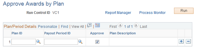

Use the Approve Awards by Plan page (VC_RUNCTL_APPWRD_P) to run the batch approval process (VC_APP_WRD_P) when the plan member rule is Ad Hoc Awards or Empl VC Record.
The process is also used to remove approved status from approved awards.
Navigation:
This example illustrates the fields and controls on the Approve Awards by Plan page.
Field or Control |
Description |
Plan ID |
The only available values are the VC plans for which this user ID is the designated approver on the Plan Business Rules page. |
Approve |
Select to approve all awards that have the Recommended status under the plan for the corresponding payout period. Deselect this field to remove approval if you already ran the approval process and now want to change it. The system selects Approve by default. |

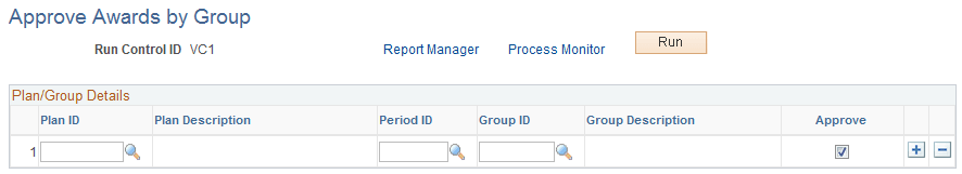

Use the Approve Awards by Group page (VC_RUNCTL_APPWRD_G) to run the batch approval process (VC_APP_WRD_G) when the plan member rule is Empl VC Record with groups or Define Tree/Group.
Navigation:
This example illustrates the fields and controls on the Approve Awards by Group page.
This page is identical to the Approve Awards by Plan page with the addition of the Group ID field.
Field or Control |
Description |
Plan ID |
The only available values are the VC plans for which this user ID has security access. |
