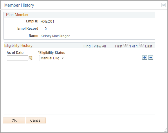

Use the Member History page (VC_PLAN_MEM_SEC) to view or correct historical plan member eligibility data.
Navigation:
Click the Allocate Compensation button to the left of the plan member's data row on the Eligible Employees by Plan page or Eligible Employees by Group page.
This example illustrates the fields and controls on the Member History page.
The system displays the plan member's identification information from the corresponding data row in the Eligible Employees by Plan page or Eligible Employees by Group page.
Eligibility History
Field or Control |
Description |
As of Date |
The date as of which the eligibility status changed. Change the as of date only if the Eligibility status is a manual status and you are in Correct History mode. The as of date that you enter must be between the plan's payout period begin date and evaluation as of date at the top of the Eligible Employees by Plan page or Eligible Employees by Group page. |
Eligibility Status |
You must be in Correct History mode to change the Eligibility status. You can change an automatic status to a manual status, but you cannot change manual to automatic. You can change Man Elig to Man Inelig or Man Inelig to Man Elig. You would change the status only to correct the historical information. |
Note: The system does not maintain historical data for Ad Hoc plans.

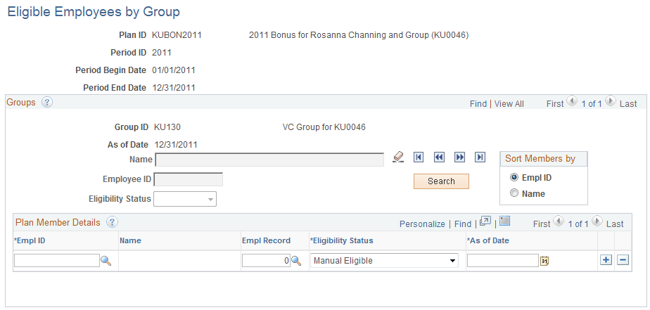

Use the Eligible Employees by Group page (VC_PLAN_MEM_WG_TBL) to view and adjust member eligibility if the plan uses groups.
Navigation:
This example illustrates the fields and controls on the Eligible Employees by Group page.
The fields on this page are identical to the fields on the Eligible Employees by Plan page with this additional field:
Field or Control |
Description |
Group ID |
The group ID and the group description for the active group appears. Use the previous and next buttons to select a different group. |
For plans that specify Employee Variable Compensation Record (without groups) as the plan member rule, update plan member information using the Individual's Payout page or the Eligible Employees by Plan page.
See Setting Up Members with Employee Variable Compensation Records.
