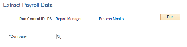

Use the Extract Payroll Data page (HR_WP_NA_PY_EXTRCT) to run the Extract Payroll Data process.
Navigation:
This example illustrates the Extract Payroll Data page.
Select the company whose payroll data you want to extract.
