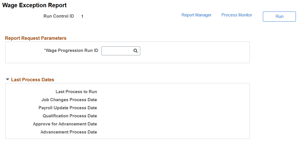

RUN_WP002 |
Run the exceptions report (WP002). It lists all employees within a Wage Progression Run ID group that have unacknowledged exceptions and indicates the exception type. |

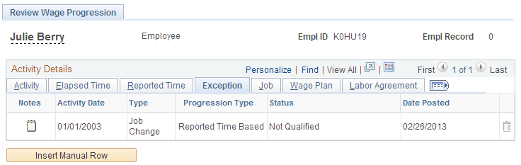

Process Exceptions
All Update Wage Progression processes identify circumstances that fall outside the basic wage progression definition and flags the workers' Review Wage Progression records with an exception condition. The system will not process for advancement workers with a row in an exception state but all other wage progression processes will continue.
During any of the Update Wage Progression processes, the system will mark a worker for exception when it encounters an exception condition. The system inserts a red alert icon (!) on the worker's Review Wage Progression page. Additionally, you can generate a list of workers with exceptions using the Wage Progression Exception report. The table below lists the various exceptions, what triggered the exception, and the action you might take before acknowledging the exception.
Exception Condition |
What it Means |
Action Required |
Job Data Correction |
A user has made a correction to a Job Data row, effecting job data that impacts wage progression. |
Review the worker's Job Data record and make modifications to the job data record or the worker's wage progression record, if necessary. |
Manual Step Advance |
A user has manually changed a worker's grade step level on the Job Data - Salary Plan page. |
Review the change for accuracy. |
Exceeded Leave Hours |
The worker's leave hours have exceeded the leave limit prior to meeting the elapsed time required for step advancement. |
Review the worker's wage progression record and modify the Orig Step Entry Date value if appropriate. |
Exceeded Time Limit |
The worker has worked the required number of hours in the required calendar period. |
Review the worker's wage progression record and modify the Orig Step Entry Date or Hours Worked value if appropriate. |
Approved but Stop Wage Progression |
A user has selected one of the Stop Wage Progression check boxes of a worker who was approved for advancement. |
Review the worker's Job Data record and wage progression record and make modifications to the job data record or the worker's wage progression record, if necessary. |
Released Stop Wage Progression |
A user has cleared one of the Stop Wage Progression check boxes. |
Two Earnings Periods |
The Update Activity with Time Data process includes time from two or more earnings periods. |
Special Accumulator ID Changed |
A user has changed the wage progression rule's accumulator ID on the Salary Plan Table – Define Wage Progression Rule page. |
Review the worker's wage progression record and modify if appropriate. |
New Time < Old Time |
The Update Activity with Time Data process has caused the worker's new Hours Worked total to be less than the previous Hours Worked value. |

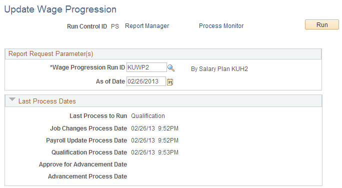

Use the Update Wage Progression page (RUN_UPD_WP_ACTVTY) to update a worker's wage progression activity record. Run the following wage progression processes in sequence:
Update Activity with Job Data process.
Update Activity with Time Data process.
Qualify Employees process.
Navigation:
This example illustrates the Update Wage Progression page.
You must run the three update process one at a time, in this order:
Update Activity with Job Data process (HR_WP_UPD_JC)
Update Activity with Time Data process (HR_WP_UPD_PY0)
Qualify Employees process (HR_WP_UPD_QL)
Field or Control |
Description |
Wage Progression Run ID |
Select the run ID representing the information group on which you want to collect activity data. |
As of Date |
Select the date as of which you want to incorporate changes to the Job Data pages or qualify an Elapsed Rule based worker for advancement. |
Last Process Dates |
There are five wage progression programs. This group box lists the last time each of the processes were run and which process was run most recently. |

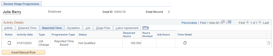

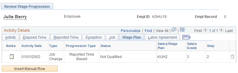

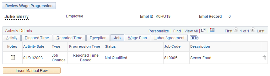

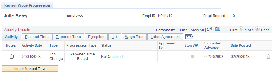

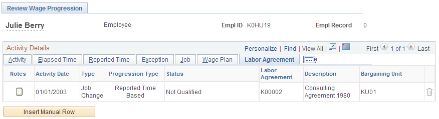

Use the Review Wage Progression page (HR_WP_MAINT_HIST) to review a worker's wage progression activity rows and add new rows to make manual adjustments to the activity record.
Navigation:
This is the first of seven examples illustrating the Review Wage Progression page.
This is the second of seven examples illustrating the Review Wage Progression page.
This is the third of seven examples illustrating the Review Wage Progression page.
This is the fourth of seven examples illustrating the Review Wage Progression page.
This is the fifth of seven examples illustrating the Review Wage Progression page.
This is the sixth of seven examples illustrating the Review Wage Progression page.
This is the seventh of seven examples illustrating the Review Wage Progression page.
Static Columns
These columns appear on each tab.

Activity
Field or Control |
Description |
Approved By |
Stop WP (stop wage progression) |
Select this check box here or on the Job Labor page to suspend a worker's participation in the wage progression process. When you select this check box here the system inserts a new Job Data row and selects the Stop Wage Progression check box on the Job Data - Job Labor page. When you select the Stop Wage Progression on the Job Labor page, the system updates the wage progression activity when you next run the Update Activity with Job Data process. When you select the check box, the system:
The system also selects this check box when a worker completes the wage progression. |
Estimated Advance |
Displays the system-calculated estimated date the worker will be eligible to advance based on the wage progression rule of their salary plan. For rules based on hours worked, the system bases this calculation on the standard hours on the worker's Job Data record. The date will always be the first day of the next pay period after the worker qualifies. This is only an estimate since various other factors could impact the actual advancement date. |
Date Posted |
Displays the system date the row was generated or created. |

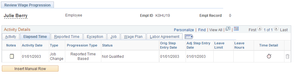

Elapsed Time
These fields are applicable for elapsed time-based wage progression rules only.
Field or Control |
Description |
Orig Step Entry Date (original step entry date) |
Displays the date the worker originally entered their current salary step. The system draws this value from the Step Entry Date field on the Job Data - Salary Plan page. |
Adj Step Entry Date (adjusted step entry date) |
Manually adjust the step entry date here to maintain wage progression accuracy. |
Leave Limit |
(Optional) Displays the maximum number of leave hours a worker can accumulate while in the step, as defined in the salary plan's progression rule. |
Leave Hours |
(Optional) Displays the leave hours the worker has accumulated since the original step entry date. The Update Activity with Time Data process updates this value. |

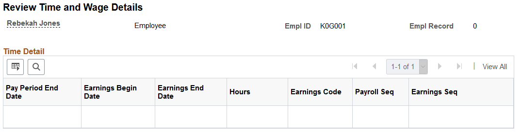

Time Detail |
(Optional) Click to view the Review Time Details page. |
Reported Time
These fields are applicable for hours-based wage progression rules only.
Field or Control |
Description |
Required Hours |
Displays the number of hours the worker needs to accumulate to advance to the next grade step defined in the salary plan's progression rule. |
Hours Worked |
Displays the qualifying hours the worker has worked since the original step entry date. The Update Activity with Time Data process updates this value and also adds in any adjusted hours from a previous manual row. |
Adj Hours (adjusted hours) |
Manually enter hours here to establish a new total for hours worked. Adjust the hours as necessary to maintain wage progression accuracy. The next Update Wage Progression with Time Data will incorporate manual adjustments. The system uses this adjusted value to qualify if the worker is ready to progress to the next step by comparing it to the Required Hours. |
Time Detail |
Exception
Field or Control |
Description |
Exception Detail |
These columns only appear if there is a row with an exception. Click to view the details about the worker's exception from advancement. |
Acknowledge Exception |
Select to indicate that you acknowledge the exception message and return the worker to advancement eligibility. |
Job
Field or Control |
Description |
Job Code and Description |
Displays the job code and a description of the worker's job. |
Wage Plan
Field or Control |
Description |
Salary/Wage Plan, Salary Grade and Step |
Displays the wage progression salary plan, grade, and step currently held by the worker. |
Labor Agreement
Field or Control |
Description |
Labor Agreement . Description , and Bargaining Unit |
Displays the worker's labor agreement and bargaining unit. |
Use the Review Time and Wage Details page (HR_WP_EARN_INQUIRY) to review earning period details, such as leave and worked hours, per pay period for employees.
Navigation:
Click the Time Detail button on the Review Wage Progression - Elapsed Time tab (leave hours) and Review Wage Progression - Reported Time tab (hours worked) on the Review Wage Progression page.
This example illustrates the Review Time and Wage Details page.
Note: The data populated on this page depends on the source of the data and process by which you populate this page. The Extract Payroll Data process populates the page with Payroll for North America pay period and earning period time data for the special accumulator identified in the worker's wage progression rule.
Use the Exception Messages page (HR_WP_MSG_SEC) to review system messages about why a worker was excepted from advancement and to acknowledge the exception to resume wage advancement eligibility.
Navigation:
Click the Exception Detail button on the Review Wage Progression - Exception tab of the Review Wage Progression page.
When a worker's wage progression conditions warrant manual review and a possible manual adjustment, the Update Wage Progression process will flag their Review Wage Progression record. When a worker is excepted, you cannot advance the person until you have acknowledged the exception by selecting the Acknowledge Exception check box on the Review Wage Progression - Exception tab. However, the system will continue to update the worker's Review Wage Progression record when you run the Update Activity with Job Data and the Update Activity with Time Data processes.
When you select the Acknowledge Exception check box and save the Review Wage Progression page, the system updates the Acknowledged By and Acknowledged On fields with your user ID and the date and time you acknowledged the exception. Click the Notepad button to enter comments. You should add a note of explanation for all exception acknowledgements.
Use the Wage Exception Report page (RUN_WP002) to run the exceptions report (WP002).
This report lists all employees within a Wage Progression Run ID group that have unacknowledged exceptions and indicates the exception type.
Navigation:
This example illustrates the Wage Exception Report page.
