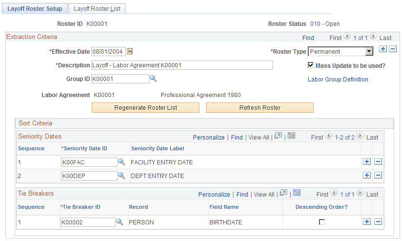

Use the Layoff Roster Setup page (HR_LAYOFF_SETUP) to define the layoff roster parameters.
Navigation:
This example illustrates the Layoff Roster Setup page.
You can enter any number of effective-dated rows into a roster, but only one row per calendar day. When you insert a new row, the system makes the previous rows unavailable for entry.
You can create future-dated rosters and insert future-dated rows into a roster. You can generate and maintain future-dated rosters, but you cannot process the layoff.

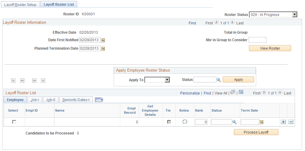

Use the Layoff Roster List page (HR_LAYOFF_CAND_LST) to manage the layoff roster.
Navigation:
This example illustrates the Layoff Roster List page.
Note: The system will not include as candidates those workers who are identified as being exempt from layoff on the Job Labor page.

Adding Candidates Manually
You can manually add candidates to the roster (for example, workers who were bumped from their position). To add a candidate manually, add a row and select an EmplID and employee record number. Click the Man Emp (Manual Employee) button to retrieve the person's job details. When the person's details have been retrieved the button becomes display only. The system assigns all manually-added candidates the permanent rank of zero.
The system updates the Nbr in Group to Consider and Total in Group values to reflect the additional candidates.
Note: You can remove candidates who were manually added to the roster.

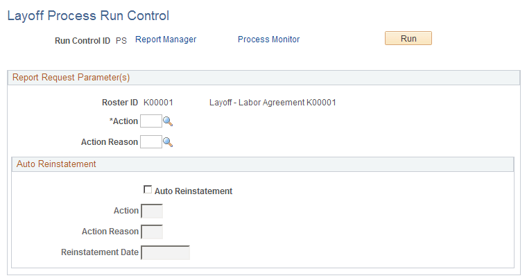

Use the Layoff Process Run Control page (HR_RUNCTL_LAY) to process layoffs.
Navigation:
Click the Process Layoff button on the Layoff Roster List page.
This example illustrates the Layoff Process Run Control page.
The layoff process:
Inserts a new row in the Job Data pages with the effective date of the layoff.
The system copies all of the data from the previous Job Data row to the new row and includes the Action and Action Reason values you select here. If the system is unable to enter a job row for an employee due to an error on their job record a message will be entered for that employee number in the log.
Inserts a new row into the Recall Rights page with the effective date of the layoff.
The system enters the value of Layoff in the Reason field.
The system calculates the Expiration Date using the recall expiration rule attached to the labor agreement being processed.
The system will not insert a record into the Recall Rights page:
If you select the Auto Reinstatement check box on the Layoff Process Run Control page.
If the candidate does not have a value for the seniority date used by the recall expiration rule to calculate recall rights.
If the Recall Expiration rule attached to the Labor Agreement is a No Recall rule.
Updates the status of the processed candidates in the layoff roster with an event complete status.
Note: If the system encounters any errors when processing a candidate's layoff, the system will skip the person and enter a note into the process logged. The Layoff process includes the candidate on post processing reports, but their job data information is blank.
