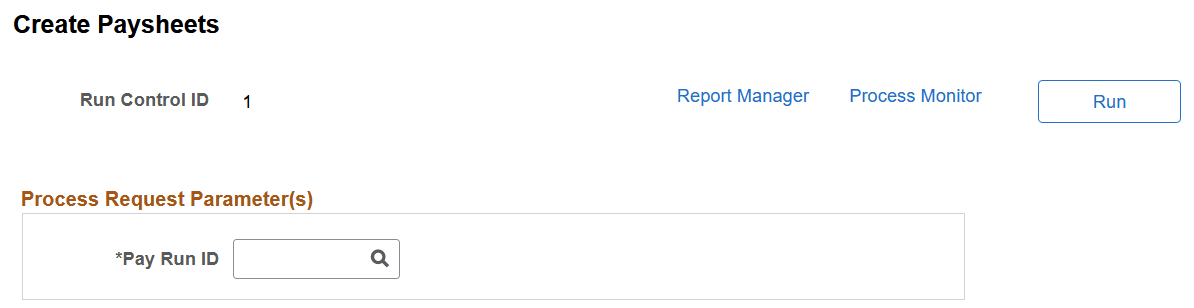

To indicate for whom you want to create paysheets, specify a pay run ID on the Create Paysheets page. This pay run ID groups together pay calendar entries from different pay groups for payroll processing.
When you set up the payroll process tables, you assigned a pay run ID to each pay calendar entry. At this point, you already know how to organize the payroll cycles, and whether to run paysheets for multiple pay groups and companies at the same time by combining them under the same pay run ID.
All pay calendar entries that share a pay run ID generally have the same pay period end date, but not necessarily the same pay frequency. In most cases, you set up a different pay run ID for each pay period end date on the Pay Calendar Table page.
Use the Create Paysheets page (RUNCTL_PAYSHEET) to specify a pay run ID and create a paysheet. Also, use to confirm a pay run that processed paysheets loaded with variable compensation data.

This example illustrates the fields and controls on the Create Paysheets page.

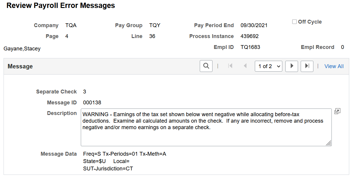

Use the Review Payroll Error Messages page (PAY_MESSAGES) to view payroll error messages that arise when creating paysheets.

This example illustrates the fields and controls on the Review Payroll Error Messages page.
Field or Control |
Description |
Page |
If the error is for a specific employee, this field displays the paysheet page number. |
Line |
If the error is for a specific employee, this field displays the paysheet payline number. |
Message
Field or Control |
Description |
Separate Check # (separate check number) |
This field appears if the error is for an employee and the error occurred on a separate check. |
Message ID |
The Management Information Systems department uses this to find and correct errors. |
Message Data |
If the error is associated with an object, such as an earnings code, this field displays the object ID. Note: The Payroll Error Messages report (PAY011) also lists errors related to employee data. |
