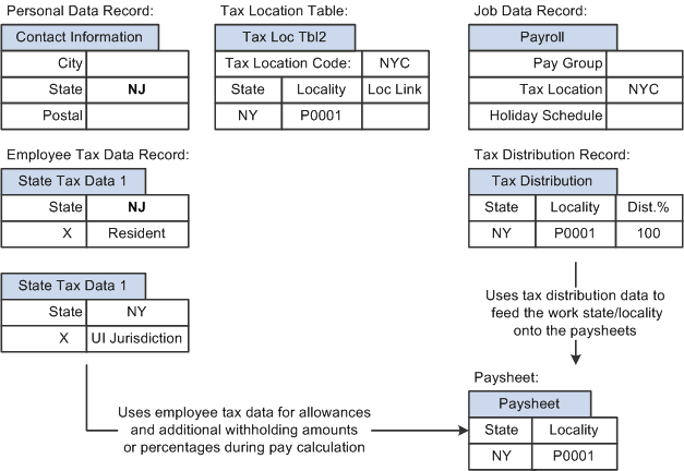

This diagram illustrates how the system enters tax data from the Personal Data Record, Tax Location Table, Job Data Record, Employee Tax Data Record, and the Tax Distribution Record automatically and how that data is used on paysheets:

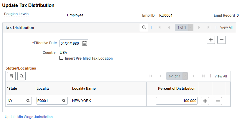

(USA, USF) Use the Update Tax Distribution page (TAX_DISTRIBUTION) to enter the employees work state or localities percentages for US employees.
This information will be used in the Create Paysheet Process and create a payline for each state/locality combination.

This example illustrates the fields and controls on the Update Tax Distribution page for the U.S.
Tax Distribution
Field or Control |
Description |
Insert Pre-filled Tax Location |
Select to automatically populate this record using the tax location ID specified on the employee's Job Data record and the corresponding information on the Tax Location Table. When a tax location code contains multiple states, and this check box is selected, the system:

Field or Control |
Description |
Percent of Distribution |
Specify the percent of the employee's time or earnings to apply to selected state/locality in the State and Locality fields. Note: This tax distribution is for work location taxes only and does not include resident-based taxes. Every employee must have at least one Tax Distribution record. State/locality percentages must total 100 percent. If the employee works in one state or locality, the distribution percent should be 100 for that row. However, if an employee is hired or transferred into a tax location that represents more than one state or locality, you must distribute taxes among the different states or localities. All the percentages must total 100. You cannot save the page until the distribution percent values total 100. Note: You can distribute taxes for salaried and exempt hourly employees only. If you select the Use Total Wages for Multi-State Employee check box on the Federal Tax Data 2 page, the system uses 100 percent of the employee's wages to determine the tax rate. |
Update Min Wage Jurisdiction (update minimum wage jurisdiction) |
Select to access the Update Minimum Wage Jurisdiction Page to modify or review the employee’s minimum wage jurisdiction setup.
This link appears if the pay group of the employee is enabled with
minimum wage jurisdiction.

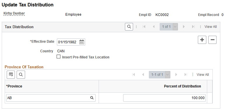

(CAN) Use the Update Tax Distribution page (TAX_DIST_CAN) to enter tax distribution information for Canadian employees.
Navigation:
This example illustrates the fields and controls on the Update Tax Distribution page for Canada.
Note: All fields on this page have the same functionality as the fields on Update Tax Distribution Page (TAX_DISTRIBUTION), the U.S. version except for the following fields.

Province |
Canada does not allow distribution to more than one province. Enter the province in which the employee works. |
For Canadian payroll, the distribution percent must be 100 for a single row. The default value is 100. |
