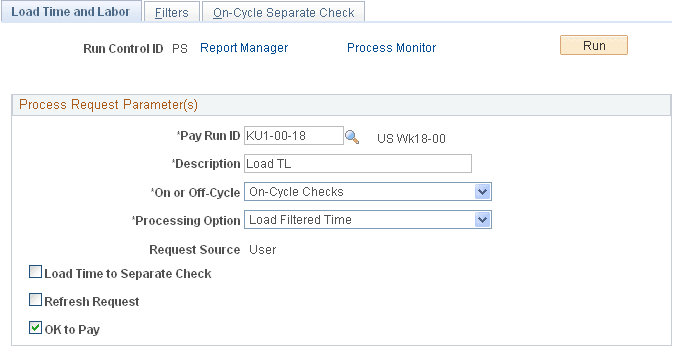

Use the Load Time and Labor page (PY_LDTL_RC) to select processing options then run the Load Time and Labor process to load payable time from Time and Labor into Payroll for North America paysheets for processing
Navigation:
This example illustrates the fields and controls on the Load Time and Labor page.
Field or Control |
Description |
Pay Run ID |
Select the pay run ID that identifies the pay calendars that you want to process. Each pay calendar identifies a company, pay group, and the start and end dates of the pay period. This selects employees that have been active any time during the pay period. |
Description |
Use this field to discriminate between multiple instances of loading time and labor data when using the Review Time and Labor Load - Load Time Labor page and Review Time and Labor Load - Off-Cycle Data page. |
On or Off-Cycle |
Values are: On-Cycle: Select to process a regularly scheduled pay run. Off-Cycle: Select to process a payroll outside the pay group's normal pay period schedule. |
Processing Options |
Select the processing option:
Note: (CAN) After loading prior period time from Time and Labor, you must select the EI Period Correction check box on the paysheet only for pay corrections, not for pay adjustments. |
Request Source |
This is a display-only field. It displays the source of the request: Pay Calc (pay calculation), Final Calc (final calculation), Online Check, or User. It indicates whether you or someone else generated the loading of time and labor data or if the system did it automatically through the Pay Calculation, final Pay Calculation, or Online Check process. |
Load Time to Separate Check |
Select to load all prior period time or filtered time to a separate check for all employees included in the selection criteria. This field is not available for off-cycle runs or if the on-cycle processing option is Load All Time. |
OK to Pay |
Select if you want all time and labor earnings to be marked as OK to Pay on the paysheet. If you do not select this check box, you must manually mark every paysheet as OK to Pay on the Paysheet page. |
Refresh Request |
Select to restart the selection process for all employees in the pay run. This should be used only when you must recover data if paysheets have been corrupted. This option should not be used on a normal rerun of the Load Time and Labor process, when more time is to be updated. A refresh request enables you to reselect all of the data that was passed in the original request, current and prior period adjustments, plus any new unclaimed payable time entries (where payable status is set to Estimate, Closed, Sent to Payroll, or Rejected by Payroll). |
Note: If you do not want to run labor distribution and dilution and do not select these options on the Pay System page in Time and Labor, then when the Load Time and Labor process runs to completion, it sets the payable status to Closed in Payable Time. When time is set to Closed, it can be published to PeopleSoft Projects as actuals.

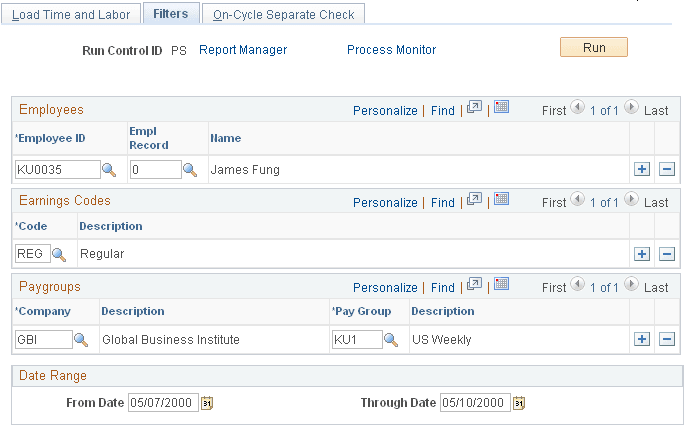

Use the Load Time and Labor -Filters page (PY_LDTLEMP_RC) to select employees, earnings codes, pay groups, or range of dates to load payable time from Time and Labor into Payroll for North America paysheets for processing.
Navigation:
This example illustrates the fields and controls on the Load Time and Labor - Filters page.
Note: This page is not visible if you select Load All Time in the Processing Option field on the Load Time and Labor page. It is visible for off-cycle runs only if you select Load Filtered Time in the Processing Option field on the Load Time and Labor page.
Field or Control |
Description |
Employees |
Enter the employee ID for the employees that you want to process. The employee must be in a company and pay group within the selected pay run ID. Paysheets are created only for employees who have available payable time. The employee record number value is set by default to 0 (zero). If the employee has multiple jobs within the company, and you want to load time and labor data for that employee for a particular job, enter the employee record number corresponding to that job. |
Earnings Codes |
Enter earnings codes to load data for a special payment, such as a bonus run. If no earnings codes are selected, the system assumes that you want to load data for all earnings codes. |
Paygroups |
Select pay groups if you want to restrict the load by company and pay group. If no pay groups are selected, the system assumes that you want to load data for all pay groups. |

Date Range |
Select dates to restrict the load to a date range. To load all time prior to a particular date, enter only an end date and leave the from date blank. If you enter a from date but leave the through date blank, the system enters the pay end date as the default through date. |

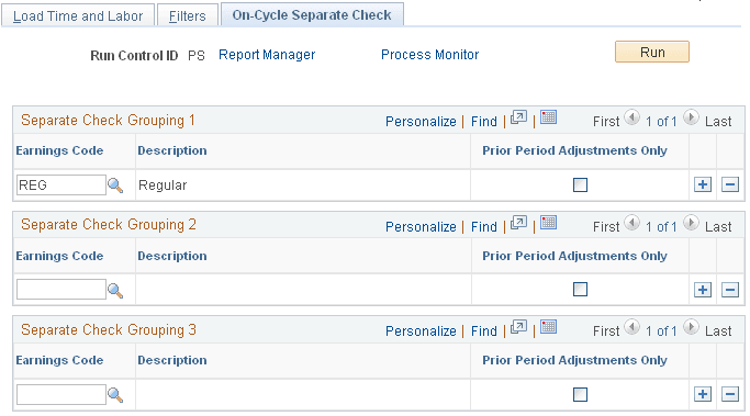

Use the On-Cycle Separate Check page (PY_LDTL_SEP_CHK_RC) to select up to three groupings of earnings codes for separate checks.
Navigation:
This example illustrates the fields and controls on the On-Cycle Separate Check page.
Note: This page is not visible for off-cycle pay runs or if Load to Separate Check is selected on the Load Time and Labor page.
You can select up to three sets of earnings codes to group onto separate checks.
Field or Control |
Description |
Earnings Code |
Select the group of earnings codes that you want to pay on each separate check. |
Prior Period Adjustments Only |
Select to load the selected earnings code to a separate check only for prior period time. This field is not available for data entry if you select the Load Prior Period Time processing option. Note: If you select the Load Prior Period Time processing option and want to load prior period time to separate checks, use the Load Time to Separate Check option on the Load Time and Labor page. |
