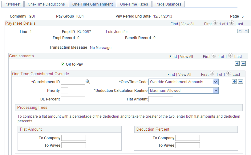

Use the By Paysheet - One-Time Garnishment page (PAY_SHEET_ADD_G) to enter a one-time garnishment to take in the current pay period only, override an existing garnishment, suspend an existing garnishment, and refund an existing garnishment.
Navigation:
This example illustrates the fields and controls on the By Paysheet - One-Time Garnishment page.
One-Time Garnishment Override
Field or Control |
Description |
Garnishment ID |
Select the Garnishment Specification Data record to override. |
Priority |
Enter the priority to override from the Garnishment Spec Data pages. |
Do Not Apply Exemption |
This check box is visible only if a garnishment tax levy has been defined for the employee on the Garnishment Spec Data pages. Use this check box when processing additional checks so that the exemption amount, which is automatically applied to regular checks, is not also applied to the additional checks. Selecting the check box prevents the system from applying the exemption amount to this check. When it is selected, the batch process does not calculate any exemption amount for the tax levy garnishment, and a message appears on the Garnishment Detail page to indicate that the exemption was overwritten on the payline for this check. |
One-Time Code |
Select from these values:
Note: If you override or refund this garnishment, the system uses all the calculation and processing fees fields on this page to calculate the garnishment, even if they are blank. For example, if you leave the fields in the Processing Fees fields blank, the system treats them as though you entered 0. |
Deduction Calculation Routine |
Select the deduction calculation routine for the one-time garnishment:
DE Percent (disposable earnings percent) |
Enter the percent of disposable earnings to use in the override calculation. |
Flat Amount |
Enter the flat amount to use in the override calculation. |
Processing Fees
Use this group box to override the normal processing fees. If the order requires you to withhold the greater of the percent of the garnishment amount or a flat amount, enter both; the system withholds the greater of the two.
