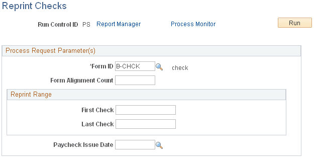

(USA, USF) Use the Reprint Checks page (RUNCTL_PAY_REPRINT) to set the check ranges and run the Check Reprint process.
(CAN) Use the Reprint Cheques page (RUNCTL_PAY_REPRINT) to set the check ranges and run the Cheque Reprint process.
Navigation:
This example illustrates the fields and controls on the Reprint Checks page.
Field or Control |
Description |
Form ID |
Enter the ID for the type of form that you want reprinted, in this case, select the appropriate form ID. |
Form Alignment Count |
Indicate how many checks you need for manually aligning the check forms in your printer. These check numbers are inserted into the Dead Paychecks file. |
Reprint Range |
Enter the first check number and the last check number in the reprint range of the checks you're reprinting. |
Paycheck Issue Date |
This should be the same as the date on the original check run. If you need to reprint checks for different dates, you must run the Check Reprint process separately for each different date. |
