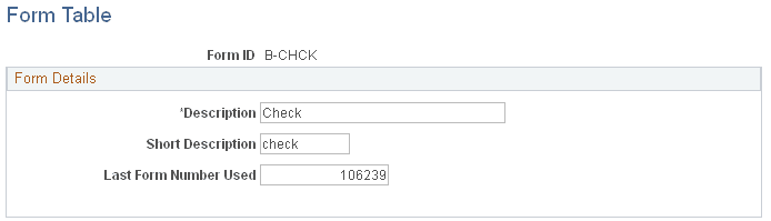

Use the Form Table page (PAY_FORM_TABLE) to specify the form IDs that you use to print checks and advices, and track form numbers.

This example illustrates the fields and controls on the Form Table page.

Form ID |
Create an entry on this table for each check or advice form that you use. You must set up separate form IDs for each account if you pay employees from one bank with multiple account numbers or from multiple banks with their associated account numbers. |
Last Form Number Used |
