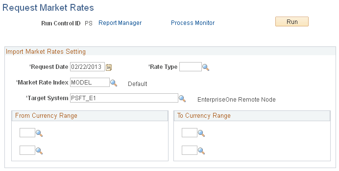

Use the Request Market Rates page (HIE1_MKT_RT_RNCTL) to query market exchange rates from the EnterpriseOne financials system.
Either schedule the request or enter an ad hoc request.

This example illustrates the fields and controls on the Request Market Rates page.
Field or Control |
Description |
Request Date |
Enter the current date. To accommodate requests scheduled through PeopleSoft Process Scheduler, the system always overrides the entered request date with the current system date. |
Rate Type |
Select the rate type under which the imported values are to be stored in the Enterprise table. Values are established on the Market Rate Data table (RT_TYPE_TBL). |
Market Rate Index |
Select the market rate index under which the imported values are to be stored in the Enterprise table. Values are established on the Market Rate Index table (RT_INDEX_TBL). The default value is MODEL. |
Target System |
Select the node that you established for the integration with EnterpriseOne. |
From Currency Range |
Define the alphabetical range of currencies from which you're requesting the exchange rate. For example, from GBP – RUR. For a single from currency, select the same currency in both fields. |
To Currency Range |
Define the alphabetical range of currencies to which you're requesting the exchange rate. For a single to currency, select the same currency in both fields. For example, to EUR – EUR. |
The system retrieves the market rate for each currency code pair that falls alphabetically in the from and to currency ranges that you specify.
