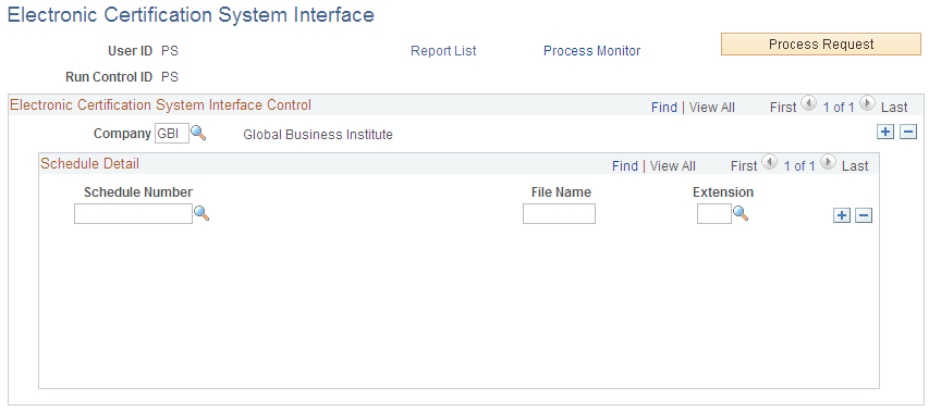

(USF) Use the Electronic Certification System Interface page (RUN_FGPY004) to create the ECS interface file for off-cycle disbursements.
Navigation:
This example illustrates the fields and controls on the Electronic Certification System Interface page.
The same Electronic Certification System Interface run control page is used for off-cycles and on-cycles. The output is determined by the ECS control schedule number.
Important! PeopleSoft ECS interface process has been replaced by the Treasury Interface functionality.
Field or Control |
Description |
Schedule Number |
Select all the ECS schedules that are currently available to be formatted for ECS transmission. Eligible schedules are those with a payment date, more than zero records, and an amount greater than zero. After you run this process, you can no longer modify the ECS control information for the selected schedules. |
File Name and Extension |
Enter the exact DOS file name and extension of the schedule from the ECS Extract Controls page on the Identify ECS Controls page. |
Select Process Request to run this request. PeopleSoft Process Scheduler runs the ECS Interface (electronic certification system interface) Structured Query Report (SQR) Report process (FGPY004) at user-defined intervals.
