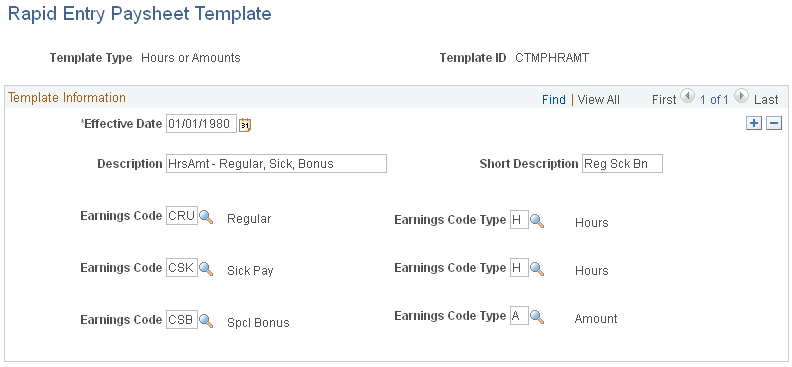

This example illustrates the fields and controls on the Rapid Entry Paysheet Template page.
You can define templates based on hours, amounts, or a combination of hours and amounts.
Note: You cannot change the template type after the template is created.
Field or Control |
Description |
Earnings Code |
Select the earnings codes that you want to preset for the template. Available earnings codes are determined by the template type. |
Earnings Code Type |
This field is only available if the template type is Hours or Amounts. Select an earnings code type for each earnings code that identifies whether hours or an amount will be entered on the rapid entry paysheet for the earnings. |
