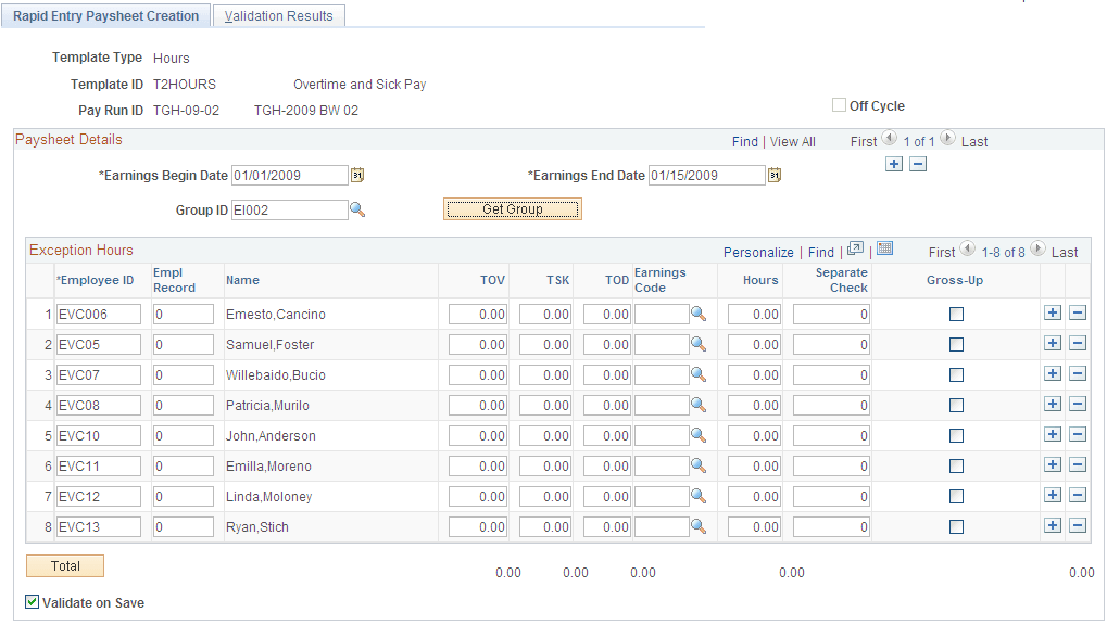

Use the Rapid Entry Paysheet Creation page (PYRE_AMT_ENTRY) to enter hours, amounts, or a combination of both for the earnings codes defined in a template.
Navigation:
This example illustrates the fields and controls on the Rapid Entry Paysheet Creation page.
The group boxes and fields appear on the page based on the template type you enter. Use the Hours or Amounts combination template type if you want to include earnings defined as Hours Only and earnings defined as Amounts Only in the same template.
Exception Hours
Field or Control |
Description |
Hours |
Enter the number of hours for the additional earnings code. |
Exception Amount
Field or Control |
Description |
[Various columns on the right of the Name column] |
Enter dollar amounts in the columns for earnings codes defined on the template. |
Earnings Amount |
Use this column to enter the appropriate dollar amount that is associated with the additional earnings code. |

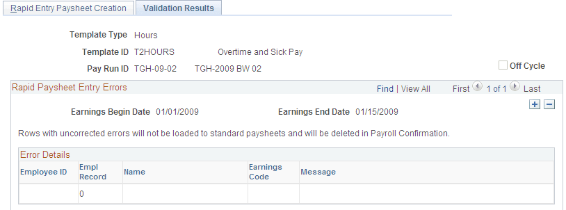

Use the Validation Results page (PYRE_INVALID) to view employee and earning code errors relating to rapid entry paysheets.
Navigation:
This example illustrates the fields and controls on the Validation Results page.
Use this page to identify errors to be corrected.
Note: If no errors are found, a No errors found in validation process message displays on this page.
You are automatically transferred to this page upon save if you have selected the Validate on Save check box on the Rapid Entry Paysheet Creation page (PYRE_AMT_ENTRY). If you do not select Validate on Save, the Load Paysheet Transaction process performs the validation. Invalid entries are not loaded and can be reviewed on the Validation Results (PYRE_INVALID) page.
