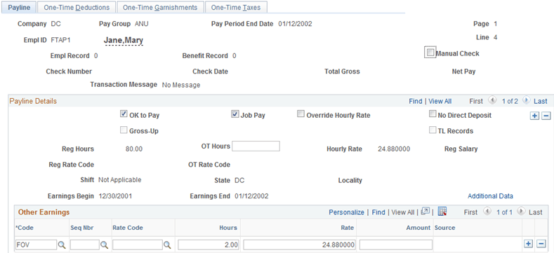

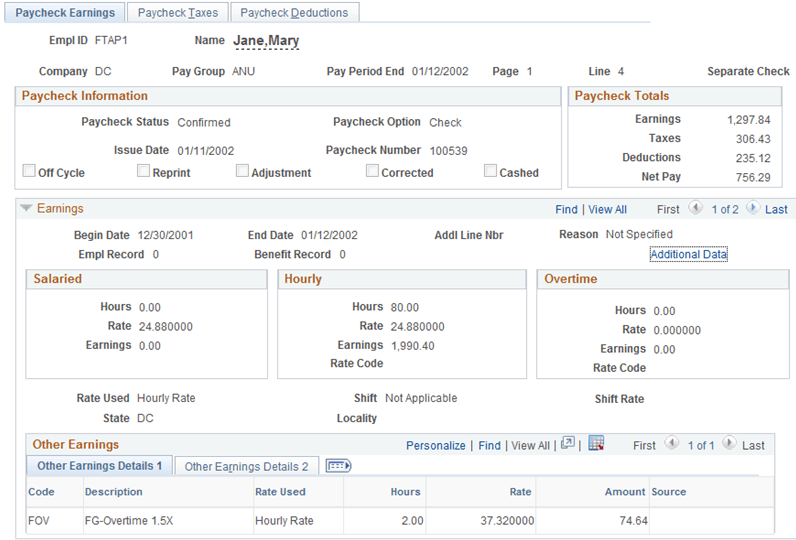

Addl Line Nbr 0 with 80 standard hours at the pre-offset hourly rate of $24.88, and 2 overtime hours based on the same hourly rate.

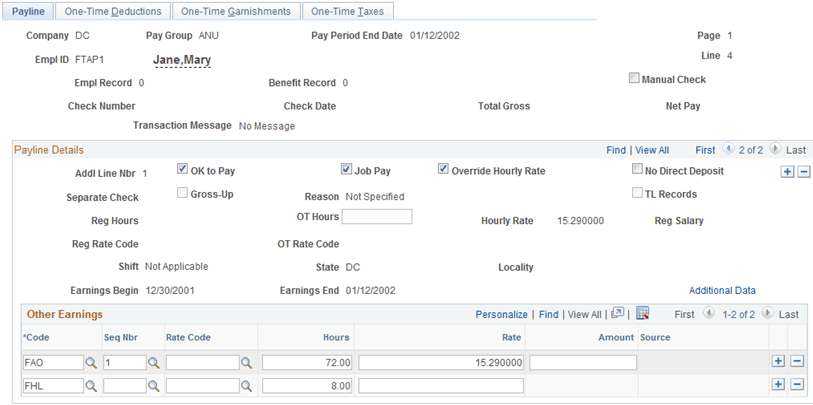

Addl Line Nbr 1 with an offset hourly rate of $15.29, earnings code FAO for 72 hours, and FHL (holiday) for 8 hours.
Payline details appear on the Update Paysheets, By Payline page.
Navigation:
This is an example of a Payline Page, annuitant Addl Line Nbr 0.
This is an example of a Payline Page, annuitant Addl Line Nbr 1.

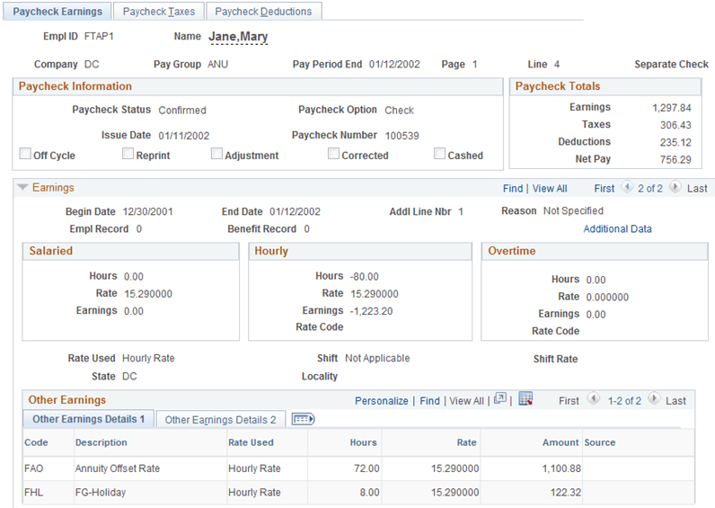

Annuitant Paycheck Earnings
The system calculates Mary’s paycheck earnings as shown in this table:
Earnings |
Hours |
Rate |
Dollars |
Paid |
Regular FPR |
80 |
24.88 |
1990.40 |
No |
Regular FAO |
(72) |
15.29 |
1100.88 |
Yes |
Regular FHL |
(8) |
15.29 |
122.32 |
Yes |
Total Regular |
80 |
15.29 |
1,223.20 |
Yes |

Paycheck earnings details appear on the Review Paycheck, Paycheck Earnings page.
Navigation:
Note: For additional line number 0, Addl Line Nbr field in the Earnings group box is blank.

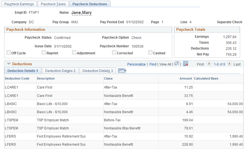

Annuitant Paycheck Deductions
Mary’s premium earnings and her retirement, TSP, and FEGLI contributions are calculated at her full job hourly rate of $24.88. Based on Mary’s earnings, her deductions are as follows:
Her before-tax TSP employer match is $199.04 (based on employee withholding of 10% of the special accumulator pre-offset earnings).
Her nontaxable TSP employer match is $79.61 (based on employer contribution).
Her after-tax retirement (FERS) is $15.92 (based on employee withholding of 0.8% of the special accumulator pre-offset earnings).
Her nontaxable retirement (FERS) is $228.90 (based on employer contribution of 11.5% of the special accumulator pre-offset earnings).
Her after tax FEGLI is $8.91.
Her nontaxable FEGLI is $4.46
Paycheck deduction details appear on the Review Paycheck, Paycheck Deductions page.
Navigation:
This is an example of a Paycheck Deductions page, showing annuitant retirement deductions.
