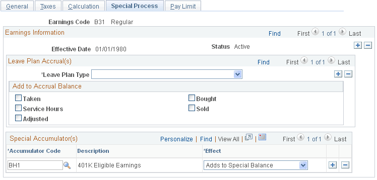

EARNINGS_TABLE4 |
Define how earnings codes affect leave accruals and special accumulators. |

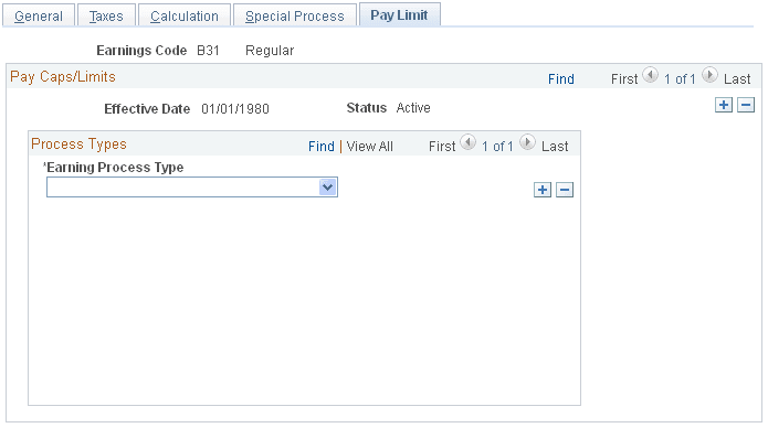

GVT_EARNINGS_TBL5 |
(USF) Select the corresponding earning process type to include the earnings code in pay limit calculations. |

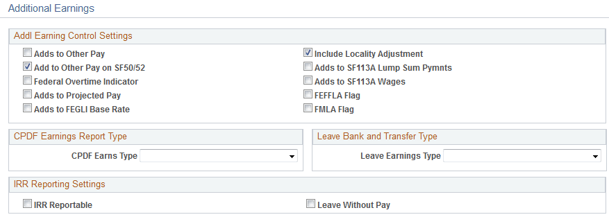

(USF) Use the Additional Earnings page (GVT_EARNINGS_SEC) to specify additional earnings code settings.
Navigation:
Select the Federal button on the Earnings Table - Taxes page.
This example illustrates the fields and controls on the Additional Earnings page.
Addl Earning Control Settings

Description |
Adds to Other Pay |
Select if the earnings adds to other pay in the employees Job - Compensation Data - Other Earnings page. |
Add to Other Pay on SF50/52 |
Select if the earnings code adds to other pay on the SF50 or SF52. |
Federal Overtime Indicator |
Select if the earnings code is used to pay federal overtime. |
Adds to Projected Pay |
Select to include the earnings in total Projected/Future pay for annual total pay cap limitations. Note: For an earnings code (including regular earnings codes) to be included in Projected/Future pay, the Adds to Projected Pay check box must be selected. When no Adds to Projected Pay check boxes are selected, the system reverts to using the employee’s regular biweekly pay for projected and future pay calculation. For information on how the system calculates annual total pay caps and limits, see Understanding Annual Total Pay Caps and Limits Calculation. |
Adds to FEGLI Base Rate (adds to Federal Employee Group Life Insurance base rate) |
Select if earnings add to FEGLI base rate calculation. |
FEFFLA Flag (Federal Employees Family Friendly Leave Act flag) |
Select if this earning code is for the FEFFLA. |
FMLA Flag (Family Medical Leave Act flag) |
Select if the earning code is for the FMLA. |
CPDF Earnings Report Type
Field or Control |
Description |
CPDF Earns Type (Central Personnel Data File earnings type) |
If additional earnings for this earnings code are reportable to the CPDF, select the CPDF earnings code: Not Rpted (not reported), Retn Allow (retention allowance), Staff Diff (staffing differential), or Suprv Diff (supervisory differential). |
Leave Bank and Transfer Type
Field or Control |
Description |
Leave Earnings Type |
Select a value if you're defining an earnings code to use with a leave transfer program type. Valid values are: Donate to Bank: For donor activity in Leave Bank Transfer programs. Donate to Emergency: For donor activity in Emergency Leave Transfer programs. Donate to Recipient: For donor activity in Voluntary Leave Transfer programs. Receive from Bank: For recipient activity in Leave Bank or Emergency Leave Transfer programs. Receive from Donor: For recipient activity in Voluntary Leave Transfer programs. |
IRR Reporting Settings
Field or Control |
Description |
IRR Reportable (Individual Retirement Record reportable) |
Select this check box if additional earnings for this earnings code are associated with basic compensation and are IRR reportable. |
Leave Without Pay |
Select this check box if additional earnings for this earnings code are considered leave without pay on the IRR. These earnings are reported on the Leave Audit SF1150 report (FGSF1150). |

Use the Earnings Table - Special Process page (EARNINGS_TABLE4) to define how earnings codes affect leave accruals and special accumulators.
Navigation:
This example illustrates the fields and controls on the Earnings Table - Special Process page.
Leave Plan Accrual(s)
Use this group box to indicate how the hours for each earnings code affect leave plans. Employees can accrue time using the number of hours they've worked (service hours) or the length of time they've worked for the company (based on the service date in the Job Data component). Set up the accrual method in the Leave Plan table in the Benefits component.
Add to Accrual Balance
Field or Control |
Description |
Taken |
Select this check box for earnings codes (such as vacation or sick) that subtract from the leave plan balance. The system updates the unprocessed data on the Leave Accruals page by adding to the leave plan balance for hours taken, but it does not update the hours taken from the actual leave plan balance until you run the leave accrual program. |
Service Hours |
Select this check box if the leave plan accrues based on the number of hours an employee has worked (service hours). The system adds the hours that are associated with the earnings code to an employee's service hours that are maintained on the leave plan accrual balances. However, if the employee is not enrolled in that leave plan, the system does not update the service hours fields in leave accruals. For example, suppose a company's employee leave plan offers 0.02 hours of vacation time for every hour of regular time and overtime that employees work. In this case, select the Service Hours check box for regular and overtime earnings codes to show that they add to the accrual balance for the employee leave plan. If Jan has 30 hours of regular and 10 hours of overtime earnings, the system adds 40 service hours to her leave plan. It also updates the leave accruals unprocessed data for her leave plan, and accrues 0.8 hours of vacation time when the leave accrual program is run. Note: If you base your leave plan on months of service, the leave accrual program does not use the service hours accumulated by payroll. Instead, it uses the service date in the Employee record to accrue hours for your leave plan. |
Adjusted |
Select this check box if you are defining the earnings code only to add hours to, or subtract hours from, an employee's accrual balances. When you perform the actual adjustments on paysheets, the system accepts positive or negative hours. For example, Jessica Morris, came to CCB from her former company with an intercompany transfer agreement. As part of the agreement, CCB let her carry over 25 hours of vacation time from her old company. To do this, the payroll clerk added 25 hours of accrual adjustment time to Jessica's paysheet. The system—looking at the Earnings table already set up for this type of situation (with Adjusted selected for the VAC leave plan type)—did the rest. |
Bought and Sold |
If your company has a vacation buy or sell plan, select a check box to indicate that the earnings code affects vacation hours bought or sold. Use deductions to handle the actual buying and selling and earnings codes to handle the accruals. For example, Theresa bought 20 hours of vacation time. The payroll clerk added the hours using an earnings code defined with the VAC leave plan type and the Bought check box selected. He used a deduction to take the money that Theresa used to buy the vacation time. If an employee sells vacation time, subtract from the accrual balance using an earnings code defined with the VAC leave plan type and the Sold check box selected. Use a negative deduction to give the employee the money. |
Note: You must run the leave accrual program before the system recognizes or reports any leave accrual information that you define for your company and specific employees.
Special Accumulator(s)
Field or Control |
Description |
Accumulator Code |
Use special accumulators to roll together earnings codes to use later in deduction earning calculations or for tracking supplemental wages for tax purposes. Before you enter this code, define the special accumulator code in the Special Accumulator table. The system delivers the GRS special accumulator code to track the gross wages paid in the employee’s check. For more information, refer to the Special Accumulator Code for Gross Wages section in the Understanding the Washington Paid Family and Medical Leave Tax topic. |
Effect |
Select a value to designate how the earnings affects the special accumulator:
(USF) Use the Earnings Table - Pay Limit page (GVT_EARNINGS_TBL5) to select the corresponding earning process type to include the earnings code in pay limit calculations.
Navigation:
This example illustrates the fields and controls on the Earnings Table - Pay Limit page.
Field or Control |
Description |
Earning Process Type |
To include the earnings code in pay limit calculations, select the applicable process types: Danger Pay: Earnings are capped to a defined percentage of Basic Pay per period. Overtime: Base pay plus overtime is subject to a pay period limit. Overtime hourly rate is subject to an hourly rate limit. Pay Cap - Basic Pay: The sum of base pay, law enforcement officer pay, and locality pay is subject to a defined limit. Pay Limit - Premium Pay: Earnings are subject to a pay period limit. Pay Limit - Total Annual: Total annual earnings are subject to an annual pay limit. Note: To learn more about each earning process type and determine the order in which their pay limits and caps are processed, see Understanding Pay Caps and Limits. |
