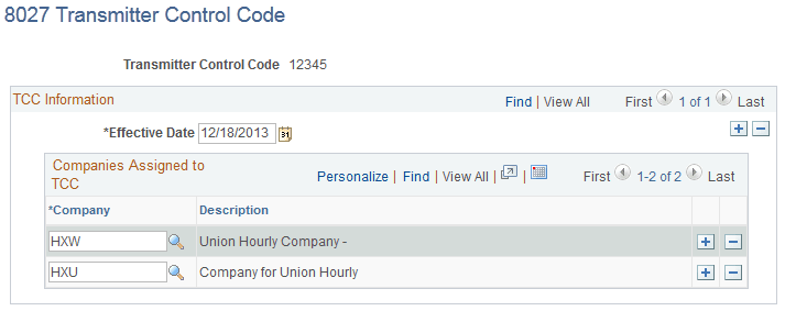

The IRS requires a unique 5-digit numeric Transmitter Control Code (TCC) to file an electronic Form 8027 for a large tip establishment. Each location reported under the same EIN must be associated with the same TCC.
To obtain a Transmitter Control Code for submitting Form 8027 electronically, you must complete Form 4419, Application for Filing Information Returns Electronically (FIRE). Form 4419 can be submitted at any time during the year; however, it should be submitted at least 30 days before the due date of the return(s). Upon approval of the application, a five-character alphanumeric Transmitter Control Code (TCC) will be assigned and included in an approval letter.
Use the 8027 Transmitter Control Code page (PY_TIPS_TCC_TBL) to enter the IRS assigned unique 5-digit transmitter code (TCC).
Navigation:
This example illustrates the fields and controls on the 8027 Transmitter Control Code page.
Field or Control |
Description |
Company |
Select each company (division or department) of a large tip establishment to associate with this Transmitter Control Code (TCC). Transmittal control codes are required by the IRS when filing the annual electronic Form 8027 for large tip establishments. Each location reported under the same EIN must be associated with the same TCC. A company can be associated with only one TCC. A company that is already associated with another TCC, cannot be associated with this one. |

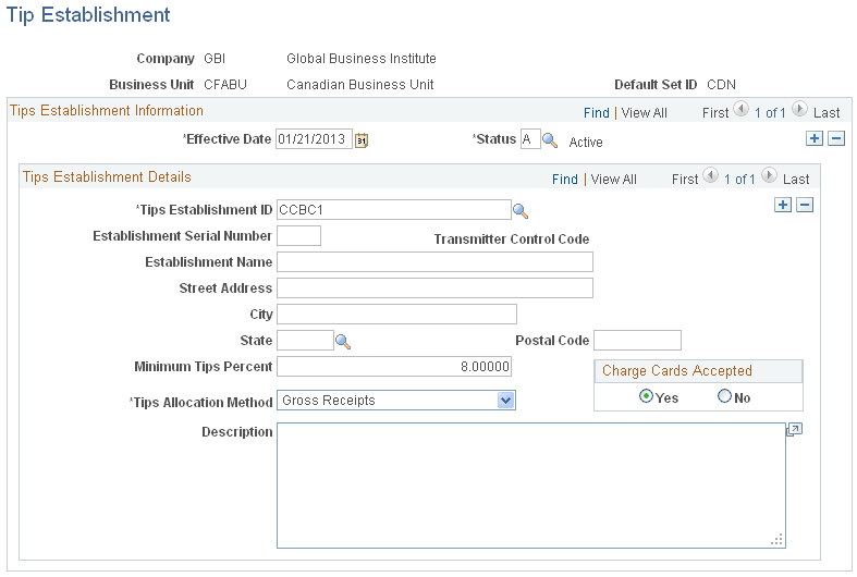

Use the Tip Establishment page (TIPS_ESTAB_TBL) to set up tip establishment parameters for allocating employee tips.
Note: Before using this page, you must define the Tip Establishment Field on the (USA) Tips Processing Page in the Company table.
Navigation:
This example illustrates the fields and controls on the Tip Establishment page.
Field or Control |
Description |
Tips Establishment ID |
Valid values for the Tips Establishment ID field depend on what is selected in the Tip Establishment Field on the Tips Processing page in the Company table. For example, if Job Location is selected as the tip establishment field on the Tips Processing page, a list of valid locations is available to choose from. If Job Dept ID (job department ID) is selected, a list of valid departments is available. See (USA) Tips Processing page (COMP_TBL6USA_SEC) in Entering Company Information in your PeopleSoft HCM Application Fundamentals documentation. |
Establishment Serial Number |
Enter the unique 5-digit numeric serial number that you have assigned to the tip establishment.. |
Transmitter Control Code |
If the tip establishment is associated with a Form 8027 Transmitter Control Code (TCC) on the 8027 Transmitter Control Code page, that code appears here. |
Establishment Name, Street Address, City, State, and Zip Code |
Enter the company name and address. If the Tips Establishment field for the company is set to Job Location on the Company table, the name and address associated with the serial number and TCC appear. You can modify the information here, but modifications here will not change the entry on the Company table or the information assigned by the IRS. |
Minimum Tips Percent |
Enter a minimum tips percent to allocate tips when employees report total tips that are less than a set minimum percent of total sales. The default comes from the Company table, but you can override it. |
Tips Allocation Method |
Valid values are: Gross Receipts, Hours Worked, and Good Faith (Custom). The default is Gross Receipts. The default comes from the Company table, but you can override it. |
Charge Cards Accepted |
Indicate whether credit cards are accepted at the tip establishment. The default value is Yes. |

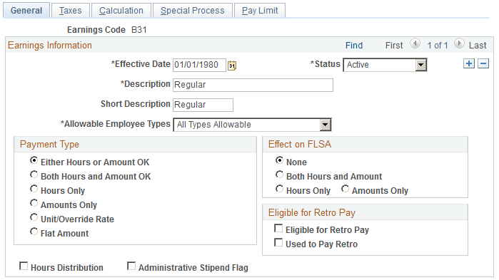

Use the Earnings Table - General page (EARNINGS_TABLE1) to define parameters and rules for calculating earnings for tip processing.
Navigation:
This example illustrates the fields and controls on the Earnings Table - General page.
The following table suggests values and options that you might select for each tip category:
Description Field |
Payment Type Group Box |
Effect on FLSA (effect on Fair Labor Standards Act) Group Box |
Eligible for Retro Pay (eligible for retroactive pay) Group Box |
Allocated Tips |
Amounts Only |
None |
Not applicable. |
Tip Credit |
Amounts Only |
None |
Not applicable. |
Minimum Wage Adjustment |
Amounts Only |
Amounts Only |
Selection depends on company policy. |
Reported Tips |
Amounts Only |
None |
Not applicable. |

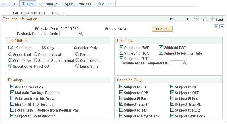

Use the Earnings Table - Taxes page (EARNINGS_TABLE2) to set up earnings code tax information for tip processing.
Navigation:
This example illustrates the fields and controls on the Earnings Table - Taxes page.
Earnings Code Field |
Tax Method Group Box |
Earnings Group Box |
U.S. Only Group Box |
Allocated Tips |
Specified on Paysheet |
Maintain Earnings Balances |
Not subject to withholding; therefore, leave everything blank. Companies do not have to withhold taxes on allocated tips; however, the employee eventually pays taxes on them. |

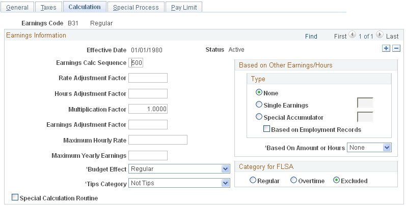

Use the Earnings Table - Calculation page (EARNINGS_TABLE3) to set up earnings code tax calculation information for tip processing.
Navigation:
This example illustrates the fields and controls on the Earnings Table- Calculation page.
Tips Category Field |
Allocated Tips |
Tip Allocation |
Tip Credit |
Tip Credit |
Not Tips |
Reported Tips |
Reported Tips |
