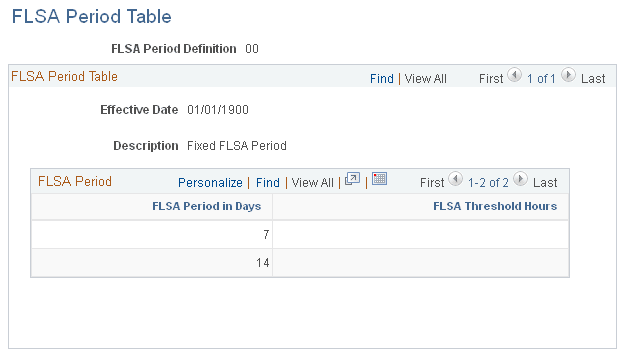

Use the FLSA Period Table page (FLSA_PERIOD_TBL) to view all delivered FLSA periods and create or maintain user-defined FLSA periods.
Navigation:
This example illustrates the fields and controls on the FLSA Period Table page.
FLSA Period
These values cannot be changed for delivered FLSA periods. The fields can be edited for user-defined periods.
Field or Control |
Description |
FLSA Period in Days |
Enter the length of the FLSA pay period, or the days from the FLSA begin date to the FLSA end date. |
FLSA Threshold Hours |
Enter the number of hours worked in the corresponding period length before the FLSA rate applies to fire protection and law enforcement employees. |

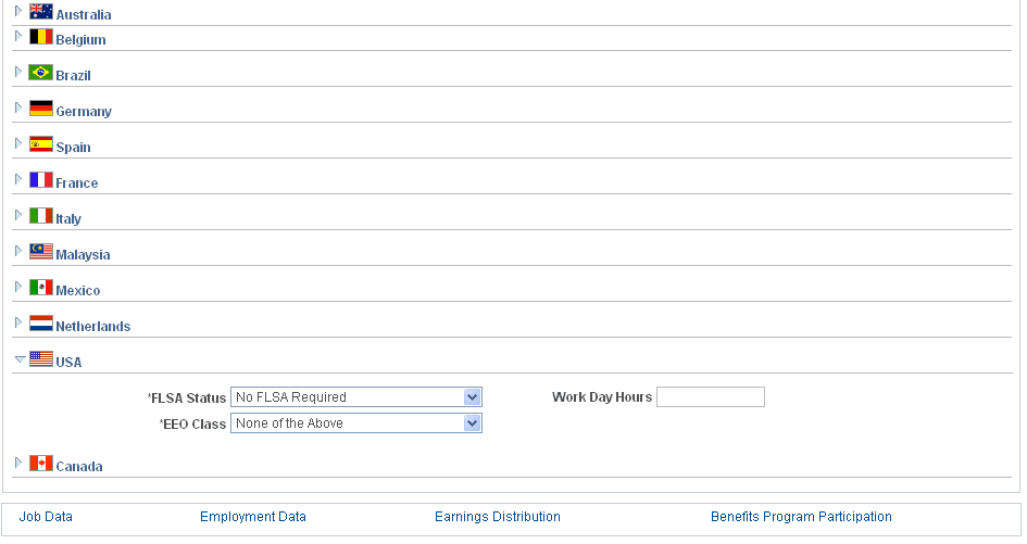

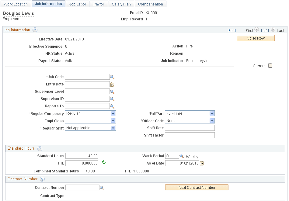

Use the Job Information page (JOB_DATA_JOBCODE) to enter information about a person's job, including status, employee class, shift, or standard hours.
Navigation:
This example illustrates the fields and controls on the Job Information page (1 of 2).
This example illustrates the fields and controls on the Job Information page (2 of 2).
Note: This step is employee-specific. Complete the USA section of the Job Information page when you hire an employee.

FLSA Status (Fair Labor Standards Act status) |
Only nonexempt employees are entitled to FLSA calculation. |
Work Day Hours |
Displays the number of hours an employee is scheduled to work on a normal day, which the system uses to calculate the FLSA Basic Rate Formula. |
Note: Do not enter a salaried employee's compensation rate as an hourly rate (hourly frequency) in the Compensation Rate field on the Job Data - Compensation page. Under some conditions, doing so causes the system to pay minimum wage in place of the FLSA rate.
