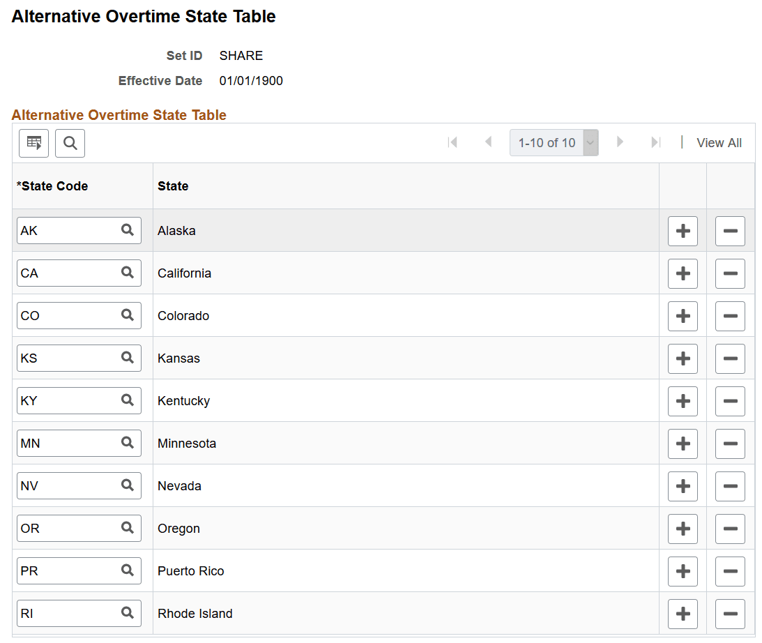

Use the Alternative Overtime State Table page (ALT_OT_STATES) to identify the states that have alternative overtime requirements.
Navigation:
This example illustrates the fields and controls on the Alternative Overtime State Table page.
The SHARE set ID is delivered as sample data showing the states that have alternative overtime requirements. Set up the table for your organization's setIDs according to your company's alternative overtime business rules.
Field or Control |
Description |
State Code |
Enter the 2-character state code to identify in which state alternative overtime calculations should apply. |
