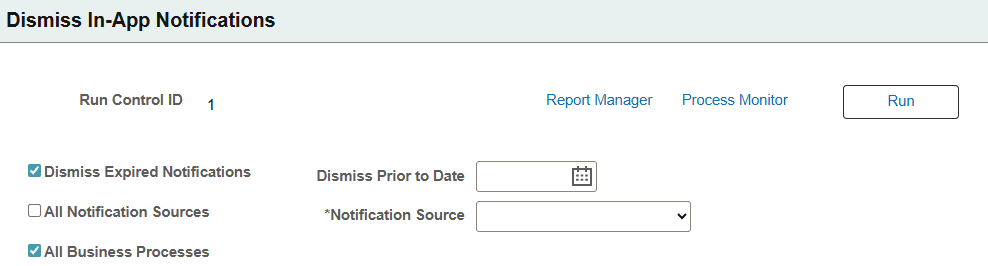

The system delivers the Dismiss In-App Application Engine (AE) process (EONC_DISMISS) that can be used to remove users' in-app notifications from both the Notifications panel and landing page sections as needed.
On the Dismiss In-App Notifications Page, administrators can run the AE process to delete in-app notifications that were sent before a specified date or those that have reached their expiration date (if an expiration date is available). They can set the AE process to remove notifications by notification source and business process specifically as well.
The AE process can be scheduled to run periodically using Process Scheduler to clean up expired or unwanted in-app notifications if necessary.

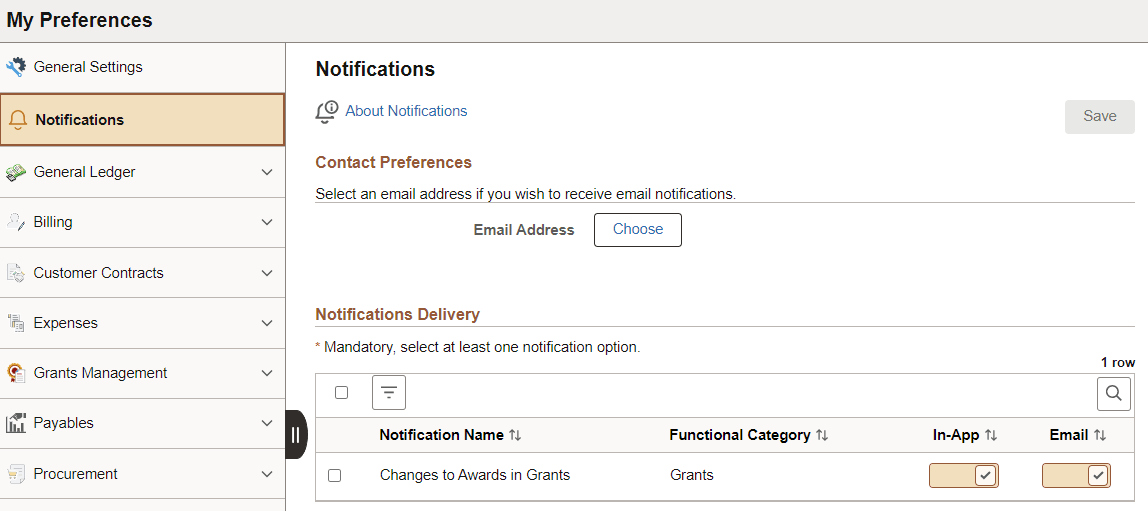

Use the My Preferences - Notifications page (PTPN_USER_PREF) to select contact preferences such as email address, and notification delivery preferences for yourself.
Navigation:
This example illustrates the fields and controls on the My Preferences - Notifications page.
Contact Preferences
Field or Control |
Description |
Choose |
Select this button to access the Email Address page where you can select an email address for notifications. Email addresses are sourced from the User Profile - General page (. |
Notifications Delivery
Use this section to view which notifications you receive, and determine the method you wish to receive each notification.
Field or Control |
Description |
Select (check box) |
Select to display the Action button where you can Enable or Disable the Email, In-App, or Text options in bulk. |
Notification Name and Functional Category |
Displays the information that is determined on the Define Notification Event Page. |
In-App, Email, Text |
Select the method(s) that you would like to receive a notification for each Notification Name. The methods that appear on this page default from the Notification Administration - Global Settings page. |

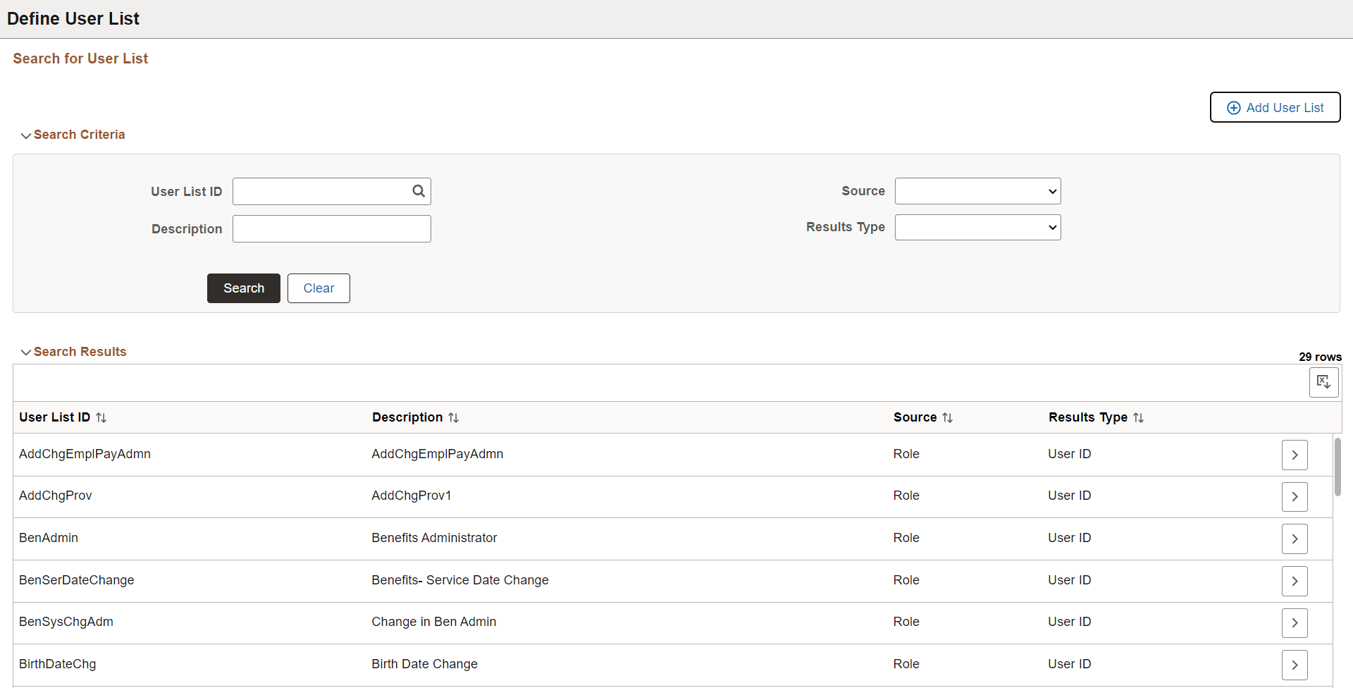

Use the Define User List page (EONC_UL_SRCH_FL) to maintain user lists and add new lists. User lists can be used to define notification recipients.
Navigation:
This example illustrates the fields and controls on the Define User List page.
Field or Control |
Description |
Add User List |
Select this button to access the Add New User List Page and create a new user list. |
Search Criteria
Enter search criteria to find existing user lists. You can search by User List ID, Source, Description, and Results Type.
Search Results
The Search Results displays existing user lists based on your search criteria. For an understanding of each column, see field definitions for the Add New User List Page.
Select a user list row to view or edit user list details on the User List Details page.
Note: The User List Details page (EONC_UL_EDIT_SCF) and Add New User List Page layouts are almost identical. The only difference is that the User List Details page also includes the last updated date and time, and updated by information of the user list.

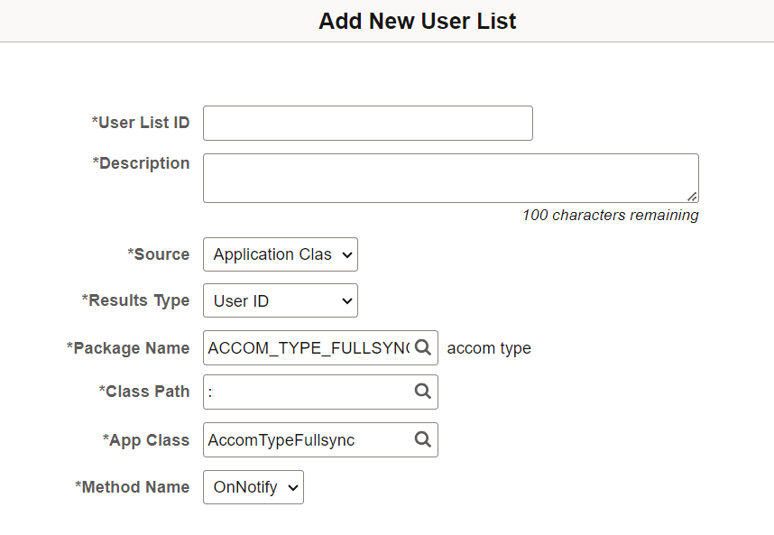

Use the Add New User List page (EONC_UL_ADD_SCF) to create user lists that can be used to define notification recipients. Some fields on the page are generated dynamically based on the Source field value.
Navigation:
Select the Add User List button on the Define User List page.
This example illustrates the fields and controls on the Add New User List page.
Field or Control |
Description |
User List ID and Description |
Enter a short and long description for the user list. |
Source |
Select a source from which you will create the user list. Supported sources are:
When you select a source value, the fields on the page change dynamically. See the sections that follow to view the additional fields that appear with each Source option. |
Results Type |
Select a results type for the user list. The results type determines the type of contact information the source returns:
Note: If you select Role or Role Query from the Source field, only User ID result type can be used. |
Source: Application Class
The page displays these fields when you select Application Class for the Source value:
Field or Control |
Description |
Package Name |
Enter the package (container) associated with the PeopleTools Application Class that is the source for the user list. |
Class Path |
Enter the directory path that defines the location of the PeopleTools Application Class that is the source for the user list. |
App Class (Application Class) |
Enter the PeopleTools Application Class to be used as a source for the user list. |
Method Name |
Enter the method (function) associated with the PeopleTools Application Class that has the logic to identify the recipients. |
Source: Role
The page displays these fields when you select Role for the Source value:
Field or Control |
Description |
Role Name |
Enter the security role. Recipients are determined based on user IDs matching this security role. |
Source: Role Query
The page displays these fields when you select Role Query for the Source value:
Field or Control |
Description |
Query Name |
Enter the query name that returns one or more User IDs as the recipients. |
Source: SQL Definition
The page displays these fields when you select SQL Definition for the Source value:
Field or Control |
Description |
SQL Object ID |
Enter the stand-alone SQL defined in Application Designer that is the source for the user list. |

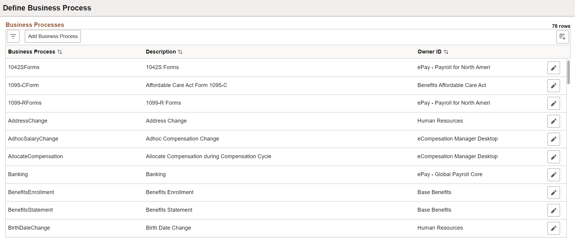

Use the Define Business Process page (EONC_BUS_PROC_FL) to maintain business process definitions and add new processes for Notification Composer. Business processes represent logical grouping of Notification Events.
Navigation:
This example illustrates the fields and controls on the Define Business Processes page.
Field or Control |
Description |
Select this button to access the Filters page and enter parameters used to filter the list by a given business process, description, or object owner ID. |
Add Business Process |
Select this button to access the Add Business Process Page and add additional business processes for your Notification Composer configuration. |
Select this button to access the Edit Business Process page (EONC_BP_EDIT_SCF) and edit an existing business process definition. Note: The Edit Business Process page and Add Business Process Page layouts are almost identical. The only difference is that the Edit Business Process page also includes the last updated date and time, and updated by information of the business process. |
Delete |
Select this button to delete the business process. This button is available only for those business processes you created. You cannot delete a delivered system data event. |

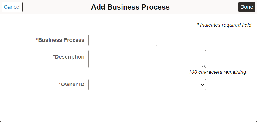

Use the Add Business Process page (EONC_BP_ADD_SCF) to add additional business processes for your Notification Composer configuration. Business processes represent logical grouping of Notification Events.
Navigation:
Select the Add Business Process button on the Define Business Processes Page.
This example illustrates the fields and controls on the Add Business Process page.
Field or Control |
Description |
Business Process and Description |
Enter a short and long description for the business process. |
Owner ID |
Enter the application owner for the business process. |
Done |
Select this button to add and save the business process. |

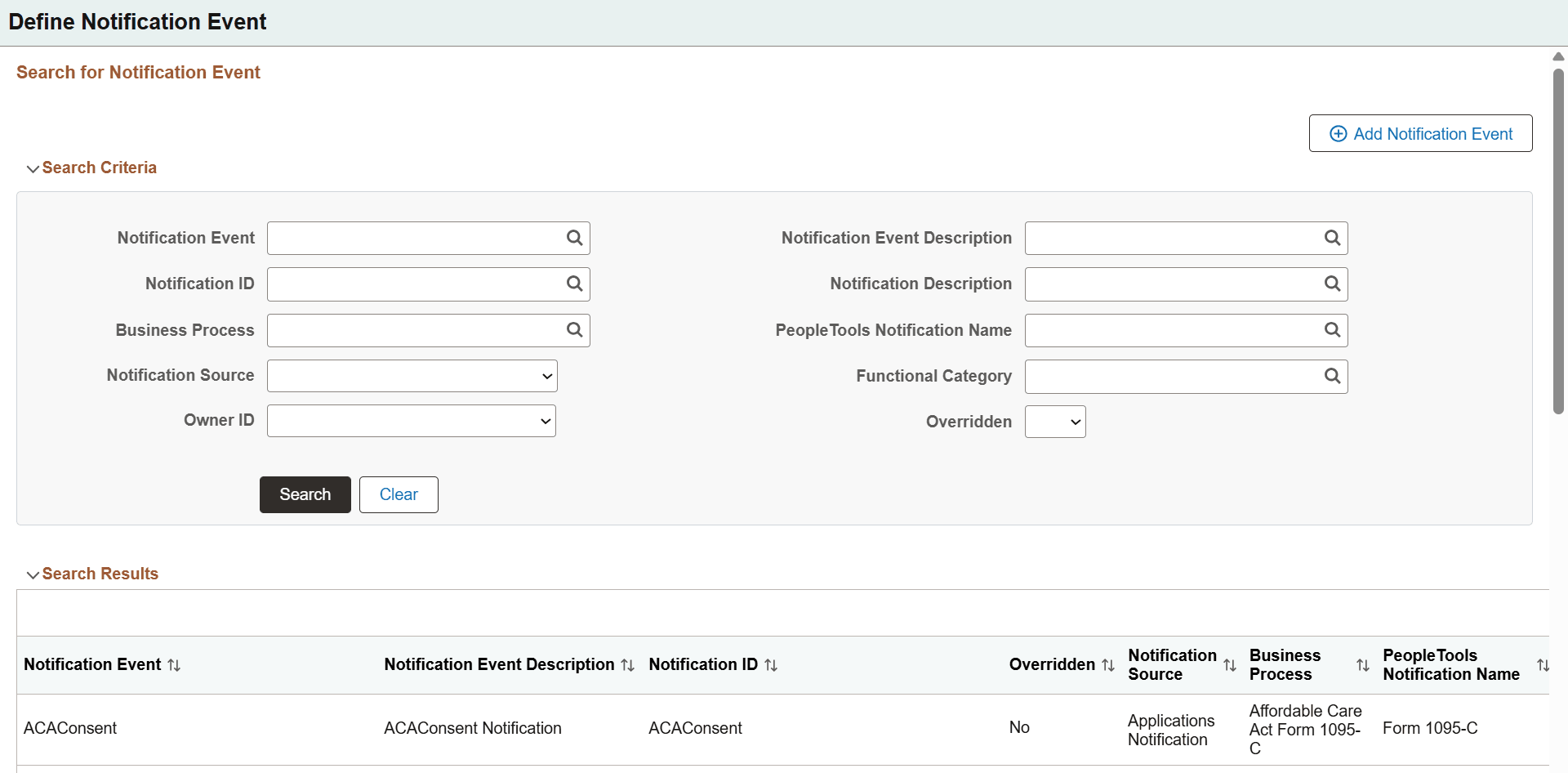

Use the Define Notification Event page (EONC_XREF_DEFN_FL) to manage existing notification events and create new events. Notification Events are events that occur within the context of a PeopleSoft application that trigger notifications, such as hiring an employee or adopting a baby. Notification Events map to theNotification ID, PeopleTools Notification Name, Functional Category, and Business Process.
Navigation:
This example illustrates the fields and controls on the Define Notification Event page.
Field or Control |
Description |
Add Notification Event |
Select this button to access the Add Notification Event Page and create a new notification event. |
Search Criteria
Enter search criteria to find existing Notification Events. You can search by Notification ID, Business Process, Owner ID, PeopleTools Notification Name, and so forth.
Search Results
The Search Results displays existing Notification Events based on your search criteria. For an understanding of each column, see field definitions for the Add Notification Event Page.
Field or Control |
Description |
Overridden |
Indicates whether the delivered Notification ID has been overridden with a new value. You can override the delivered Notification ID using the Edit Notification Event Page. |
Select this button to access the Edit Notification Event Page and edit an existing notification event. |
Delete |
Select this button to delete the Notification Event. This button is available only for those notification events you created. You cannot delete a delivered system data event. |

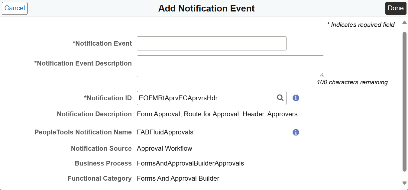

Use the Add Notification Event page (EONC_XREF_ADD_SCF) to create a notification event. Notification Events are events that occur within the context of a PeopleSoft application that trigger notifications, such as hiring an employee or adopting a baby. Notification Events map to the Notification ID.
Navigation:
Select the Add Notification Event button on the Define Notification Event page.
This example illustrates the fields and controls on the Add Notification Event page.
Field or Control |
Description |
Enter the notification event. This information is used as the Notification Event ID. |
Notification Event Description |
Enter a description for the notification event. |
Notification ID |
Enter a Notification ID for the event. The Notification ID helps identify the corresponding PeopleTools Notification, Notification Source, Business Process, and Functional Category. After you enter the Notification ID, the corresponding PeopleTools Notification and Business Process fields display below. You can select the adjacent blue Information icon to access the Notification Details page and view notification details, such as in-app, email, and text. |
Notification Description |
Displays the description of the notification. |
PeopleTools Notification Name |
Displays the PeopleTools notification name associated with this event. PeopleTools notification name is defined within PeopleTools Push Notification Framework. You can select the adjacent blue Information icon to access the PeopleTools Notification Name Details page and view details specific to the PeopleTools notification name, such as delivery channel preferences and personalization authorization. |
Notification Source |
Displays the Notification Source associated with this event. |
Business Process |
Displays the Business Process associated with this event. Business process is a logical grouping of Notification Events. |
Displays the Functional Category associated with the PeopleTools Notification. Functional category is defined within PeopleTools Push Notification Framework and represents a logical grouping of PeopleTools notification name. |

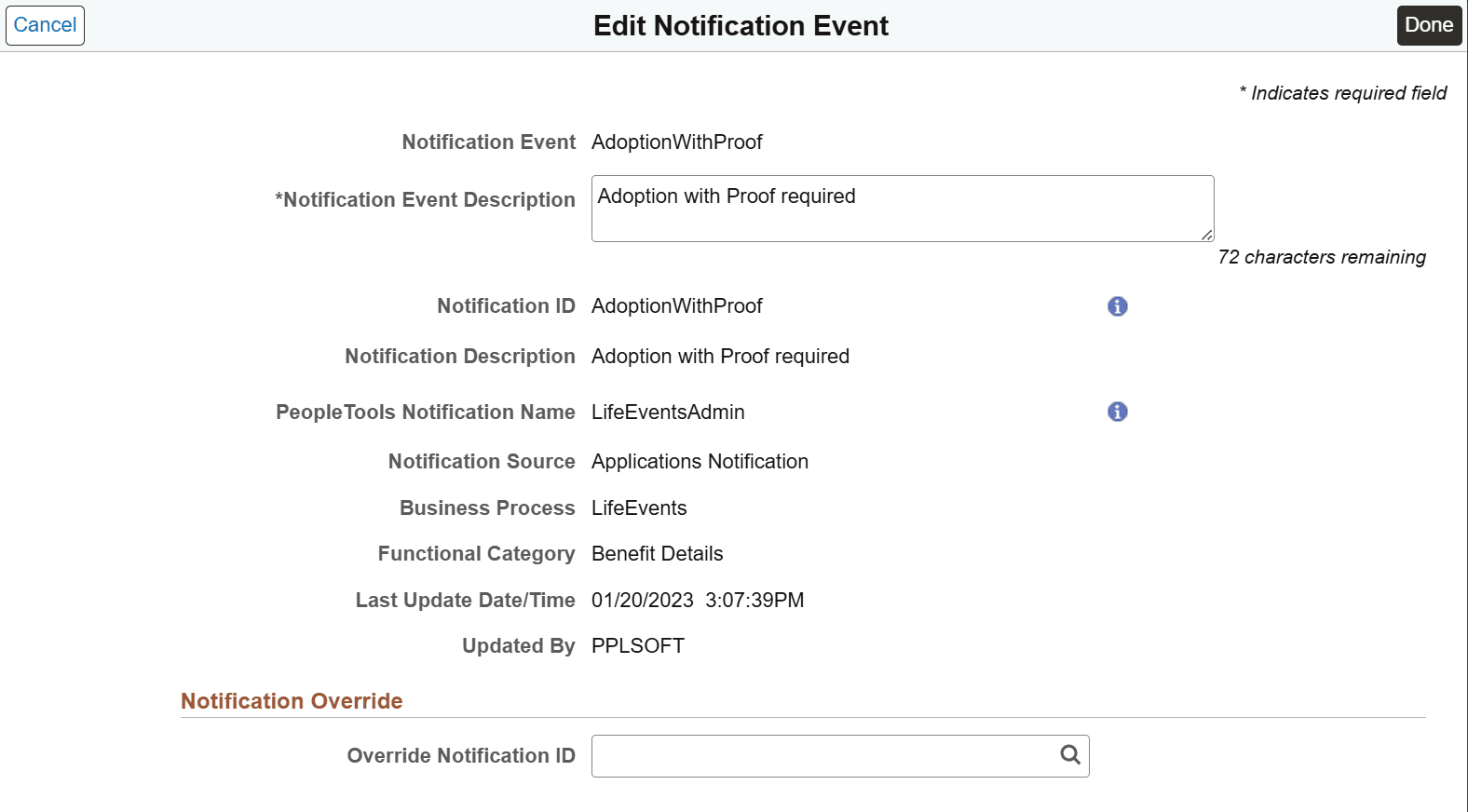

Use the Edit Notification Event page (EONC_XREF_EDIT_SCF) to modify an existing notification event.
Navigation:
Select the Edit Notification Event button on the Define Notification Event page.
This example illustrates the fields and controls on the Edit Notification Event page.
Use this page to modify the Notification Event Description or Override Notification ID values. For example, if you have cloned and modified a delivered Notification ID, use the Override Notification ID field to map to the cloned Notification ID.
Use the blue Information icons to access notification details.

This example illustrates the fields and controls on the Dismiss In-App Notifications page.
Field or Control |
Description |
Dismiss Expired Notifications |
Select to dismiss in-app notifications (those with an expiration or end date) for all or specific notification sources and business processes that have already passed their expiration or end date. |
Dismiss Prior to Date |
Specify the date the process uses to determine which in-app notifications of all or selected notification sources and business processes to dismiss. The process dismisses in-app notifications that were sent before this date. |
All Notification Sources and Notification Source |
(Default) Select to dismiss in-app notifications of all notification sources. Clear this option to dismiss in-app notifications of a specific notification source that you select in the Notification Source field that appears. |
All Business Processes, Business Process, and Business Process Description |
(Default) Select to dismiss in-app notifications of all business processes. Clear this option to dismiss in-app notifications of a specific business process that you select in the Business Process field that appears. Description of the selected business process is displayed in the Business Process Description field. |
