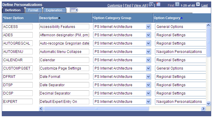

Grid Scroll Bars
On scrollable grids, developers can configure horizontal and vertical scroll bars to appear within the grid control, which enables you to scroll through data within the grid. Note these points about grid scroll bars:
  • An advantage of grid scroll bars is that frozen columns and column headers are stationary.
  • Another advantage is that you can scroll data within the grid without having to use the browser scroll bar, thus other data on the page stays in view.
  • Application developers can configure a scrollable grid to display the horizontal and vertical scroll bars independently of one another.
  • Application developers can configure grid scroll bars and grid tabs to work together or separately.
In this example, you see the Define Personalizations grid showing the Definition, Format, and Explanation tabs. Notice the horizontal and vertical scroll bars inside the grid control.
This example illustrates grid scroll bars in the Define Personalizations grid.

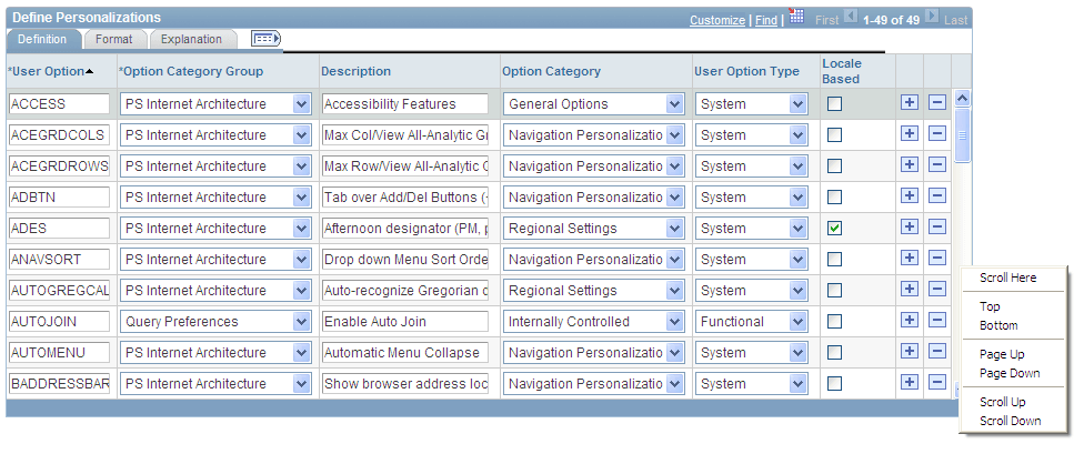

Grid Scroll Bar Pop-up Menus
If you right-click on the horizontal and vertical grid scroll bars, contextual pop-up menus appear.
This example illustrates a scroll bar contextual pop-up menu.
Define Personalizations grid showing scroll bar pop-up menu

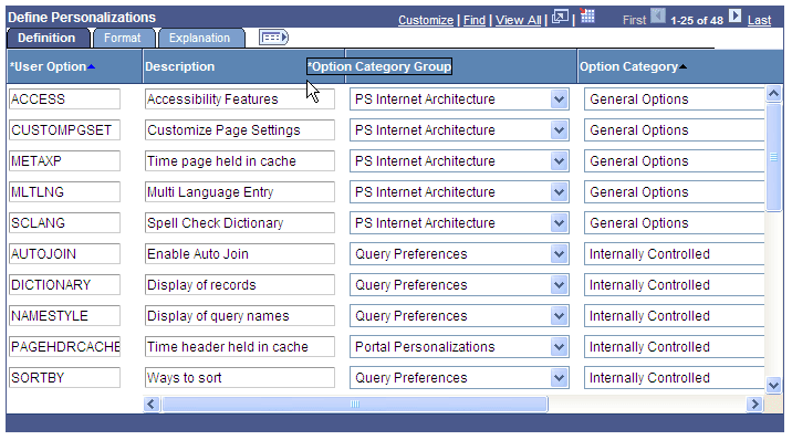

Moving Grid Columns
To move columns:
  1. Place the cursor on the column header label.
    The cursor image becomes a hand.
  2. When the cursor changes shape, click the column label and drag the column to its new location.
    As you drag the column, a border appears around the column header label, and the label moves with the cursor.
  3. When you have the column in the desired location, release the mouse to drop the column.
This example illustrates moving the Option Category Group column.
Dragging the Option Category Group column

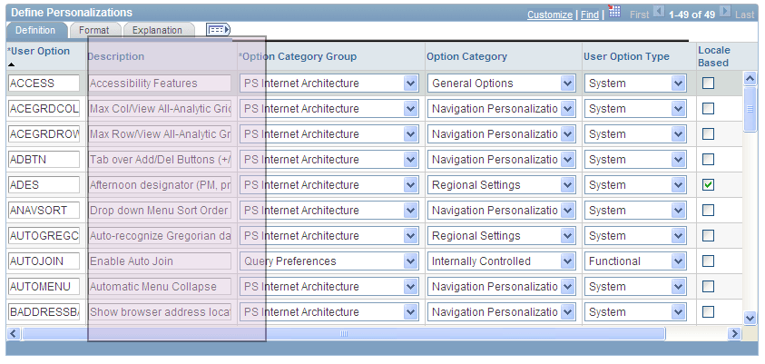

Freezing Grid Columns
A grid can be divided into left and right panes. If the grid is divided, the left pane contains the frozen columns and right pane contains the other columns. If enabled, a horizontal scroll bar appears in the right pane if the columns are wider than the right panel width. If the grid has frozen columns, you can freeze other columns on the transaction page.
To freeze grid columns:
  3. When you have the column in the frozen column area (to the left of the leading edge of the horizontal scroll bar), release the mouse to drop the column.
You can unfreeze columns by dragging them out of the frozen area.

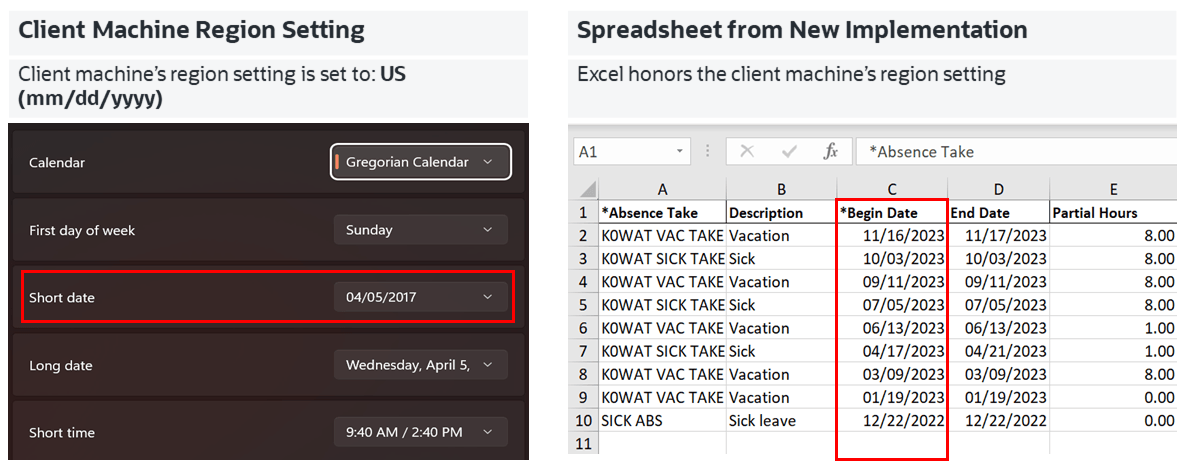

Some grids enable you to download grid data to a Microsoft Excel spreadsheet. The download feature extracts all active, non-hidden rows, regardless of whether the rows are visible on your screen.
To download grid data, click the Download button in the navigation bar of the grid.
Depending on your browser setting, a download dialog window may open and prompt you to save the downloaded spreadsheet.
Note: Ensure that you disable any pop-up blockers in your browser.
Date and DateTime data are downloaded in the canonical format and Excel honors the regional settings of the user's machine while displaying Date and DateTime.
Note: The system downloads all field types (columns) with the exception of images. Hyperlinks are downloaded as quoted text of the field labels, even though the labels may contain numeric values. If any numeric calculations are to be performed based on hyperlink, you must manually convert the text strings to numeric values after downloading the spreadsheet.
Subscribe to the following technical bulletin on My Oracle Support for the latest information: PIA Grids Download to Excel Functionality (Doc ID 2988403.1).
Note the following characteristics when you download the grid data as a Microsoft Excel (.xlsx) file:
  • The downloaded Excel file name follows this format: PS_<Component>_<TimeStamp>.xlsx.
  • Date and DateTime values are exported in a canonical format, which aligns with the regional settings of the user's machine.
  • Dates in the Excel file use the short Date format (regional settings of the user's machine).
  • DateTime in the Excel file uses the Custom format. The date part uses short date format and the time part uses the long time format (regional settings of the user's machine).
  • Character fields are exported as-is, even if they contain numeric values. Leading zeros are preserved.
  • If a DateTime field in the grid includes timezone information, it is exported as a DateTime value without the timezone; the date and time information is retained, but milliseconds are not displayed.
  • Currency symbols, thousand separators, and decimal separators are preserved.
The following screenshot highlights the regional settings in the downloaded spreadsheet (xlsx).
Client machine regional setting supported in spreadsheet
Regional setting on client system
