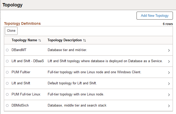

Use the Topology Definitions page (ECL_TOPOLOGY_FL) to perform the following:
  • Create a new topology
  • Edit an existing topology
  • Clone an existing topology
  • Delete an existing topology
Navigation:
Click the Topology tile on the delivered Cloud Manager home page. The Topology Definitions page is displayed.
This example illustrates the fields and controls on the Topology Definitions page. You can find definitions for the fields and controls later on this page.
Field or Control
Description
Topology Name
Name of the topology.
Topology Description
Description for the topology.
Click the arrow on the right (>) to view and edit the definition.
Add New Topology
Click to define a new topology.
Clone
Select an existing topology and click this button to make a copy that you can then edit.
