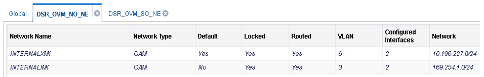

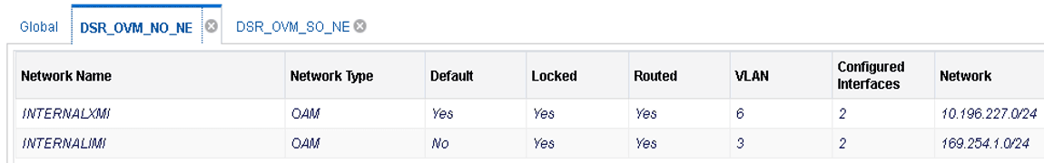

- In NOAM GUI, create the NOAM network element using the XML file.
- Navigate to .
- Click Browse and type the pathname of the NOAM network XML file.
- Click Upload File to upload the XML file. See the examples in Sample Network Element and Hardware Profiles and configure the NOAM network element.
- Once the data has been uploaded, you should see a tabs display with
the name of your network element. Click on this tab which describes
the individual networks that are now configured.

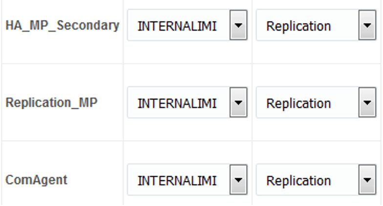

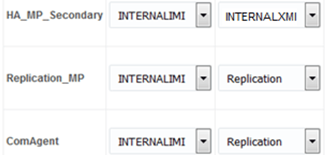

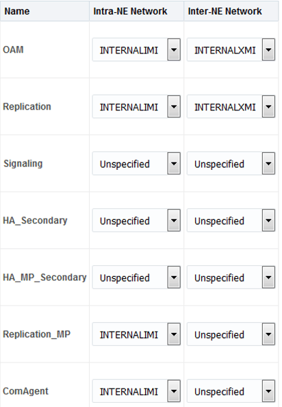

- In NOAM GUI, map services to networks.
- Navigate to .
- Click Edit and set the services as shown in
the table below:
Table 5-1 Network Services
Name Intra-NE Network Inter-NE Network OAM <IMI Network> <XMI Network> Replication <IMI Network> <XMI Network> Signaling Unspecified Unspecified HA_Secondary Unspecified Unspecified HA_MP_Secondary Unspecified Unspecified Replication_MP <IMI Network> Unspecified ComAgent <IMI Network> Unspecified For example, if your IMI network is named IMI and your XMI network is named XMI, then your services configuration should look like the following:
- Click OK to apply the Service-to-Network selections. Dismiss any possible popup notifications.

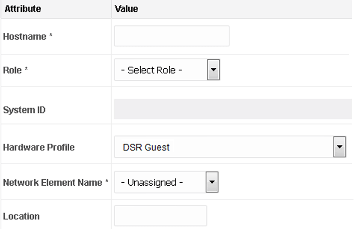

- In NOAM GUI, insert the 1st NOAM VM.
- Navigate to .
- Click Insert to insert the new NOAM server
into servers table (the first or server).
- Fill in the fields as follows:
Hostname: <Hostname>
Role: NETWORK OAM&P
System ID: <Site System ID>
Hardware Profile: DSR Guest
Network Element Name: [Select NE from drop-down list]
The network interface fields are now available with selection choices based on the chosen hardware profile and network element.

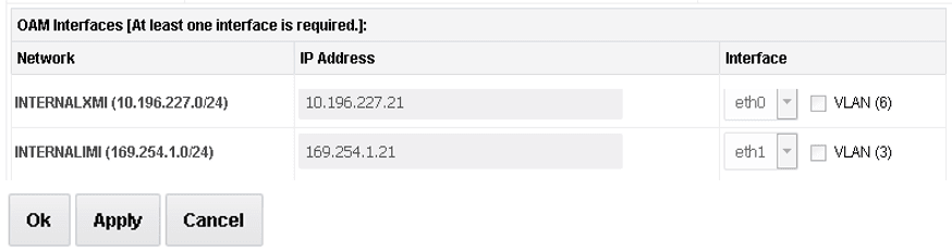

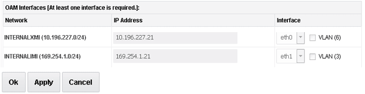

- Fill in the server IP addresses for the XMI network. Select ethX for the interface. Leave the VLAN checkbox unchecked.
- Fill in the server IP addresses for the IMI network. Select ethX for the interface. Leave the VLAN checkbox unchecked.

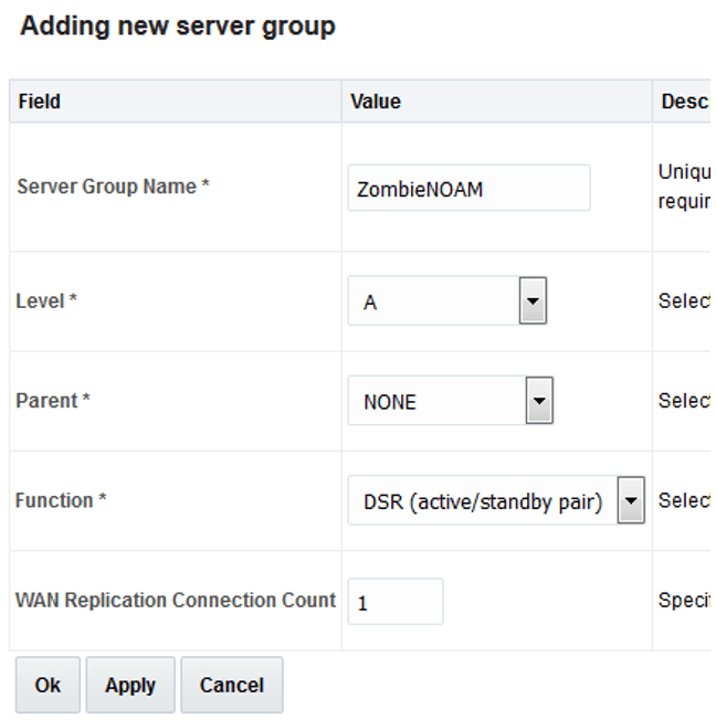

- In NOAM GUI, enter NOAM server group data.
- Navigate to .
- Click Insert and fill in the following
fields:
Server Group Name: [Enter Server Group Name]
Level: A
Parent: None
Function: DSR (Active/Standby Pair)
WAN Replication Connection Count:Use Default Value
- Click OK when all fields are filled.

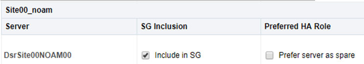

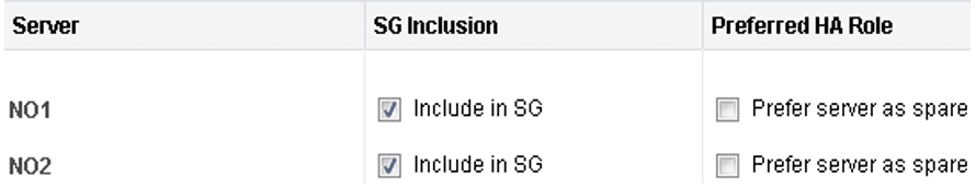

- In NOAM GUI, edit the NOAM server group.
- Navigate to .
- Select the new server group and click
Edit.
Select the network element that represents the NOAM.
- In the portion of the screen that lists the servers for the server group, find the NOAM server being configured. Mark the Include in SG checkbox.
- Leave the other box unchecked.
- Click OK.

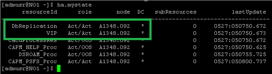

- In NOAM server, verify NOAM VM role.
From console window of the first NOAM VM, run the
ha.mystatecommand to verify the DbReplication and VIP items under the resourceId column has a value of Active under the role column.You may have to wait a few minutes for it to be in that state.
Example:

- In NOAM GUI, insert the second NOAM VM.
- Navigate to .
- Click Insert to insert the new NOAM server into servers table (the first or server).
Role: NETWORK OAM&P
Network Element Name: [Choose NE list]
- Fill in the server IP addresses for the XMI network. Select ethX for the interface. Leave the VLAN checkbox unmarked.
- Fill in the server IP addresses for the IMI network. Select ethX for the interface. Leave the VLAN checkbox unmarked.

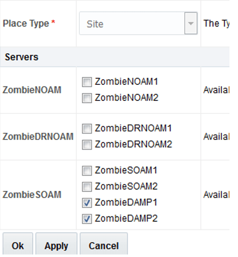

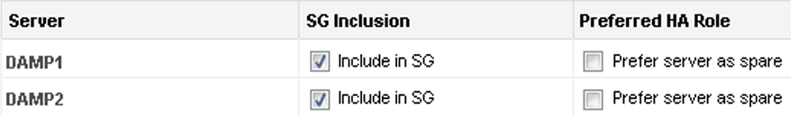

- Add the second NOAM server to the server group by marking the
Include in SG checkbox for the second NOAM
server. Then, click Apply.

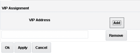

- Click Add to add a NOAM VIP. Type the VIP Address
and click OK.

- In primary NOAM VIP GUI, create the DR NOAM network element using the XML
file.
- Navigate to .
- Click Browse and type the pathname to the NOAM network XML file.
file.
- Once the data has been uploaded, you should see tabs appear with the
name of your network element. Click on the tab, which describes the

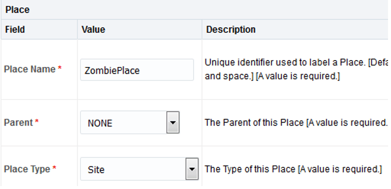

- In primary NOAM VIP GUI, enter DR NOAM server group data.
- Using the GUI session on the primary NOAM server, navigate to .
fields:
Level: A
Parent: None

- Select the network element that represents the DR NOAM.
- Leave other boxes unchecked.
- Click OK.

- In primary NOAM VIP GUI, edit the DR NOAM server group data.
- From the GUI session on the primary NOAM server, navigate to .
- Select the NOAM server group and click Edit.
- Add the second NOAM server to the server group by marking the Include in SG checkbox for the second NOAM server. Then, click Apply.
- Click Add to add an NOAM VIP. Type the
VIP Address and click
OK.

- In primary NOAM VIP GUI, create the SOAM network element using an
XML file.
Ensure to have an SOAM network element XML file available on the PC running the web browser. The SOAM network element XML file is similar to what was created and used in Configure the First NOAM NE and Server, but defines the SOAM network element.
Refer to Sample Network Element and Hardware Profiles for a sample network element xml file.
- Navigate to .
- Click Browse and type the path and name of the SOAM network XML file.
- Click Upload to upload the XML file and configure the SOAM network element.

- In primary NOAM VIP GUI, insert the first SOAM server.
- Navigate to .
- Click Insert to insert the new SOAM server into servers table.
Hostname: <SO1-Hostname>
Role: SYSTEM OAM
Network Element Name: [Choose NE from list]

- Click Insert and add the SOAM server group name
along with the values for the following fields:
Level: B
Parent: [Select the NOAM Server Group]
WAN Replication Connection Count: Use Default Value

- Add both SOAM servers to the server group primary site by marking the Include in SG checkbox.
- Click Apply.
- In primary NOAM VIP GUI, add the SOAM VIP.
- Navigate to .
- Select the new SOAM server group and click Edit.
- Click Add to add a SOAM VIP. Type the VIP Address and click OK.

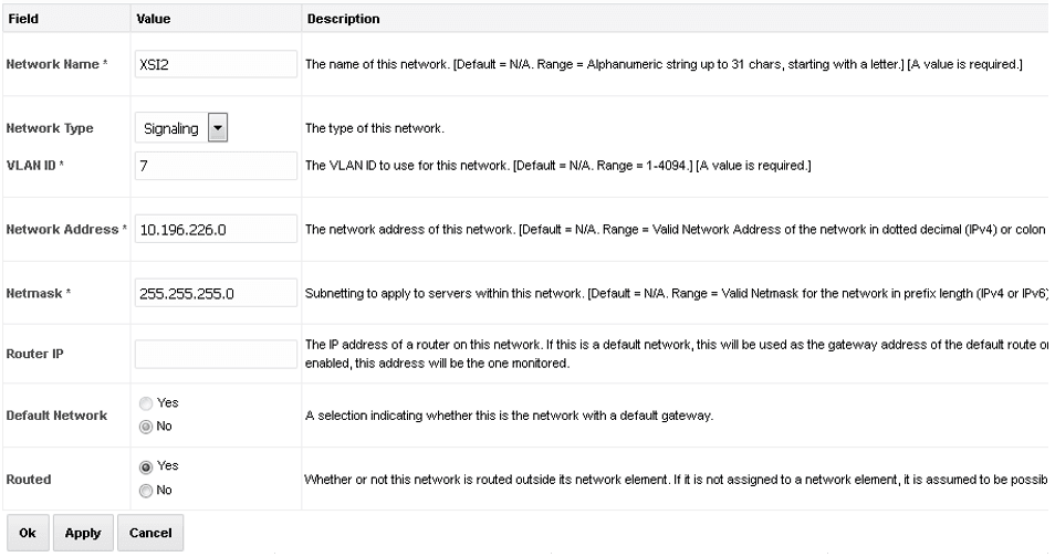

- In primary NOAM VIP GUI, add signaling networks.
The following screen displays.
- Type the Network Name, Network Type, VLAN ID,
Network Address, Netmask, and Router IP that
matches the signaling network.
Even if the network does not use VLAN tagging, you should type the correct VLAN ID here as indicated by the NAPD.- Select Signaling for Network Type.
- Select No for Default Network.
- Select Yes for Routable.
- If you are finished adding signaling networks, click OK. To save this signaling network and repeat this step to enter additional signaling networks, click Apply .

- In primary NOAM VIP GUI, perform additional service to networks
mapping.
Run this step only if you are defining a separate, dedicated network for SBR replication. This is only applicable to PCA.- Navigate to .
- Click Edit.
- Set the services using one of the following scenarios.
- If the dual-path HA configuration is required:
For HA_MP_Secondary, Oracle recommends the inter-NE network is set as the XMI network and intra-NE network is set as the IMI network. If the primary interface (Replication_MP) SBR DB Replication Network interface goes down, use the secondary network for sharing HA status to reduce the likelihood of a split brain. This leads to DSR mate isolation from the active SBR and results in traffic loss until SBR DB Replication Network is down.
Table 5-7 Replication Network
Name Intra-NE Network Inter-NE Network HA_MP_Secondary <IMI Network> <XMI Network> Replication_MP <IMI Network> <SBR DB Replication Network> ComAgent <IMI Network> <SBR DB Replication Network>
- If the dual-path HA configuration is not
required:
The intra-NE network is set as the IMI network and inter-NE network is set as the PCA replication network (configured in step 5. This may lead to a split database scenario in case the SBR DB Replication Network interface goes down. Due to this, an active SBR server in each site is in effect.
Table 5-8 Replication Network
Name Intra-NE Network Inter-NE Network HA_MP_Secondary <IMI Network> <SBR DB Replication Network> Replication_MP <IMI Network> <SBR DB Replication Network> ComAgent <IMI Network> <SBR DB Replication Network>
- In primary NOAM VIP GUI, insert the MP or IPFE server – Part 1.
- Navigate to .
- Click Insert to add the new MP or IPFE server into servers table.
- Fill in the following values:
Role: MP
- For the XMI network, type the MP's XMI IP address. Select the correct interface.
- Leave the VLAN checkbox unmarked.
- For the IMI network, type the MP's IMI IP address. Select the correct
interface.

- In primary NOAM VIP GUI, configure places.
- Establish a GUI session on the NOAM by using the XMI VIP address. Login as the guiadmin user.
- Navigate to .
- Click Insert.
Place Name:<Site Name>
Parent: NONE
Place Type: Site
- Repeat this step for each of the PCA or DCA Places

- In NOAM VIP GUI, assign MP server to places.
- Select the place configured in step 1 and click
Edit.
- Mark all the checkboxes for PCA/DCA DA-MP and SBR servers that are assigned to this place.
- Repeat this step for all other DA-MP or SBR servers you wish to
assign to places.
All DA-MPs and SBR servers must be added to the Site Place that corresponds to the physical location of the server.See the Terminology section for more information on Sites & Places.
Edit.

Table 5-10 MP Server Group
Server Group Function MPs Will Run Redundancy Model DSR (multi-active cluster) Diameter Relay and Application Services Multiple MPs Active per SG DSR (active-standby pair) Diameter Relay and Application Services 1 Active MP and 1 Standby MP/Per SG IP Front End IPFE application 1 Active MP Per SG SBR Policy and Charging Session/or Policy Binding Function/Universal SBR 1 Active MP, 1 Standby MP, 2 Optional Spare Per SG STP vSTP Multiple vSTP MP per SG STPService vSTP MP for the SMS Home Router feature. For vSTP:
If configuring only vSTP application, ignore all other IPFE configuration. Currently, there is no specific MP profile for vSTP MP.
- IPFE interaction with vSTP MP is not supported. There is no support of TSA/Auto selection for vSTP MPs.
- vSTP MP can co-exist with DA-MP under a SOAM but different server group.
- vSTP MP requires 8 GB of RAM.
- vSTP STPService MP must be configured if the SMS Home Router feature is activated by the user after the installation is complete.
For PCA application:
- Online Charging function(only)
At least one MP Server Group with the SBR function must be configured.
At least one MP Server Group with the DSR (multi-active cluster) function must be configured.
- Policy DRA function
At least two MP Server Groups with the SBR function must be configured. One stores session data and one stores binding data.
For non-Policy and Charging SBR Server Groups: Default Value
For Policy and Charging Server Groups: 8
For the PCA application, the following types of MP Server Groups must be configured:
DA-MP (Function: DSR (multi-active cluster))
SBR (Function: SBR)
IPFE (Function: IP Front End)

- In primary NOAM VIP GUI, edit the MP server groups to include MPs.
- Navigate to , select a server group that you just created, and click Edit.
- Select the network element representing the MP server group you wish to edit.
- Mark the Include in SG checkbox for every MP
server you wish to include in this server group. Leave other
checkboxes blank.
Each IPFE and vSTP-MP server should be in its own server group. - Click OK.

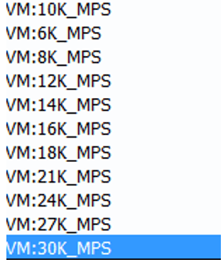

- From the SO GUI, navigate to .
- For each MP, select the proper profile assignment based on the MP’s
type and the function it serves:
- When finished, click Assign.
