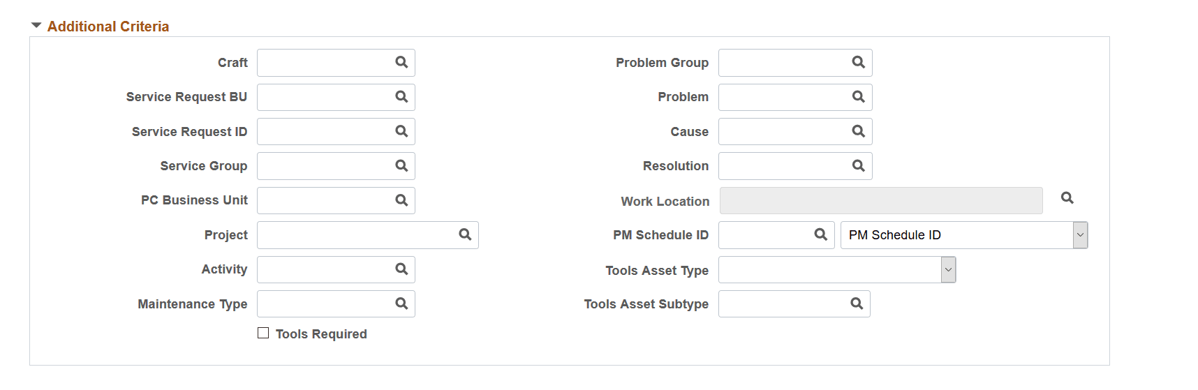

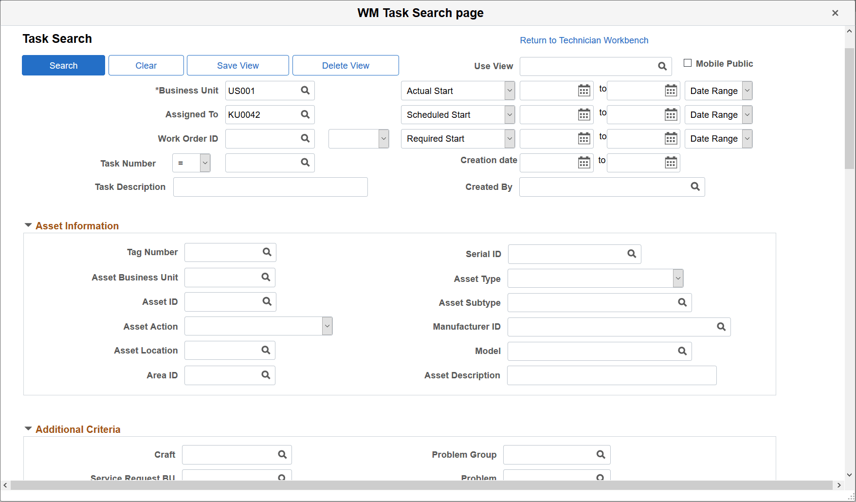

Technician Workbench - Task Search Page
WM_TSK_SRCH_SEC
Perform ad-hoc views (searches), and save and delete views.

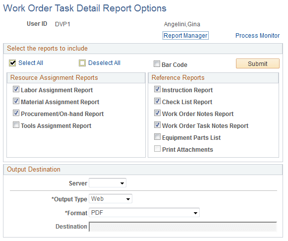

Work Order Task Detail Report Options Page
WM_RPT_OPTNS
Select specific options and reports that you want to print.

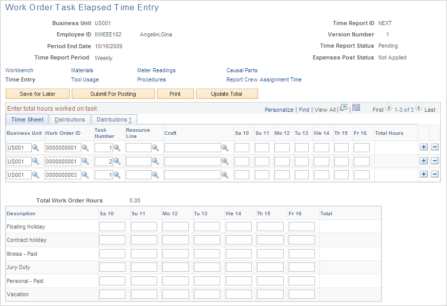

Work Order Task Elapsed Time Entry Page
WM_ETIME_ENTRY
Enter elapsed time entries for this work order task.

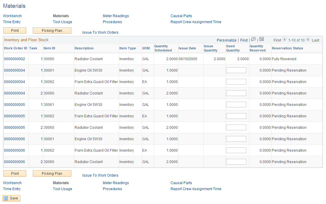

Materials Page
WM_WOE_MTLS
Review inventory and floor stock scheduled for the task, issue the selected materials to the work order, generate a pick plan, and directly access the Schedules page of a selected work order task.

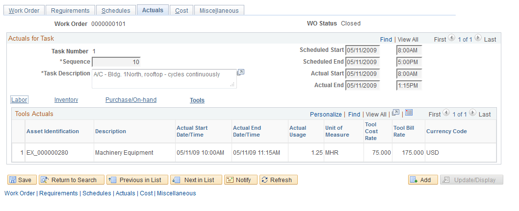

Work Order Task Tools Usage Entry
WM_TLS_USAGE
Enter the dates and times a tool was used and the quantity used for a work order task.

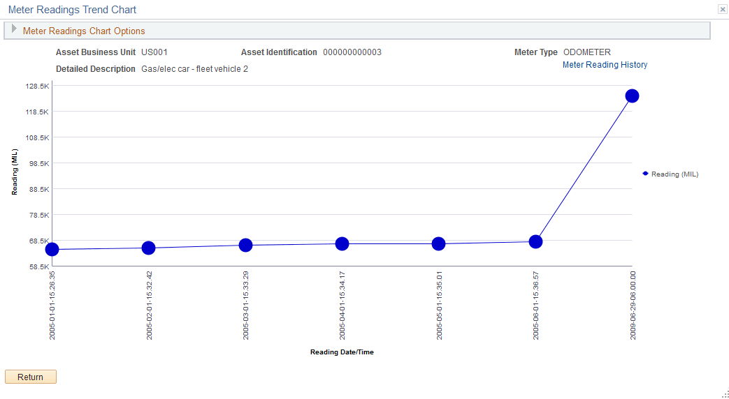

Meter Readings Page
WM_WOE_METER
Enter meter readings and view a meter trend chart for the asset on which the work order task was performed.

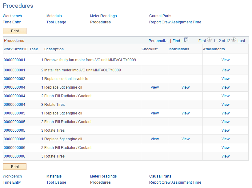

Procedures Page
WM_WOE_LIST
Review the work order checklist, instructions, and attachments associated with a task.

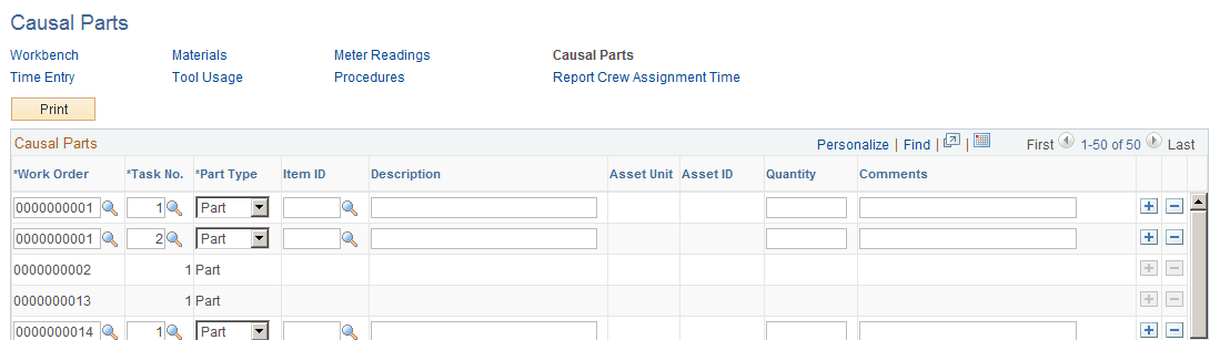

Causal Parts Page
WM_WOE_CAUSAL_PART
Enter one or more parts responsible for causing the failure or the need for the task.

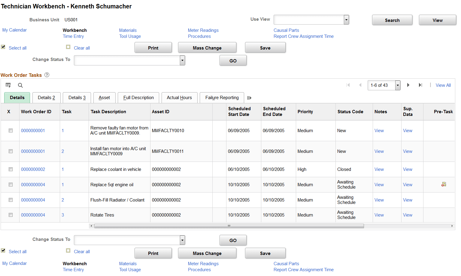

Use the Technician Workbench page (WM_WOE_WB) to select, search, update, and print work order tasks.
Navigation:
Maintenance Management > Workbenches > Technician Workbench
This example illustrates the fields and controls on the Technician Workbench. You can find definitions for the fields and controls later on this page.

You have "n" Service Request(s)
Click this link to access the Service Request Inbox page, which lists the service requests assigned to this technician. This list includes service requests associated with a work order and service requests in which the agent assigned the task to a technician without creating a work order.
Important! This field only appears on the Technician Workbench page if one or more work orders is associated with a service request.
Use View and View
Click the View button to access the Task Search page, where you enter and select criteria to narrow your task search.
Note: When you select the Actual Start date and the Scheduled Start or Scheduled End date on the Task Search page associated with the Technician Workbench, the system searches against the actual start date for a labor task line and the scheduled start or end date for a labor task line. When you select these dates on the Work Order Workbench Task Search page or the Work Progress Tracking Task Search page, the system searches against the actual start date for the work order task and the scheduled start or end date of the work order task.
See Work Order Workbench - Task Search Page.
My Calendar
Click this link to access the technician's monthly calendar. You must create the technician as a PeopleSoft Maintenance Management resource in PeopleSoft Resource Management.
Note: The calendar that appears when you click this link is the calendar of the user who logs into the system. If this person is the technician, then the technician's calendar displays. If this person is an administrator with authorization to enter data for one or more technicians, then the administrator's calendar appears.
Workbench
Click this link in other pages that you can access from the workbench, such as the Work Order Task Punch Time Entry page, to return to the Technician Workbench page.
Time Entry
Click this link to access either the Work Order Task Punch Time Entry page or the Work Order Task Elapsed Time Entry page to enter work order and personal (non-work order) time for a selected task.
Important! You must add all of the general ledger business units that are assigned to employees in the on the Organizational Data page (Travel and Expenses, Update Profile) and the Employee Job page (Maintenance Management, Labor Administration, Manage Employee Data) to the Project Costing Integration template that is associated with the project that was used to create the work order. You must also use the business unit assigned to each employee to set up the Expenses business unit on the Expenses Definition page (Set Up Financials/Supply Chain, Business Unit, Expenses Definition).
See Labor and Personal (Non-Work Order) Time Entry.
Materials
Click this link to access the Materials page.
See Materials Management.
Tool Usage
Click this link to access the Tool Usage page.
See Tool Usage.
Meter Readings
Click this link to access the Meter Readings page.
See Meter Readings.
Procedures
Click this link to access the Procedures page.
See Procedures.
Causal Parts
Click this link to access the Causal Parts page.
See Causal Parts.
Report Crew Assignment Time
Click this link to access the Report Crew Assignment Time page.
See Crew Assignment Time Reporting.
Print
Click this button to access the Work Order Task Detail report options page.
See Work Order Task Detail Report Options Page.
Mass Change
Click this link to access the Workbench Mass Change page, where you can change the actual dates and times, the PCR codes, or both for one or more work order tasks that you selected on the Technician Workbench page. If the Allow Mass Change Hours check box is selected on the User Preferences page, you can enter the actual hours worked for a group of assets across many work orders at the same time. You can only update tasks that are not canceled or closed.
If the PCR codes of the selected work order tasks are the same, the Problem Group, Problem Code, and Cause Code, and Resolution codes are pre-populated in the mass change fields. Otherwise, you need to manually enter values in the fields.
Note: To display the Actual Hours field, the Allow Mass Change Hours check box must be selected on the User Preferences page.
Save
Click this button to update the actual date and time including the start date, end date, start time, and end time for a task. Actual hours time entries are submitted immediately for posting.
Note: Only one actual hours entry type is allowed. If you need to add more entries when posted entries already exist, use the Time Entry option.
Map Selected Tasks
Click this button to display the location of selected work order tasks on an ESRI map. Once the map displays, you can click on each location to display additional information about the work order and work order task.
Important! This button only displays if you selected the GIS Integration check box on the Integration page of the work order business unit associated with the work order task.
The integration with ESRI ARCGIS (Geographic Information System) and Asset Lifecycle Management is no longer supported as of FSCM Update Image 9.2.055.
Change Status To and Go
Select a status from the drop-down list and click Go to access the Change Status page.
Important! All of the previously listed links require the selection of at least one task on the Technician Workbench page.

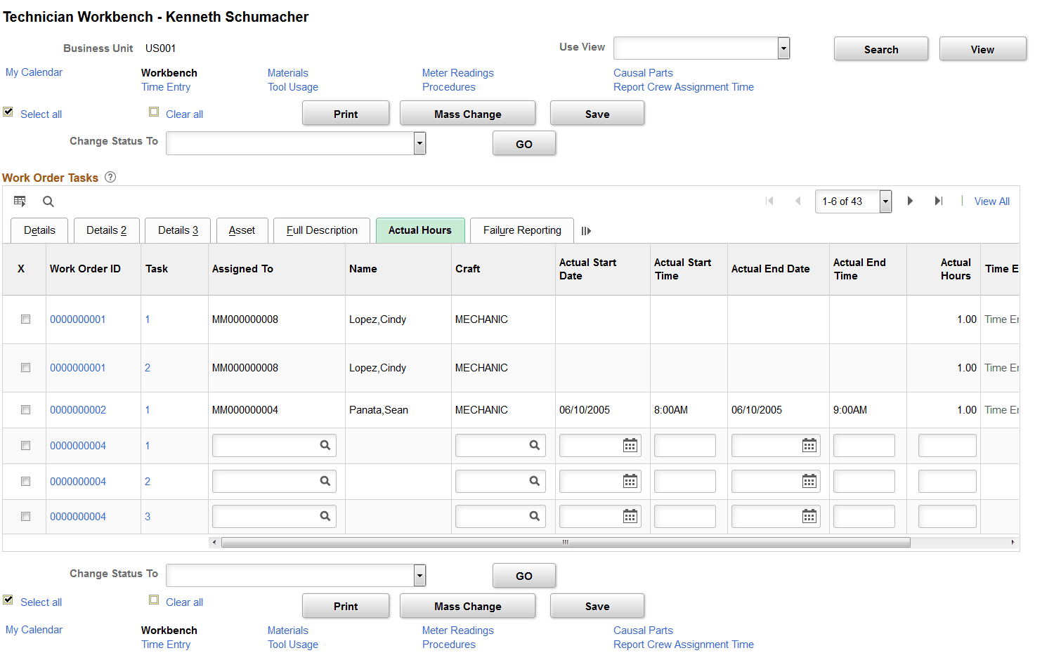

Full Description
Select the Full Description tab to review the full description of the work order and the full description of each work order task that were entered in the Work Order component. If authorized, you can click the Task number link to access the Schedules page of the work order where you can modify both of these work order and the work order task descriptions.
Work Order Task - Actual Hours
Select the Actual Hours tab to enter actual labor hours for a work order task. You can divide the actual hours worked on a group of assets across many work orders and specify the time spent on individual tasks.
Navigation:
Click the Actual Hours tab on the Technician Workbench page.
This example illustrates the fields and controls on the Technician Workbench - Actual Hours Page. You can find definitions for the fields and controls later on this page.
Technician Workbench Actual Hours Page
On the Search page, if the Assigned To filed is blank, then the Actual Hours tab displays the last labor resource schedules for the task. If the Assigned To field value on the Search page and that on the Technician Workbench page are the same, then the tab displays the labor schedules assigned to the employee.
Field or Control
Description
Assigned To
Select an employee ID to assign the work order task. This field is read-only if a timesheet already exists for the work order task and resource line number.
Note: To enable this field, you must select the Allow Access to Other's Tasks option on the User Preferences page.
Name
Displays the selected employee’s name.
Craft
Select a craft for the employee. This field is read-only if a timesheet already exists for the work order task and resource line number.
Actual Start Date, Actual Start Time, Actual End Date, and Actual End Time
Select the Task Actual Dates/Times tab to enter the start and end dates and times when the task was actually performed. These fields are read-only when you close or cancel a work order task.
Note: You can update the actual task dates and times for one or more tasks at the same time by clicking the Mass Change button.
These fields are read-only if a timesheet already exists for the work order task and resource line number.
Actual Hours
Enter the actual hours worked on the task.
Note: This field is enabled only if no timesheet has been created for the employee.
Time Entry Source
Displays the source of the timesheet. The available options are:
  • Actual Hours: Displays if the hours were entered using the Actual Hours tab.
  • Time Entry: Displays if the hours were entered using the Time Entry link.
  • Multiple Sources: Displays if the hours were entered using more than one type of time entry source. The possible sources are:
    • Time Entry
    • Actual Hours

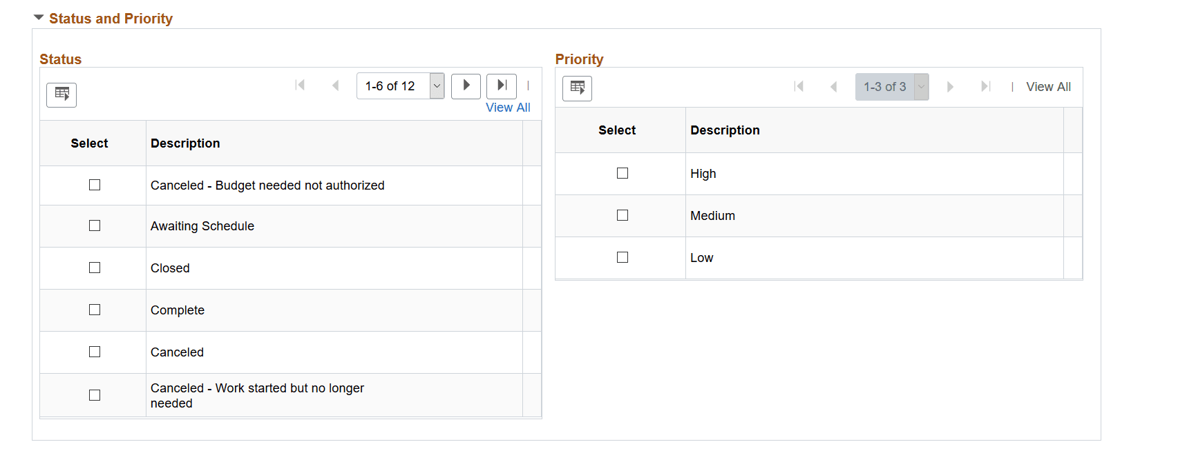

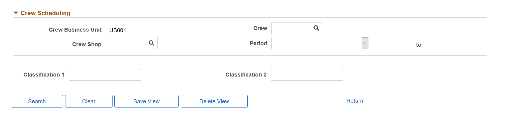

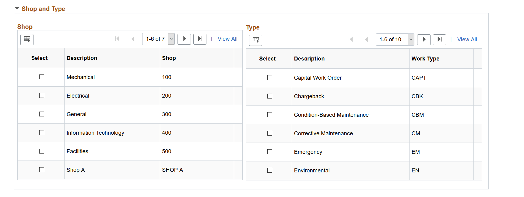

Use the Technician Workbench - Task Search page (WM_TSK_SRCH_SEC) to perform ad-hoc views (searches), and save and delete views.
Navigation:
Click the Search button on the Technician Workbench page.
This example illustrates the fields and controls on the Technician Workbench - Task Search page. You can find definitions for the fields and controls later on this page.
Technician Workbench - Task Search page (1 of 5)
This example illustrates the fields and controls on the Task Search page. You can find definitions for the fields and controls later on this page.
Technician Workbench - Task Search page (2 of 5)
Technician Workbench - Task Search page (3 of 5)
Technician Workbench - Task Search page (4 of 5)
Technician Workbench - Task Search page (5 of 5)
When you click the Save View button, you save the named view for later use. To search for a saved view, select the view name in the Use View field and click the Search button. The resulting tasks will appear in the Work Order Tasks grid. Alternatively, to perform an ad hoc search, enter any search criteria in the Task Search page without saving the view and click the Search button.
Field or Control
Description
Search
Click this button to search for work orders or work order tasks based on the search criteria that you enter on the page. You can select search criteria without saving the view or select search criteria and use Save View button to save that criteria and reuse it.
Clear
Click this button to clear any existing search criteria from the page. You can select new search criteria and click the Save View button to reuse this new search criteria.
Save View
Select search criteria and click this button to name and save the view for reuse.
Delete View
Click this button to delete the current saved view.
Use View
Search for a saved view and click the Search button to search for work orders and work order tasks that fall within the search criteria for that view.
Mobile Public
Select this option to make the saved view available to all Technicians using Mobile devices. If this option is selected the Assigned To field is replaced with an Assigned To Current Technician check box. If this check box is also selected, then the Mobile Public view will only return tasks that are assigned as a scheduled labor resource to the technician who is executing the Search View.
Important! This only applies to technicians who work for organizations that have integrated a third-party mobile device with PeopleSoft Maintenance Management Web Services.
You can include any of the remaining fields on the Task Search page as search criteria to narrow your search for work order tasks.
Note: Business Unit is not required for searches.

Print
Click this button to access the Work Order Task Detail Report Options page, from which you can select various reports to print.

Use the Work Order Task Elapsed Time Entry page (WM_ETIME_ENTRY) to enter elapsed time entries for this work order task.
Navigation:
Click the Time Entry link on the Technician Workbench page.
This example illustrates the fields and controls on the Work Order Task Punch Time Entry page. You can find definitions for the fields and controls later on this page.
The fields in the header and the buttons on this page work the same way that they do in the Work Order Task Punch Time Entry page.
Time Sheet
Select the Time Sheet tab to enter elapsed time for work order tasks on which this employee worked. In elapsed time entry, you enter the hours worked on specific days of the week based on the Period End Date and Time Report Period.
  • If Time Report Period is Daily, then a single day appears in the Work Order Task Elapsed Time Entry, Time Sheet grid.
  • If Time Report Period is Weekly, then the days of the week appear in the Work Order Task Elapsed Time Entry, Time Sheet grid.
  • If Time Report Period is Biweekly, use the Previous Week and Next Weekbuttons to transfer to the previous week or next week for the week not currently shown.
  • If Time Report Period is Semimonthly, the time entry is the same as for the biweekly page.
    However, you can click the Next button twice from the first week and arrive at the last week, which may have just one day available for time entry, depending on the month.
Distributions
Select the Distributions tab, which displays the ChartField distributions that are associated with the resource line. If this a new resource line (actuals entries only), then the distributions are derived form a distribution template. You can override these values, if necessary.

Use the Materials page (WM_WOE_MTLS) to review inventory and floor stock scheduled for the task, issue the selected materials to the work order, generate a pick plan, and directly access the Schedules page of a selected work order task.
Navigation:
Click the Materials link on the Technician Workbench page.
This example illustrates the fields and controls on the Materials page. You can find definitions for the fields and controls later on this page.
Materials page
Field or Control
Description
Print
Click this button to print reports from the Work Order Task Report Options page.
Picking Plan
Click this button to generate a picking plan for selected materials for PeopleSoft Inventory based on the predefined Picking Plan run control in user preferences.
Issue To Work Orders
Click this link to access the Issue to Work Order Search page, where you enter details to issue the item to the work order task. Once the item is issued, the Issue Date and Issue Quantity fields appear in the Inventory and Floor Stock grid.
This grid displays each inventory item or floor stock item that was entered for the selected work order tasks.
Field or Control
Description
Used Quantity
Enter the quantity of this item that was used.
Delivery Truck icon and Delivery Instructions
Displays delivery instructions informing PeopleSoft Inventory which materials to deliver and where to deliver them. Delivery instructions, along with the Delivered Y/N flag (appears as a delivery truck icon) for materials, are updated by the planner or scheduler to indicate where materials need to be delivered. These instructions might also include special handling instructions (such as a fork lift is needed). The Delivered Y/N flag indicates which materials are typically delivered to the work location. You can indicate how you want the materials delivered in the Inventory Schedules grid and the Purchase/On-Hand Schedules grid of the work order task.
Purchase Order and On Hand Materials
This grid appears on the Materials page of the Technician Workbench if you selected any materials that need purchasing or are on hand for a work order task. The grid displays the Resource Type, UOM (unit of measure) and Quantity Required for the task and the Due Date or date the materials are needed.
Field or Control
Description
Used Quantity
Enter the quantity that was used for the task. If the UOM for the selected item is EA (each), you will receive an error if you enter a partial quantity (quantity value with a decimal) in this field. This field is informational only. However, a query was established for this field, which enables your organization to add it to your customized reports.
This grid also defines the staging status of the requisition or the purchase order that may have been created for materials selected for a task, and indicates if the material is on hand.
Use the Work Order Task Tools Usage Entry page (WM_TLS_USAGE) to enter the dates and times a tool was used and the quantity used for a work order task.
Navigation:
Click the Tool Usage link on the Technician Workbench page.
This example illustrates the fields and controls on the Tool Usage page. You can find definitions for the fields and controls later on this page.
Tool Usage page
Field or Control
Description
Asset ID
Select or override the asset ID (Serial ID, VIN, or Asset Tag Number) for the tool. A default value appears if a value was selected in the Tool Schedules grid of the work order task. A description of the tool also appears. The selected asset must be flagged as a tool.
Note: For unplanned tool usage (tool requirements were not defined or scheduled), when you select this value, default values are applied to the Asset Type, Subtype, Manufacturer ID, and Model fields, if applicable. These fields are not visible from the Technician Workbench page.
Quantity Used
Enter the quantity used. For example, if the cost to use a truck is 10 cents per mile and the truck traveled 20 miles during the task, then the quantity used is the total number of miles (20) that the truck traveled for the task. This quantity is multiplied times 10 cents per mile to arrive at the total cost of the tool usage: 2.00 USD.
Actual Start Date, Start Time, Actual End Date, and End Date
Enter the actual start and end dates and times in which the tool was used for a work order task.
Actual Duration
Displays the actual duration of the task based on the actual start dates and time values converted to hours divided by the Quantity Used value. This calculation depends on the unit of measure (UOM) that applies to the tool.
Tools Cost
Select the Tools Cost grid on the Tool Usage page.
Field or Control
Description
Tool Cost Rate and Tool
Override the default Tool Cost Rate and Tool Bill Rate values, as necessary. The default value is derived from the values entered on the Tool Rates page of the shop.
Transaction Date
Override the default system date, as necessary.
Distribution

Trend Chart
Click this icon to access the Meter Readings Trend Chart.
Navigation:
Click the Chart icon on the Meter Readings page
This example illustrates the fields and controls on the Meter Reading Trend Chart page. You can find definitions for the fields and controls later on this page.
Field or Control
Description
Start Date
Select the beginning date for the meter readings that you want to appear on the Meter Readings Trend Chart.
Upper Limit for Chart Y Axis
Enter the upper limit (Readings/KWH) that you want to appear on the Y axis of the Meter Readings Trend Chart.
End Date
Select the last date for the meter readings that you want to appear on the Meter Readings Trend Chart.
Upper Limit for Chart X Axis
Enter the upper limit (Reading Date/Time) that you want to appear on the X axis of the Meter Readings Trend Chart.
Last Readings to Chart
Indicates the total number of readings that appeared on the chart starting with the latest readings.
Chart Readings
Click this button to display the Meter Readings Trend Chart based on the values you entered for the Meter Readings Chart Options.
Clear
Click this button to clear the Meter Readings Chart Options fields.
This chart compares the meter readings that were read on the odometer of this vehicle every 200 miles, and each date and time the meter readings were taken.
Use the Procedures page (WM_WOE_LIST) to review the work order checklist, instructions, and attachments associated with a task.
Navigation:
Click the Procedures link on the Technician Workbench page.
This example illustrates the fields and controls on the Procedures page. You can find definitions for the fields and controls later on this page.
Procedures page
Field or Control
Description
Checklist, Instructions, and Attachments
Select to access the checklist, instructions, and attachments pages associated with the work order task. If the work order is associated with a service request, you can view the service request attachments. You can also access the task and add instructions or checklist items via the Work Order component. You must call up the task again to access the view links for any additional procedures that you added to the task.
Use the Causal Parts page (WM_WOE_CAUSAL_PART) to enter one or more parts responsible for causing the failure or the need for the task.
Navigation:
Click the Causal Parts link on the Technician Workbench page.
This example illustrates the fields and controls on the Causal Parts page. You can find definitions for the fields and controls later on this page.
Causal Parts page
Field or Control
Description
Part Type
Select if this causal part is either an inventory item, an asset, or a description. Values are:
  • Part
    If you select this value, then the inventory Item ID field is enabled so that you can select the item that caused the problem.
  • Asset
    If you select this value, then the Asset Unit and Asset ID fields are enabled so that you can select the asset that caused the problem.
Quantity
Enter the number of parts or assets that caused the problem.

Click the Report Crew Assignment Time link on the Technician Workbench page.
Field or Control
Description
Action
Select the rows that you want to affect with this action, and then select one of these actions:
  • Report Completed Date
    Select this value to display a date field, where you can select the date the selected work order task row was completed.
    Select the Go button to perform the action and update the rows.
  • Update Carryover Hours
    Select this value to display these fields:
    • To
      Enter the number of carryover hours to update the selected rows.
    • Completed
      The date the work was completed appears in this field. You can override this date.
  • Update Completed Man Hours
    Select this value to display the To field, where you can enter the completed labor hours for the selected rows.
Crew Assignments
Click the Crew Assignments tab on the Report Crew Assignment Time page.
Field or Control
Description
Work Order, Task No, Task Line, Task Descriptions, Task Status, Asset ID, Craft, Estimated Man Hours, and Crew
The field values for each row are derived from the work order and from the Crew Scheduling Workbench.
Carryover Hours
Displays the carryover hours. If you enter a completed date, then the carryover hours are zero. You can enter a value in each row or you can update the carryover hours for one or more rows by selecting the Update Carryover Hours action.
Completed Hours
Enter the number of hours of work completed for each row. You can also select the row and the Update Completed Man Hours action to update one or more rows at the same time.
Completed
Select the date on which the hours were completed for each row. You can also select one or more rows and the Report Completed Date action to perform this activity. When this field is populated, the carryover hours in the row are set to zero.
Use the Work Order Task Detail Report Options page (WM_RPT_OPTNS) to select specific options and reports that you want to print.
Navigation:
Click the Print button on the Technician Workbench page.
This example illustrates the fields and controls on the Work Order Task Detail Report Options page. You can find definitions for the fields and controls later on this page.
Field or Control
Description
Bar Code
Select this option to print work order information such as the work order business unit, the work order ID, the task ID, and the resource line number for materials in bar code format for selected reports. For inventory items, the barcode is printed in the Scheduled Materials section. The storeroom clerk can then scan a resource line directly from the materials list and match it with the items committed to the work order task.
Server
Select the Process Scheduler server on which to run the report process. If left blank, the default Process Scheduler server will be used.
When the Print Attachments check box is selected, you must choose a Server that has an additional component application for attachment printing installed for the attachments to print correctly.
Output Type
Select the Output Type of the report. Typically, the Output Types of Printer or Web will be used.
When the Print Attachments check box is selected, the Output Type will default to Printer option and will be disabled.
Format
The available list of report formats depends on the Output Type selected.
When the Print Attachments check box is selected, the Format will default to the report format for Printer option and will be disabled.
Destination
Specify the destination for the selected Output Type.
For Output Type option of Printer, specify the destination printer name. You can select a printer name from the list of configured printers. The printers can be setup on the Work Order Options Page. Work Order Options are specific to a SetID and hence the printer names displayed can be restricted by the business unit. Printer setup is optional.
Note: An incorrectly entered printer destination will result in an error in the Work Order Task Details report process. The process will then need to be submitted again. Use the printer setup option on the Work Order Options page to avoid entering an incorrect printer name.
Note: The Work Order Task Detail Report Options are automatically retained from the last successful request. These options appear as the default values when the user returns to the page.
