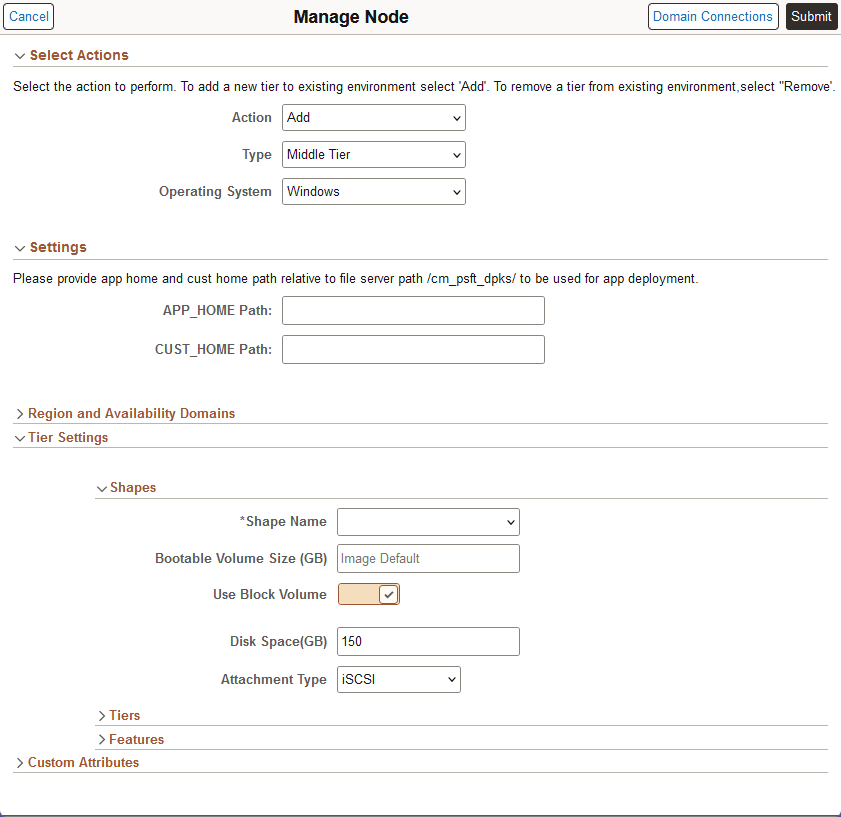

This example illustrates the fields and controls on the Manage Node page for adding a Windows middle tier node.
Manage Node page - add Middle Tier Windows node
Note: Windows Middle Tier node is only supported for PeopleTools 8.57 and above. It is not supported on PeopleTools 8.55 or 8.56 environments.
The APP_HOME (Application home, or app home) and CUST_HOME (custom home, or cust home) paths are not mandatory when adding a Windows middle tier. However if you want to copy contents from the app home and/or cust home to the Windows middle tier perform the following:
  1. Create a directory inside file server mount in the Cloud Manager. For example:
    1. Create a directory ps_app_home_win inside /cm_psft_dpks.
    2. Place the app_home contents as a zip file inside this directory.
    3. Create a directory ps_cust_home_win inside /cm_psft_dpks.
    4. Place the cust_home contents as a zip file inside this directory
  2. Provide the path to app home (APP_HOME) and/or cust home (CUST_HOME). For example: ps_app_home_win and ps_cust_home_win.
  3. When the Windows middle tier node is provisioned, the contents in the zip file will be extracted to the VM instance.
See Adding Windows Middle Tier Nodes.

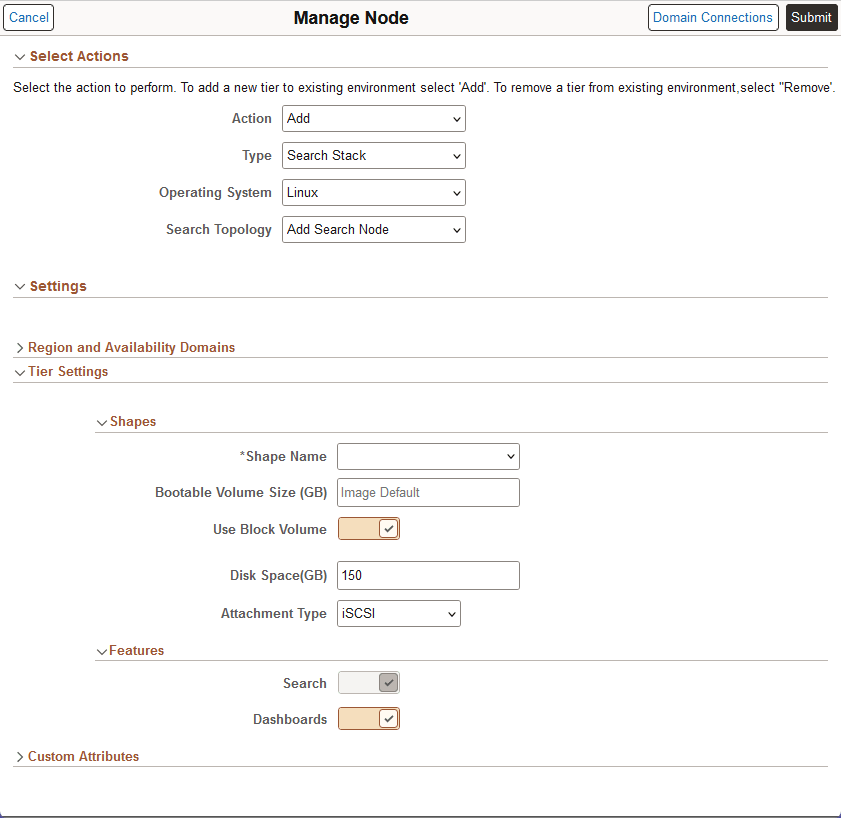

Adding a Search Stack Node
This is an example of adding a search stack node to an environment.
This example illustrates the fields and controls on the Manage Node page for adding a Search Stack node.
Manage Node page - add Search Stack node
You must select at least one feature. OpenSearch and OpenSearch Dashboards (or Elasticsearch and Kibana) can be added in the same node.
For information on adding a node for an environment with a search cluster, see Managing Search Clusters.
Refer to the section on Creating Topology for more information. See Adding Search Stack Nodes.

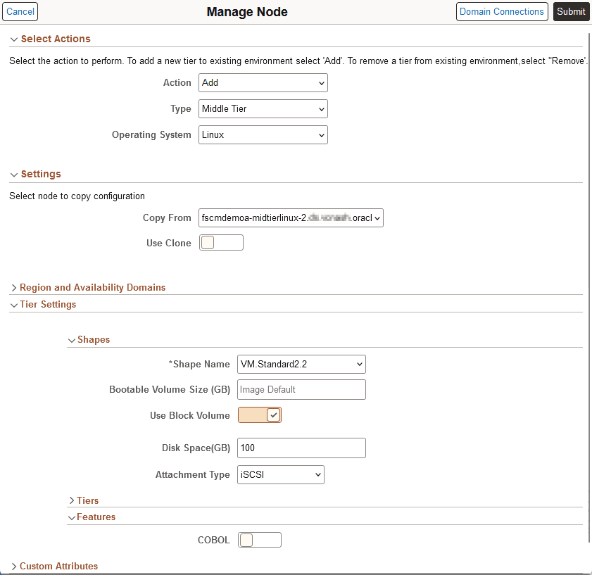

Adding a Middle Tier Node
This is an example of adding a middle tier node to an environment.
This example illustrates the fields and controls on the Manage Node page to add a Linux middle tier node.
Add Middle Tier Node example
In the Settings section, select the location of the Application DPK.
  • Object Store
    When you select Object Store, the DPK Object Name drop down list will display all the application DPK files in Object Store.
    This example illustrates the fields and controls on the Manage Node page where the Application DPK location is Object Store.
    Application DPK in Object Store
  • File Server
    If you manually copied app home and cust home to the file server provide the relative path to the file server.
    This example illustrates the fields and controls on the Manage Node page where the Application DPK location is File Server.
    Application DPK in File Server
Adding Additional Middle Tier Nodes
This example illustrates the fields and controls on the Manage Node page for adding an additional Linux middle tier node.
Manage Node page - adding an additional Middle Tier node

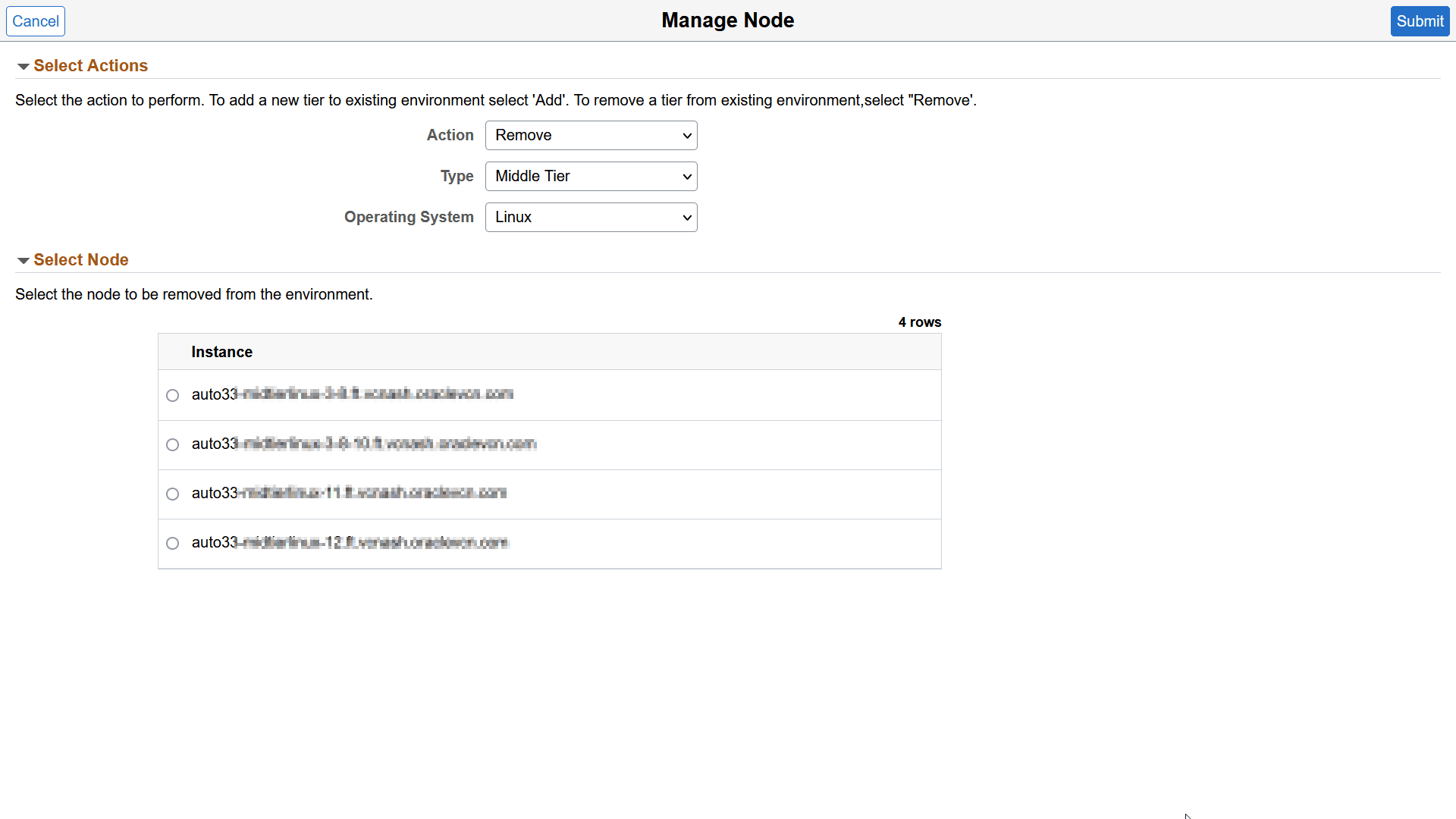

Removing Nodes
Beginning with Cloud Manager Image 21, you can remove the last middle-tier node in some cases. If an environment includes only a single middle-tier node, it is possible to remove it, leaving only the database node.
If an environment includes more than one middle-tier node, Cloud Manager determines which middle-tier nodes are critical for operation and communication, such as those with Integration Broker, Application Server, and Web Server. These critical nodes cannot be removed. Other nodes in the environment can be removed.
To remove a node:
  1. Click the Related Actions button corresponding to the environment.
  2. Select Manage Node.
  3. Select Remove action.
  4. Select Type.
  5. Available Nodes will be displayed.
    Note: Database node can not be deleted.
  6. Select the node to remove.
  7. Click Submit and confirm.
This example illustrates the fields and controls on the Manage Node page for removing a node.
Manage Node page - Remove Middle Tier Node

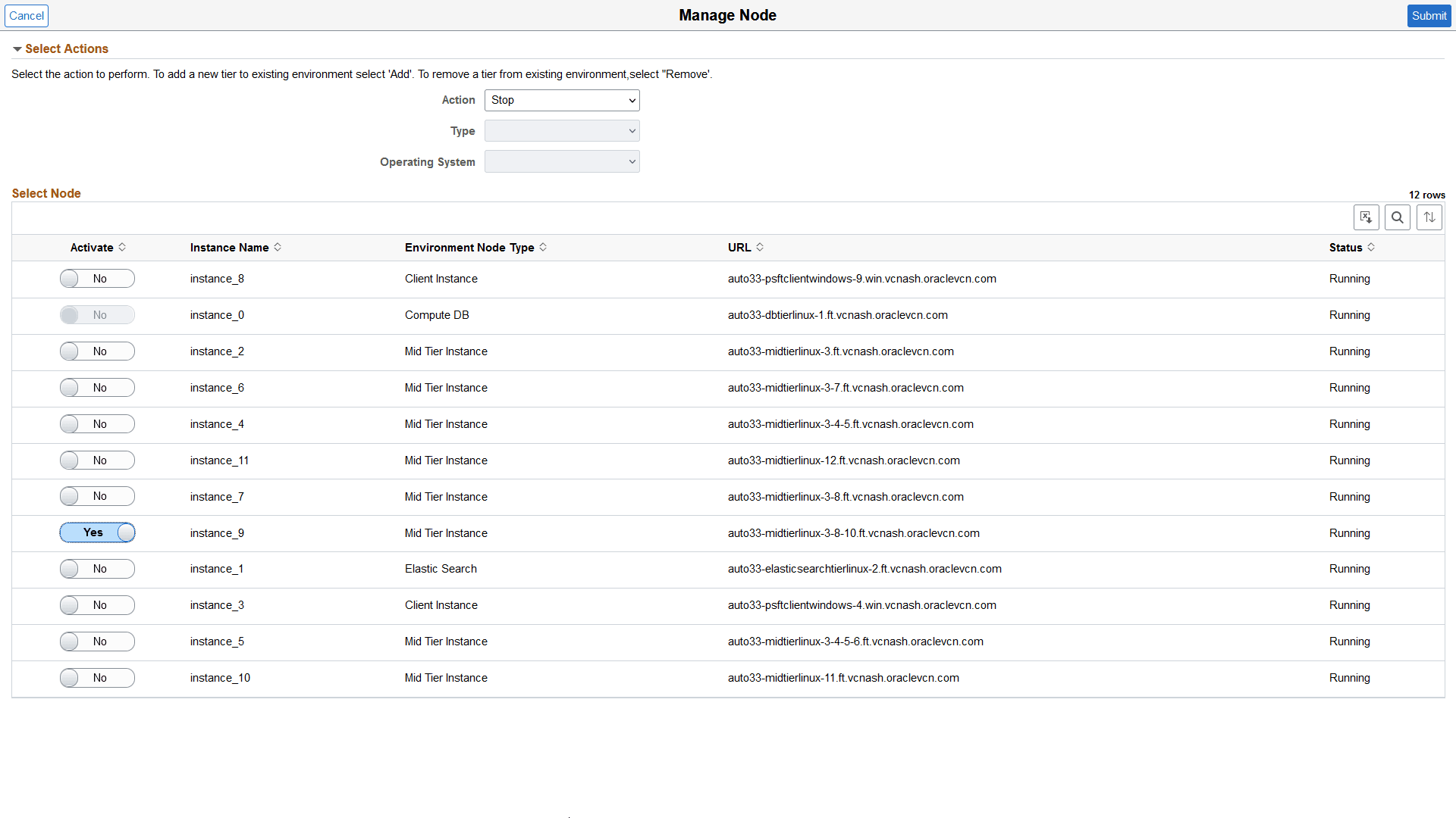

Stopping Nodes
To stop a node:
  3. Select Stop action.
  4. Available Nodes will be displayed.
    Note: Database node can not be stopped.
  5. Select the node or nodes to stop.
  6. Click Submit.
This example illustrates the Manage Node page to stop a node.
Manage Node page - Stop Node

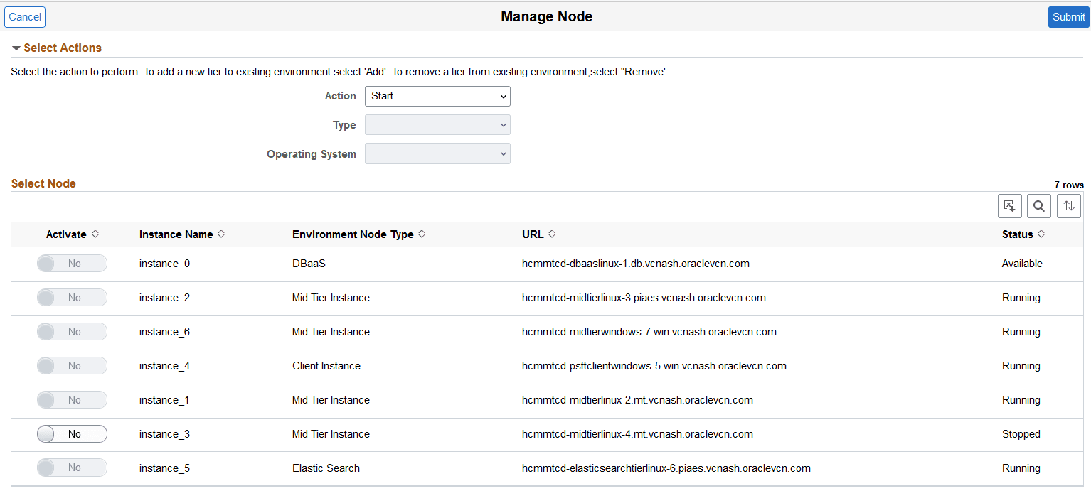

Starting Nodes
To start a node:
  3. Select Start action.
  4. The Activate toggle is available for any nodes in a stopped status.
  5. Select the node or nodes to start.
  6. Click Submit.
This example illustrates the Manage Node page to start a node.
Manage Node page - Start Node
