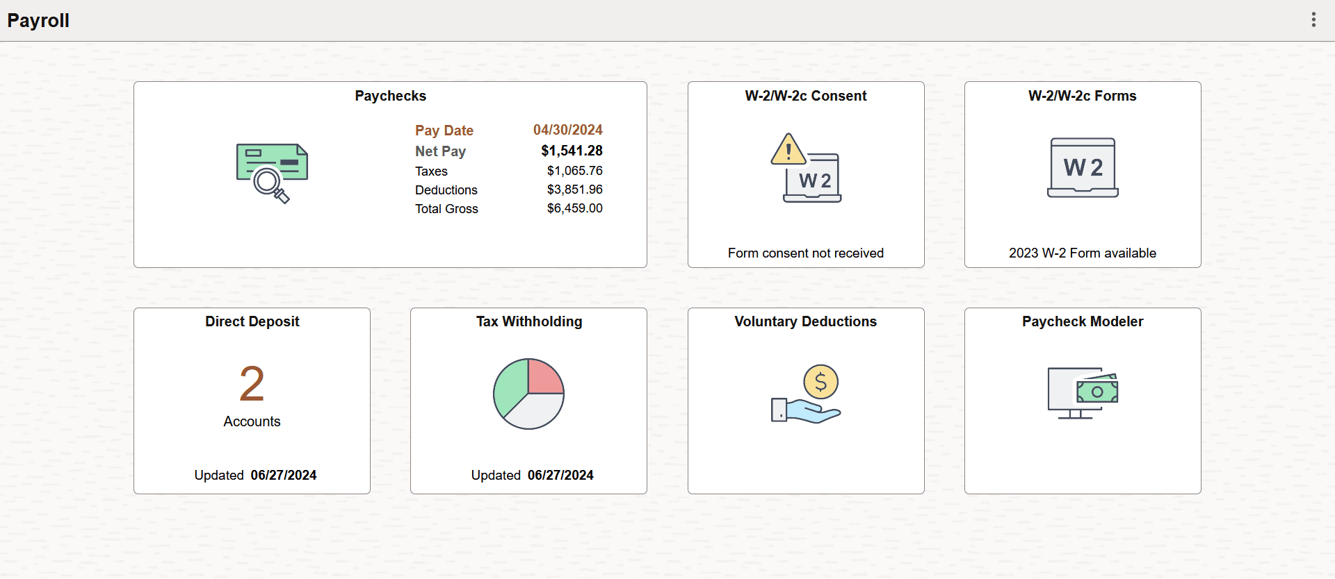

This example illustrates additional self-service transactions that are accessible from the Payroll tile.
Additional self-service transactions accessible from the Payroll tile
