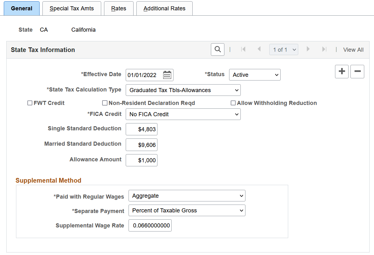

Tax Table - General Page
STATE_TAX_TABLE1
View standard deductions, allowance amounts, and supplemental rates.

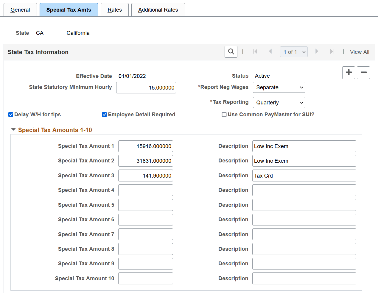

Special Tax Amts Page
STATE_TAX_TABLE2
View information needed for tax calculations. The page for the Federal Tax Table differs from the one for specific states.

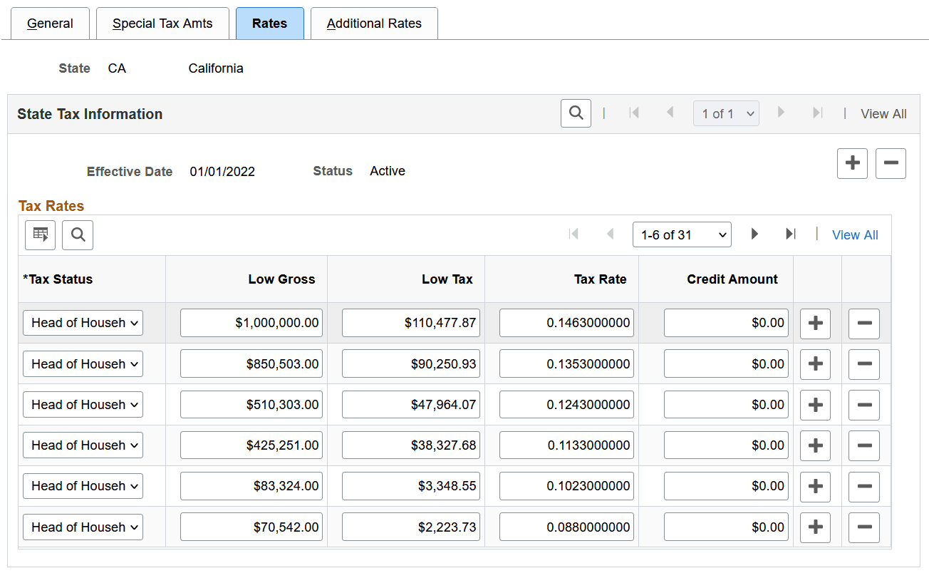

Tax Table - Rates Page
STATE_TAX_TABLE3
View wage bracket information. Contains data from Connecticut Table B - Withholding Tax.

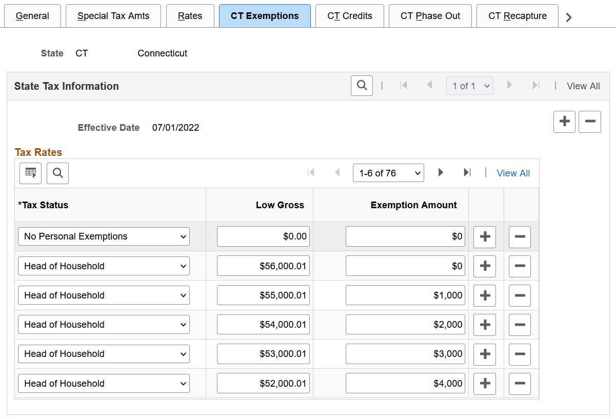

CT Exemptions Page
STATE_TAX_TABLE3_A
(Available only when the state entered is CT.) View the tax status, low gross, and exemption amount, from Connecticut Table A - Exemptions, that are used for calculating Connecticut state tax exemptions.

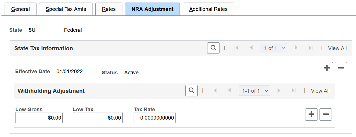

NRA Adjustment Page
STATE_TAX_TABLE3A
(Available only when the state entered is Federal, $U.) View the withholding adjustment rate to use for nonresident alien wages.

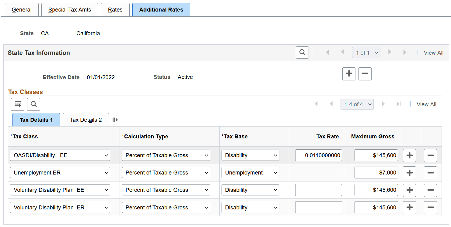

Tax Table - Additional Rates Page
STATE_TAX_TABLE4
View wage limits for unemployment and disability taxes.

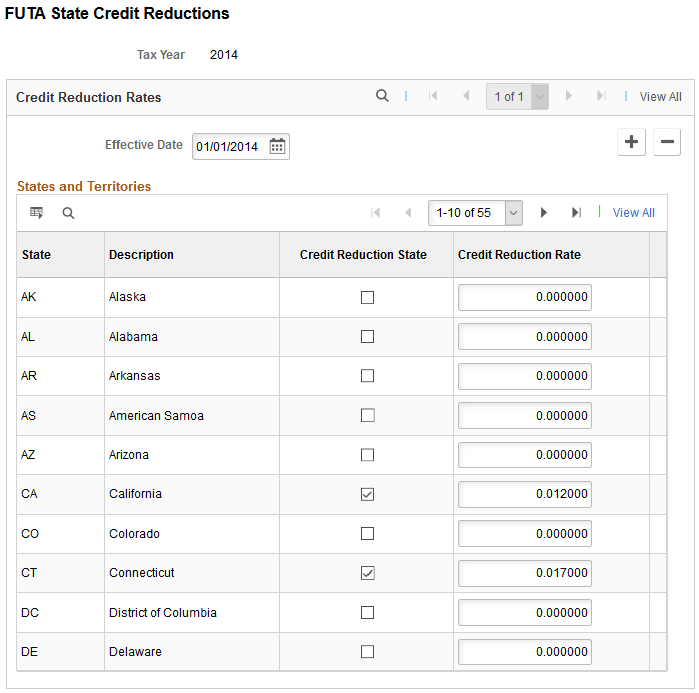

FUTA State Credit Reductions Page
STATE_FUTA_CR_RED
View and define official FUTA credit reduction states.

(Federal/State Taxes) Tax Table - Additional Rates Page
Added new table entry to the State Tax Table for the state, which includes tax classes and the state program rates.

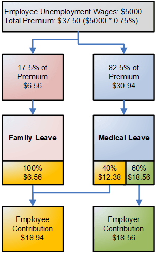

Premium Calculation Example
This example illustrates the calculation of premium payments for Massachusetts Paid Family and Medical Leave. The employer in this scenario has more than 25 covered employees, which means that the employer is responsible for the employer share of the medical leave premium.
The rate used in this example is effective as of October 1, 2019, and is subject to change.
For an employee who earned $5,000 in unemployment wages, the total premium payment is $37.5 ($5,000 * 0.75%). The Family Leave portion of the premium is $6.56 ($37.5 * 17.5%), which is contributed entirely by the employee. The Medical Leave portion of the premium is $30.94 ($37.5 * 82.5%), which is split between the employee ($30.94 * 40%) and the employer ($30.94 * 60%).
This diagram illustrates the example of a premium calculation for Massachusetts Paid Family and Medical Leave.
Example of Massachusetts Paid Family and Medical Leave Premium Calculation

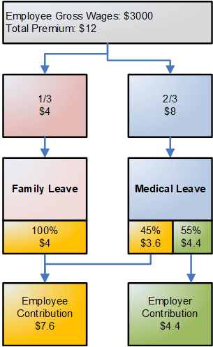

This example illustrates the calculation of premium payments for Washington Paid Family and Medical Leave. The rate used in this example is effective as of January 2, 2019, and is subject to change.
For an employee who earned $3,000 in gross wages, the total premium is $12 ($3,000 * 0.04%). This equates to a maximum employee deduction of $7.6 and a minimum employer contribution of $4.4.
This diagram illustrates the example of a premium calculation for Washington Paid Family and Medical Leave.
Example of Washington Paid Family and Medical Leave Calculation
On the Tax Table - Additional Rates Page, the Tax Class Statewide Transit Tax represents the employee-only statewide transit tax for Oregon employees. Revenue from this transit tax will be used in expanding public transportation throughout Oregon.
Employers are required to deduct the transit tax at a rate (which is stored in the state tax table) from:
  • All wages paid to Oregon residents regardless of their work location, and
  • Wages paid to Oregon nonresidents for work performed within the state.

Use the Tax Table - General page (STATE_TAX_TABLE1) to view standard deductions, allowance amounts, and supplemental rates.
Navigation:
Set Up HCM > Product Related > Payroll for North America > Federal/State Taxes > Tax Table > General
This example illustrates the fields and controls on the Tax Table - General page.
Note: You shouldn't need to modify this table, but if you must, you can make changes if you have the appropriate security authorization. This applies to all pages in this component.
Field or Control
Description
State Tax Calculation Type
Indicates the type of withholding tax calculation required by the state.
FWT Credit
This check box indicates whether credit is given for FWT during calculation of state income tax withholding.
Non-Resident Declaration Required
This check box indicates whether the state requires a Non-Resident Declaration for non-resident employees.
Allow Withholding Reduction
This check box indicates whether the state allows a reduction amount to be computed in the state withholding calculation. Currently, this only applies to Connecticut.
FICA Credit
This check box indicates whether credit is given for FICA during calculation of state income tax withholding.
Supplemental Method
Details of the values available for selection in this group box and examples of calculations are provided in this product documentation.
See Supplemental Tax Calculations.
Field or Control
Description
Paid With Regular Wages
PeopleSoft delivers the required selection: Aggregate − No Annualize, Aggregate, Aggregate-No Tax else Percent, Non-Resident Supplemental, Not Applicable, Percent of Taxable Gross, Special Table with Exemptions, and Special Table.
Separate Payment
Use the Special Tax Amts page (STATE_TAX_TABLE2) to view information needed for tax calculations.
Navigation:
Set Up HCM > Product Related > Payroll for North America > Federal/State Taxes > Tax Table > Special Tax Amts
This example illustrates the fields and controls on the Special Tax Amts page.
Special Tax Amts (special tax amounts) page
Note: The page for the Federal Tax Table differs from the one for specific states.
Field or Control
Description
State Statutory Minimum Hourly
The system uses this field to calculate tip credit to pay overtime for tipped employees. The minimum hourly rate required by that state appears here.
The system also uses this field to retrieve the state minimum wage that is required when the state hourly minimum wage is required for garnishment as set on the Calculation Formula Page.
State Tips W/H Threshold (state tips withholding threshold)
This field appears if the value in the State field is $U.
This field is used in conjunction with state regulations for delaying the withholding of taxes on tips until the employee reports monthly tips in the amount equal to the threshold amount. This field displays the monthly threshold amount from the federal regulations and as of now all states use that threshold amount.
For states that allow you to delay withholding on tips, you can specify by Pay Group whether you delay withholding on tips.
Report Neg Wages
Options are include or separate.
Tax Reporting
Options include Annual, Monthly, or Quarterly.
Delay W/H for tips
On this page, this check box refers to state income tax.
For each state, PeopleSoft selects or deselects this check box, depending on whether the state allows employers to delay withholding on tip income until the monthly threshold amount is reached. For states that allow you to delay withholding on tips, you can specify by Pay Group whether you'll delay withholding on tips.
Employee Detail Required
This field is informational only and indicates whether a state requires the quarterly reporting of individual employee wage data. All states currently require such reporting.
Use Common PayMaster for SUI?
This check box is selected if the state recognizes common paymaster status between companies for purposes of state unemployment insurance taxes.
Special Tax Amount 1
This field is used to store parameters or values used in withholding tax calculations for the selected state or federal jurisdiction.
Special Tax Amount 2
When the selected state is Federal ($U), the amount displayed in Special Tax Amount 2 is the YTD wage threshold that triggers withholding of the federally required Additional Medicare Tax. Once the YTD maximum threshold income is reached, additional medicare will be calculated. There is no limit on the amount of wages subject to the Additional Medicare Tax during the remainder of the tax year.
Special Tax Amount 5
When the selected state is Federal ($U), the amount displayed is the amount that the system adds to the annualized wages of the nonresident alien (NRA) solely for purposes of NRA tax withholding calculation. This amount does not add to the employee's federal taxable gross balance.
Use the Tax Table - Rates page (STATE_TAX_TABLE3) to view wage bracket information.
Navigation:
Set Up HCM > Product Related > Payroll for North America > Federal/State Taxes > Tax Table > Rates
This example illustrates the fields and controls on the Tax Table - Rates page.
(CT) This page contains data from Connecticut Table B - Withholding Tax.
Field or Control
Description
Tax Status
The appropriate Federal/State tax status (Married, Single, and so on).
Note: Puerto Rico: Head of Household is not a valid tax status for wages paid on or after January 1, 2012.
See Employer’s Guide to Withholding of Income Tax at Source on Wages paid after Dec 31, 2011 but before Jan 1, 2013 published by Departamento de Hacienda.
Low Gross
The minimum taxable gross for the bracket.
Low Tax
The tax to be withheld on the corresponding minimum taxable gross.
Tax Rate
The rate to be applied until the next bracket is reached.
Credit Amount
Displays the credit amount for the bracket, which varies depending on the corresponding tax status and minimum taxable gross.
Use the CT Exemptions page (STATE_TAX_TABLE3_A) to view the tax status, low gross, and exemption amount, from Connecticut Table A - Exemptions, that are used for calculating Connecticut state tax exemptions.
Navigation:
Set Up HCM > Product Related > Payroll for North America > Federal/State Taxes > Tax Table > CT Exemptions
This example illustrates the fields and controls on the Connecticut Exemptions page.
CT (Connecticut) Exemptions page
Note: The CT Exemptions page is Available only when the state entered in the Tax Table search dialog is CT.
When you access the Federal/State Taxes, Tax Table component for the state of CT (Connecticut), CT-specific data and pages appear. The CT-specific pages store values used in the calculation of Connecticut state taxes.
  • The Rates page contains values from Connecticut Table B - Withholding Tax.
  • The CT Exemptions page contains values from Connecticut Table A - Exemptions.
  • The CT Credits page contains values from Connecticut Table E - Personal Tax Credits.
  • The CT Phase Out page contains values from Connecticut Table C - 3% Phase-Out.
  • The CT Recapture page contains values from Connecticut Table D - Tax Recapture.
Use the NRA Adjustment page (STATE_TAX_TABLE3A) to view the withholding adjustment rate to use for nonresident alien wages.
Navigation:
Set Up HCM > Product Related > Payroll for North America > Federal/State Taxes > Tax Table > NRA Adjustment
This example illustrates the fields and controls on the Nonresident Alien Adjustment page.
NRA Adjustment page
Note: The NRA Adjustment page is available only when the State = $U (Federal).
View the income, tax, and withholding rate to use to calculate the additional withholding adjustment amount required by IRS for nonresident alien wages.

Use the Tax Table - Additional Rates page (STATE_TAX_TABLE4) to view wage limits for unemployment and disability taxes.
Navigation:
Set Up HCM > Product Related > Payroll for North America > Federal/State Taxes > Tax Table > Additional Rates
This example illustrates the fields and controls on the Tax Table - Additional Rates page.
Note: (For Program Funding Configuration feature only) PeopleSoft delivers state tax table updates to support state programs using scripts.
Field or Control
Description
Tax Class
Tax classes identify different taxes that share certain characteristics.
For example, Local Services Tax represents Local Services Tax (LST) for Pennsylvania employees.
Calculation Type
Options are Not Applicable, Percent of Taxable Gross, and Use ER Wage for EE Tax.
Tax Base
Options are Disability, Paid Benefit, Paid Benefit - Other,Unemployment, and Withholding.
Tax Rate
The tax rate for employer unemployment, voluntary disability/paid benefit contributions is blank on this page. The rate used during payroll calculations comes from the Company State Tax table.
Note: (For Program Funding Configuration feature only) When you add a new row on this page for a tax class that is also referenced on the Program ID Association Page for the same state and effective date, the Tax Rate field becomes editable if the Display Tax Rate option on the association page is selected.
Maximum Gross
If a tax applies only to a portion of an employee's annual wages up to a specified limit, such as employer unemployment taxes, that limit amount appears in this field. An entry of all 9s, as with Medicare taxes, indicates a tax without limit.
Maximum Tax
If there is an annual limit on a particular type of tax, such as Pennsylvania's Local Services Tax, enter that limit amount here.
Taxability
Select Employee Tax Only, Employer Tax Only, Empl and Emplr Tax, or Memo Tax Only to indicate whether a tax is paid by the employee, paid by the employer, or paid in equal matching amounts by both.
Ratio
(MA and WA) This value represents the ratio of the total premium to be allocated to the corresponding tax.
Note: (For Program Funding Configuration feature only) When you add a new row on this page for a tax class that is also referenced on the Program ID Association Page for the same state and effective date, the Ratio field becomes editable if the Display Ratio option on the association page is selected. The sum of ratio values for all tax classes with the same ratio ID must be 1.
Period Maximum
If selected, this option indicates that the tax is calculated for a period other than annual. Two examples of this are SDI in New York and Hawaii, both of which have weekly maximums.
Self Adjust (self-adjusting)
This check box is for information only and does not affect processing.
Delay W/H for Tips (delay withholding for tips)
On this page, this check box is selected or deselected for each additional tax the state may impose.
Voluntary Disability Plans
Of the states that provide disability insurance plans (currently California, Hawaii, New Jersey, New York, Rhode Island, plus Puerto Rico), all but Rhode Island allow employers to provide voluntary disability plans in place of the state plan. PeopleSoft maintains the Tax Class rows on the Federal/State Tax Table - Additional Rates page for the Employer and Employee paid tax for voluntary disability plans for each of these states.
Note: If you implement a voluntary disability plan for California, Hawaii, New Jersey, New York, or Puerto Rico, you must set up the appropriate tax rates on the Company State Tax table and the VDI/FLI Administrator table.
State Unemployment Insurance (SUI) Tax
You must make sure that the unemployment insurance taxable gross and tax balances transferred during the conversion process are consistent with the unemployment tax rates that have been entered for each quarter on the Company State Tax Table page.
Warning! If these amounts are not consistent and in balance, the system will either charge or refund additional unemployment tax amounts to account for the difference in the quarterly unemployment insurance tax balances.
Use the FUTA State Credit Reductions page (STATE_FUTA_CR_RED) to define official FUTA credit reduction states.
Navigation:
Set Up HCM > Product Related > Payroll for North America > Federal/State Taxes > FUTA State Credit Reductions
This example illustrates the fields and controls on the FUTA State Credit Reductions page.
The standard net effective FUTA tax (Unemployment ER) rate is defined on the Tax Table - Additional Rates Page. You can calculate any additional U.S. Federal unemployment tax for which you may be liable as a result of paying wages to employees in credit reduction states.
An employer calculates additional FUTA tax liability for credit reduction states on Form 940 Schedule A, and the total calculated credit reduction for all states is transferred to line 11 on Form 940, the Employer’s Annual Federal Unemployment Tax (FUTA) Return.
Important! PeopleSoft does not maintain this page. If you intend to use the FUTA credit reduction functionality, then your organization must update the page to keep it current. Credit reduction states are determined by the U.S. Department of Labor. Each November, the U.S. Department of Labor publishes a list of credit reduction states (and their respective credit reduction rates) for the tax year which is about to conclude. See “Subject Data Available” on the US Government website http://workforcesecurity.doleta.gov/unemploy/finance.asp.The list is also included in the PeopleSoft December tax update each year.
Field or Control
Description
Credit Reduction State
Select this check box to indicate that the state is an official FUTA credit reduction state.
Once you have confirmed a payroll with a particular state identified as a Credit Reduction State, do not deselect the Credit Reduction State check box for that state until after the final payroll for the tax year has been calculated and confirmed.
Warning! To end a state’s status as a Credit Reduction State mid-year, change the value in the Credit Reduction Rate field to zero; do not deselect the selected Credit Reduction State check box. This point is critical to maintaining the self-adjusting feature of the FUTA Credit Reduction Tax.
When selected, FUTA Credit Reduction (additional FUTA) is calculated as follows for employees whose UI Jurisdiction state is that state:
  • Uses the rate specified in the Credit Reduction Rate field for the employee’s current UI Jurisdiction state.
  • If the value in the Credit Reduction Rate field is increased mid-year to a higher rate, the self-adjusting feature generates positive adjustments the next time that pay is calculated for an employee.
  • If the value in the Credit Reduction Rate field is reduced mid-year to a lower rate or to zero, the self-adjusting feature generates negative adjustments the next time that pay is calculated for an employee.
If the Credit Reduction State check box is not selected, FUTA Credit Reduction (additional FUTA) taxable wages are calculated, but tax is not calculated, even of a value is specified in the Credit Reduction Rate field. The Credit Reduction State check box must be selected for FUTA Credit Reduction (additional FUTA) tax to be calculated.
For more information on FUTA Credit Reduction States and how they affect an employer’s unemployment taxes, refer to the Internal Revenue Service website, which as of the date of this publication is: http://www.irs.gov/Businesses/Small-Businesses-&-Self-Employed/FUTA-Credit-Reduction.
