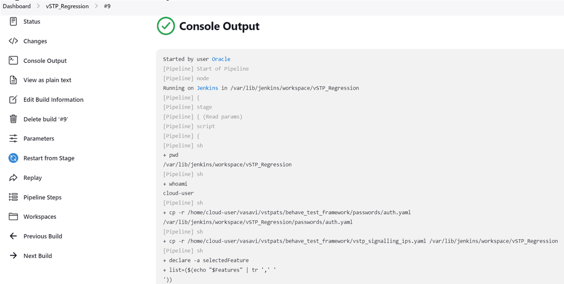

  4. To perform the VDSR health check, click the corresponding Perform the VDSR health check button.
    1. In the lower-left corner of the GUI, in the Build History area, click Successful Build or Failed Build to check the log in Console Output.
      If the build has failed, then the Successful Build icon appears red ( Failed Build). This indicates that the log contains DSR alarms.
      The following image provides an example of a console output:
      Figure 6-26 Console Output
      Console Output
    2. If the log contains DSR alarms, clear the alarm and then perform the VDSR health check again by clicking the corresponding health check button (
      Health check button
      If the build is successful, in the Build History area, the Failed Build turns Successful Build.

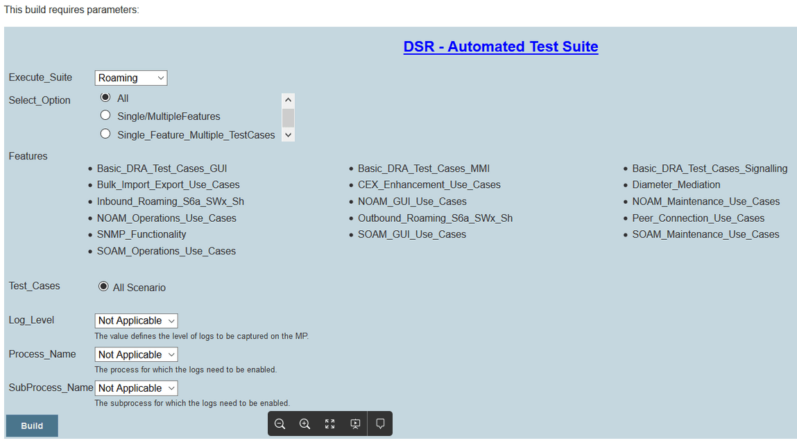

  5. To perform Regression, click the corresponding
    Perform regression
    button.
    The DSR - Automated Test Suite page appears.
    Figure 6-27 Regression Parameters
    1. Configure the parameters as described in Regression Parameters.
      You can change the rerun count in the /var/lib/jenkins/workspace/Regression directory.
    2. Click Build.
    3. In the lower-left corner of the GUI, in the Build History area, click Successful Build or Failed Build to check the log in Console Output.

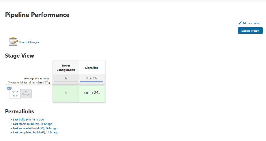

  6. To check the Performance, click the corresponding
    Performance
    button.
    The following image provides an example of a Performance build.
    Figure 6-28 Performance Build
    Performance Build
