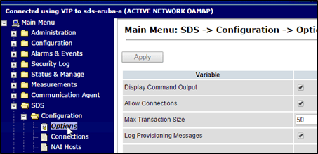

  14. In the Primary SDS NOAM VIP, record PDB Relay Enabled state. Expand SDS select Configuration click Options.
    Figure A-49 Options
    Options
  15. Locate the PDB Relay Enable check box and record if it is checked or not checked.
    Figure A-50 PDB Relay Enable check box
    If the PDB Relay Enabled checkbox is CHECKED, then continue with the next step of this procedure. If the PDB Relay Enabled checkbox is NOT CHECKED, then skip to step 19 of this procedure.

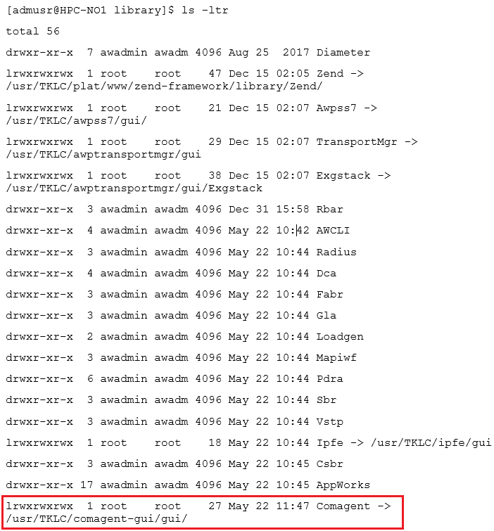

  32. Restore softlink for Comagent directory.
    [admusr@HPC-NO1 ~]$ cd /var/TKLC/appworks/library
    $ sudo ln -s /usr/TKLC/comagent-gui/gui/ Comagent
    Verify if the Comagent link has been restored:
    Figure A-51 Comagent link
    Comagent link
    If the output is received as highlighted in red, the softlink for Comagent directory has been restored.

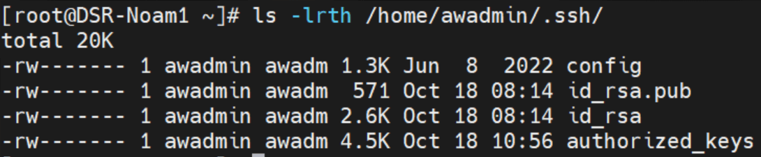

  35. Verify if the file id_rsa has required ownership, check the ownership of the file:
    ls –ltr /home/awadmin/.ssh/
    The file permission should be defined as shown:
    Figure A-52 Permission
    Permission
    If the file ownership is not set for awadmin, then change the permission:
    sudo chown awadmin:awadm /home/awadmin/.ssh/id_rsa
    Verify file ownership is changed to awadmin awadm.
