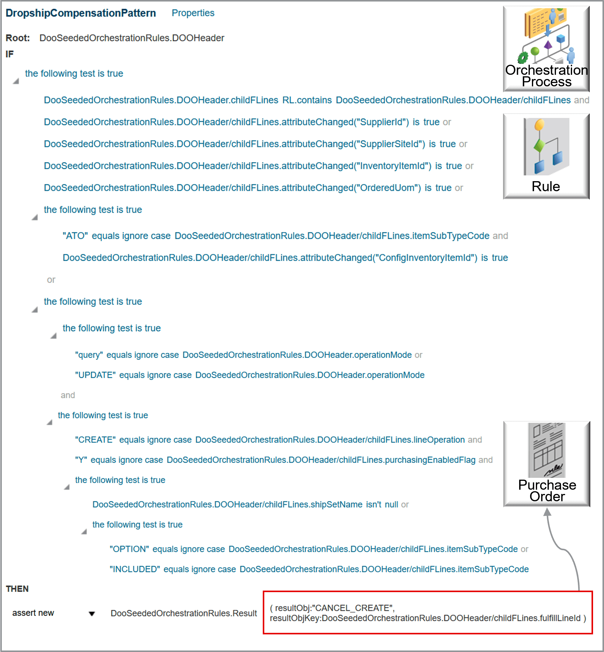

報酬パターンのテキスト・バージョンを次に示します。
Root: DooSeededOrchestrationRules.DOOHeader
  IF the following test is true
    DooSeededOrchestrationRules.DOOHeader.childFLines RL.contains   DooSeededOrchestrationRules.DOOHeader/childFLines and
    DooSeededOrchestrationRules.DOOHeader/childFLines.attributeChanged("SupplierId") is true or
    DooSeededOrchestrationRules.DOOHeader/childFLines.attributeChanged("SupplierSiteId") is true or
    DooSeededOrchestrationRules.DOOHeader/childFLines.attributeChanged("InventoryItemId") is true or
    DooSeededOrchestrationRules.DOOHeader/childFLines.attributeChanged("OrderedUom")is true or
      "ATO" equals ignore case DooSeededOrchestrationRules.DOOHeader/childFLines.itemSubTypeCode and
      DooSeededOrchestrationRules.DOOHeader/childFLines.attributeChanged("ConfigInventoryItemId") is tr
    or
        "query" equals ignore case DooSeededOrchestrationRules.DOOHeader.operationMode or
        "UPDATE" equals ignore case DooSeededOrchestrationRules.DOOHeader.operationMode
      and
        "CREATE" equals ignore case DooSeededOrchestrationRules.DOOHeader/childFLines.lineOperation and
        "Y" equals ignore case DooSeededOrchestrationRules.DOOHeader/childFLines.purchasingEnabledFlag and
          DooSeededOrchestrationRules.DOOHeader/childFLines.shipSetName isn't null or
            "OPTION" equals ignore case DooSeededOrchestrationRules.DOOHeader/childFLines.itemSubTypeCode or
            "INCLUDED" equals ignore case DooSeededOrchestrationRules.DOOHeader/childFLines.itemSubTypeCode
THEN
  assert new DooSeededOrchestrationRules.Result ( resultObj:"CANCEL_CREATE", resultObjKey:DooSeededOrchestrationRules.DOOHeader/childFLines.fulfillLineId )
