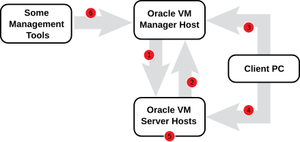

The diagram and table below illustrate the firewall rules and requirements for Oracle VM.
Table 4.2 Firewall Rules
| No. | Component Relationship | Ports and Description | Optional |
1 | Oracle VM Manager to Oracle VM Server |
| No |
2 | Oracle VM Server to Oracle VM Manager |
| No |
3 | Client PC to Oracle VM Manager |
| No, although access to services should be limited to requirements |
4 | Client PC to Oracle VM Server |
| Yes |
5 | Oracle VM Server to Oracle VM Server |
| No |
6 | Some Management Tools to Oracle VM Manager |
| Yes |
The following instructions explain how to resolve any firewall requirements manually, and assume that you have decided not to use the environment configuration script provided with the Oracle VM Manager installer.
