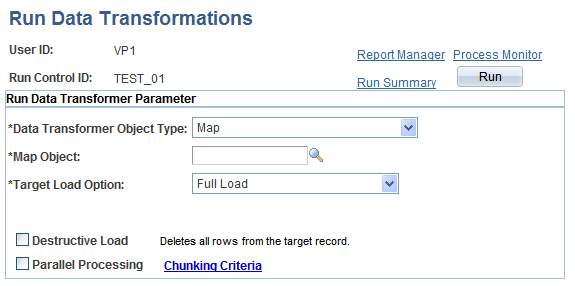

Use the Run Data Transformations page (EOEW_RUN_ETL) to define run control criteria for and run the data transformation process.
Image: Run Data Transformations page
This example illustrates the fields and controls on the Run Data Transformations page. You can find definitions for the fields and controls later on this page.
Note: The data transformation process uses the Data Transformation Application Engine process (EOEW_ETL_EXE).

Data Transformer Object Type
Select a Data Transformer object type. You can run either a Map or Map Group.
Note: PeopleSoft Catalog Management uses the run control ID RUN_MAP to load partner source data. When using this run control ID, the Data Transformer object type must be Map.
Map Object
Select a map object. The prompt for available field values is based on the Data Transformer object type.
Target Load Option
Select a target load option.
Full Load. Extracts all data from the source as defined by the source data object and inserts into the target.
Incremental Update. Copies all rows from the source table that have been updated or modified since the last load, based on the date/time the row was updated or modified. The Map Options page must have a date/timestamp field defined in order to use incremental load.
Destructive Load
Select to delete all rows from the target table before the new rows are inserted.
Warning! Use this option with caution, as this will delete all rows in the target table.
Parallel Processing
Select to run the process in parallel mode, which runs the processes simultaneously. Clear to run it in serial mode, which runs each process in the chunk sequentially.
Note: This option is only available if the Object Type is Map.
Chunking Criteria
Click to access the Map Group Filter page to define chunking criteria for the associated map.
See Map Group Filter Page.
Note: This link is only available for Group Types of Map. If you want to chunk a group, you need to go to that group's definition to define the criteria.
Run
Click to run the data transformation process. A process request is submitted.
Click the Process Monitor link to monitor the status of the request.

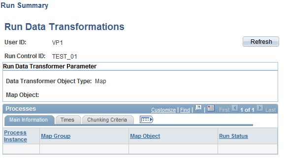

Use the Run Data Transformations - Run Summary page (EOEW_RUN_ETL_SUM) to view information about only the jobs related to a particular data transformation process run control.
Image: Run Data Transformations - Run Summary page
This example illustrates the fields and controls on the Run Data Transformations - Run Summary page. You can find definitions for the fields and controls later on this page.
After running a data transformation process by clicking Run on the Run Data Transformations page, you can access the Run Summary page just as you would access Report Manager or Process Monitor.
Although the Process Monitor provides information regarding a process run, the Run Summary feature offers a more granular view of the individual subprocesses, such as chunks, that are not exposed in the Process Monitor. For example, a single map containing chunks or a group can spawn numerous jobs. If you use the Process Monitor to view these jobs, you find that the numerous jobs that are associated with a single map are mixed in with all of the other jobs that are currently running. Depending on the number of jobs that are running, this can make it difficult to view only those jobs that are associated with a particular Data Transformer process run control.
However, by using the Run Summary feature you can view all of the jobs that were spawned for the run control that is associated with a particular run on of the Data Transformer process. The Run Summary feature is especially useful when running parallel processes that are associated with multiple maps. By using the Run Summary feature, you can associate a process instance with each chunk as it runs.
The Run Summary feature enables you to see:
  • Which subprocesses are involved within a particular data transformation process run control.
  • When a particular subprocess (chunk or map) begins.
  • When a particular subprocess (chunk or map) completes.
  • Which subprocesses didn't complete successfully.
  • Which process instance is associated with a particular chunk or map.
Main Information
Select the Main Information tab.
Field or Control
Definition
Process Instance
Displays the PeopleSoft Process Scheduler process instance that is assigned to the individual process. This value also appears on the Times and Chunking Criteria tabs for consistent identification.
Note: For parallel processes, you see different process instances; for serial processes, you see the same process instance.
Run Status
Reflects the same status that appears in the Process Monitor. If the run status displays an error, go to the Process Monitor to troubleshoot and restart the process.
Times
Select the Times tab.
Use these times to track the performance of the processes.
Chunking Criteria
Select the Chunking Criteria tab.
Field or Control
Definition
Chunking Where clause
Displays information about the chunking criteria that is specified for a particular map, including:
  • Relational operators (=, <, >, and so on).
  • Boolean operators (AND and OR).
Note: This page also displays information that is relevant only to the internal aspects of the PeopleSoft mapping functionality.
The field names that are used for chunking are converted to an internal format; therefore, the format of the Chunking Where clause may not necessarily be a true reflection. That is, it may contain an extra “AND (“), for example. However, determining the chunking criteria that is used can be very useful when you are troubleshooting.
Also, values that are similar to EOEW_FP_CHAR30_0 are used internally by the PeopleSoft system to store data in a temporary table while the data is being transformed and loaded.
