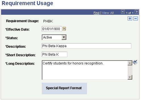

Access the Requirement Usage page (select Academic Advisement, then select Academic Requirements, then select Define Requirement Usages).
Image: Requirement Usage page
This example illustrates the fields and controls on the Requirement Usage page. You can find definitions for the fields and controls later on this page.
Note: If the requirement usage is a delivered system value, No Special Formatting appears on this page. Delivered requirement usages result in a transcript that includes an advising report. If the requirement usage results in a special advising report as selected on the Basic Data page,Special Report Format appears on this page.
Field or Control
Definition
Effective Date
Enter an effective date for this requirement usage. The effective date defines when the status that you select is valid. If any of the requirement usage information changes, you should add a new effective-dated row. When you create an academic requirement group that references this requirement usage, the effective date of the requirement usage must be less than or equal to the effective date of the academic requirement group.
Status
Select the status of the requirement usage. Values are:
Active: Select to add a new requirement usage.
Inactive: Select only if your institution will no longer use this requirement usage. If any of the requirement group information changes, you should add a new effective-dated row.
Values for this field are delivered with the system as translate values. Do not modify these values in any way. Any modifications to these values will require a substantial programming effort.
Description, Short Description, and Long Description
Enter a description to use as a search key and to appear in prompts for requirement usage values. The description should accurately describe the requirement usage so that the label is meaningful as a search key. For example, a description of Phi Beta Kappa helps to identify this requirement. The short description appears only on this page. The long description appears on the advising report.
Note: Once you have established a requirement usage, a maximum of 30 requirement groups that are flagged with this usage are pulled into audits with this usage specified as part of the transcript type.
