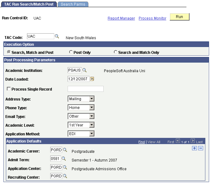

Access the TAC Run Search/Match Post page (select Student Admissions, then select TAC Processing, then select Search/Match/Post TAC, then select TAC Run Search/Match Post).
Image: TAC Run Search/Match Post page
This example illustrates the fields and controls on the TAC Run Search/Match Post page. You can find definitions for the fields and controls later on this page.
Enter the TAC test ID that you want to process. Once the TAC test ID is entered, the additional fields specific to the TAC will appear. You must have test ID security established to select a value. The prompt will only display test IDs for which you have security. This field is required.
Execution Option
Field or Control
Definition
Search, Match and Post
Select this option if you want the process to search your database for records that match the suspense record and post the suspense data to your database.
Post Only
Select this option if you only want to post the suspense data to your database (if you select this option, you must have already run search/match).
Search and Match Only
Select this option if you only want to run the search and match process on the suspense file. You will need to post the data later.
Post Processing Parameters
Field or Control
Definition
Academic Institution
Enter the academic institution to which the applicant data will be posted.
Date Loaded
Enter the date for the data load.
Process Single Record
If you prefer to process and post a single record, in the Post Processing Parameters group box, select the Process Single Record check box and specify the external applicant number. Rather than processing the entire file, you can quickly process a single record. If you prefer to process the entire suspense file, do not select Process Single Record.
Address Type
If the search/match/post process adds a new record to your database, the process loads the address information from the TAC suspense record into the Addresses page. Select the address type that you want the process to assign to the new address. Define address types in the Address Type table.
For VTAC data:
  • The search/match/post process assigns the address type that is set on the TAC Run Search/Match Post page to the postal address referenced on the Personal Information suspense page.
  • The search/match/post process assigns the home address type set on the Campus Community Installation - Names / Addresses page to the residential address.
  • If the Campus Community home address type field and the Address Type field have the same value (for example, campus), the search/match/post process posts only the postal address to the database and does not post the residential address.
Note: Do not select an address type if you want to post a SATAC file. The TAC Load process, by default, assigns the MAIL address type to the postal addresses provided by SATAC. Additionally, the TAC Load process, by default, assigns the HOME address type to the current addresses provided by SATAC.
Phone Type
Select the phone type that you want the process to assign.
Email Type
Select the email type that you want the process to assign.
Academic Level
Select the default academic level for this upload of applicants.
Application Method
Select the default application method for this upload of applicants.
Academic Career
Enter the academic career to which applicants will be posted.
Admit Term
Enter the admit term for the applicants.
Application Center
Enter the default application center for these applicants.
Recruiting Center
Enter the default recruiting center for this upload of applicants.

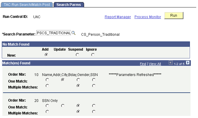

Access the Search Parms page (select Student Admissions, then select TAC Processing, then select Search/Match/Post TAC, then select Search Parms).
Image: Search Parms page
This example illustrates the fields and controls on the Search Parms page. You can find definitions for the fields and controls later on this page.
Search Parms page
Use the Search Parameter field to select the group of predefined search parameters you want to use for the process.
Note: The words Parameters Refreshed appear if this is the first time that you have entered this page with this run control ID, or if any of the parameters on this page changed since the last time you accessed this page with this run control ID.
No Match Found
Field or Control
Definition
New
Select one of the following options to specify what the search/match/post process should do when it does not find a matching record in your database:
Add: Add the unmatched record to your database, including personal data.
Suspend: Keep the unmatched record in the suspense file to be looked at manually.
Ignore: Ignore the unmatched record completely. The process marks the record to be purged.
Match(es) Found
This group box contains one row for each search/match criteria order defined by your institution. Define search/match orders on the Search/Match Criteria page.
Field or Control
Definition
Order Nbr (order number)
For each order number, select what you want to do with the record if the search/match/post process discovers one or more matching records.
One Match and Multiple Matches
Select whether you want to add, update, suspend, or ignore matching records:
Add: Add a new record to your database using the suspense record.
Update: Update the existing record with the data in the suspense record.
Suspend: Keep the suspense record back in the suspense table.
You need to determine manually whether or not this record matches a record in your database.
Ignore: Ignore the suspense record that matched a record in your database.
