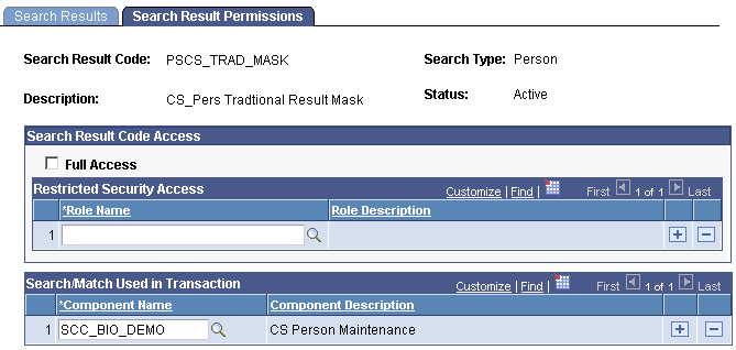

Search Result Permissions
HCR_SM_RSLT_PERM
select Set Up SACR, then select System Administration, then select Utilities, then select Search/Match, then select Search/Match Results, then select Search Result Permissions
Identify who should have access to this search result code. Also identify which component, if any, Search/Match should use this result code when a new ID is added and a potential duplicate ID is found.

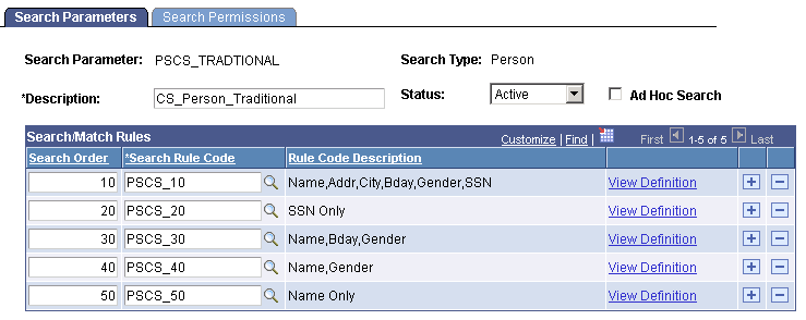

Access the Search Parameters page (select Set Up SACR, then select System Administration, then select Utilities, then select Search/Match, then select Search/Match Parameters, then select Search Parameters).
Image: Search Parameters page
This example illustrates the fields and controls on the Search Parameters page. You can find definitions for the fields and controls later on this page.
Field or Control
Definition
Ad Hoc Search
Select to permit only custom ad hoc searches from this search parameter.
An ad hoc search enables users to bypass the institution's predefined search standards to perform a custom search without predefined operands and without limiting the characters to evaluate. For example, an ad hoc search might be first name equals John; whereas, a non-ad hoc search might be set to search only on the first three characters of the first name (in this case, Joh).
Note: Automatic search cannot be performed from a search parameter set to permit ad hoc searches.
Search/Match Rules
Field or Control
Definition
Search Order
Enter the order in which to apply the search rule codes of this search parameter. Enter the most restrictive search rule in the lowest order number and the least restrictive search rule in the highest order number.
You can reorder the search rules at any time. When you reorder the rules and save the page, the system displays the rules in the most recent numerical order that you entered.
Search/Match processes the lowest order search rule first; if it finds one or more possible matches, it stops the search and returns the results. If it finds no results, it continues to the next search rule, and so on.
In the search results, the system displays the search order number that corresponds to the search rule where potential matching IDs are found.
You can use only one search rule for an ad hoc search; therefore Search Order fields do not appear when theAd Hoc Search check box is selected.
Search Rule Code and Rule Code Description
Enter the search rule code to use. When you exit the field, the system displays the search rule description. You must enter at least one search rule to create a valid search parameter.
View Definition
Click this link to access the Search/Match Rule page on which you can view or edit the rule definition.

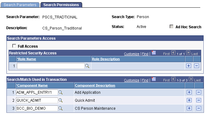

Access the Search Permissions page (select Set Up SACR, then select System Administration, then select Utilities, then select Search/Match, then select Search/Match Parameters, then select Search Permissions).
Image: Search Permissions page
This example illustrates the fields and controls on the Search Permissions page. You can find definitions for the fields and controls later on this page.
Search Parameters Access
Field or Control
Definition
Full Access
Select to enable all users to use the search parameter code.
Restricted Security Access
This area appears only when the Full Access check box is not selected.
Field or Control
Definition
Role Name and Role Description
Restrict the use of this search parameter code to users that have specific roles inside their security profile.
Search/Match Used in Transaction
Field or Control
Definition
Component Name and Component Description
If you want to enforce the use of Search/Match when adding a new ID, select the component name where adding a new ID occurs. The system will then initiate Search/Match when a user enters the data to create a new ID and saves the transaction. You can restrict the search to specific components whether you give permissions to all roles or only to specific roles.
Note: A component name can be associated with only one search parameter. However, the same search parameter can be used inside several component names. Select all components where the search parameter should be used.
If Search/Match finds potential matching IDs that correspond to the data entered, the system returns a warning message indicating that one or more matching IDs was found at search order number XX.
Note: This field is available only when the Search Type is Person or Organization.
See Understanding Automatic Search.

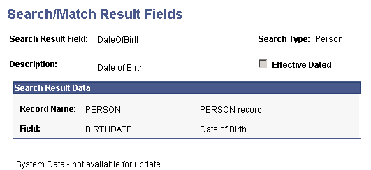

Access the Search/Match Result Fields page (select Set Up SACR, then select System Administration, then select Utilities, then select Search/Match, then select Search/Match Result Fields).
Image: Search/Match Result Fields page
This example illustrates the fields and controls on the Search/Match Result Fields page. You can find definitions for the fields and controls later on this page.
Many Search/Match result fields are delivered predefined and are available for you to use when defining search result codes. The text System Data - not available for update appears for these fields on the Search/Match Result Fields page. You cannot edit the data for the predefined search fields. You can, however, select additional fields to make available for your search result codes.
When you select Add a New Value and enter a name for the results field, the Search/Match Result Fields page appears with enterable fields for you to select the record and field to make available within the search results. To control how the values for a field appear in the results, use the Search/Match Results setup page.
Note: When search result fields are created based on records that are either effective-dated or type-related (such as address type, email type, phone type, and so on), Search/Match returns a row for each of the dates (history, current, and future dates) and types. For example, the field Gender is included in the PERS_DATA_EFFDT record. If you use Gender as a search result field, then a person with multiple rows on PERS_DATA_EFFDT will display multiple rows with the same gender in the search results grid. This is to make sure the evaluation of potential duplicate IDs occurs across all dates and types applicable to each ID. If your institution prefers to see a limited number of rows, you can create the search result fields based on a view that includes logic to limit the effective date to display only current information or logic to return only a specific type (for example select address information where Address Types is Home).

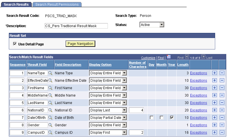

Access the Search Results page select (Set Up SACR, then select System Administration, then select Utilities, then select Search/Match, then select Search/Match Results, then select Search Results).
Image: Search Results page
This example illustrates the fields and controls on the Search Results page. You can find definitions for the fields and controls later on this page.
Search Results page
Result Set
Field or Control
Definition
Use Detail Page
Select this check box to display a Detail link beside each ID returned from a search.
When you select Use Detail Page, the Page Navigation button appears.
Page Navigation
This button appears only when the Use Detail Page check box is selected.
Click to access the Search Results Detail page, on which you can define the page to which you want users to be directed to see more details about a specific ID.
Note: To be transferred to the page that you define here, the user must have security access to the page.
Field or Control
Definition
Sequence
Enter the order by which the system displays results in the in the Search/Match results grid. You can reorder the result fields at any time. When you reorder the fields and save the page, the system displays the result fields in the most recent numerical sequence that you entered.
Result Field and Field Description
Select the data to return with the search results. Fields used to perform the search (search fields) can be different from the fields needed to review the results (result fields).
The result fields are defined in the Search/Match Result Fields page.
Display Option
Displays the default display control for that field. You can override this. Select Display Entire Field or Mask Entire Field to display or hide the entire field value respectively . The other options are:
Display First: Displays the first specified number of characters of the field value. When you select this, the Number of Characters field appears. You must enter the number of characters to display from the beginning of the field value.
Display Last: Displays the last specified number of characters of the field value. When you select this, the Number of Characters field appears. You must enter the number of characters to display from the end of the field value.
Display Partial Date: Displays the specified parts of a date field value. When you select this, the Day, Month, Year check boxes appear. You must select which parts of the date to display. For example if you select Year, only the year will appear.
Enter the number of first or last characters of a field value to display.
Day, Month, Year
Select the parts of the date to display for a date value.
Length
Displays the number of characters possible for the field value.
Exceptions
Click this link to access the Exceptions page, on which you can define field-level exceptions to these results.

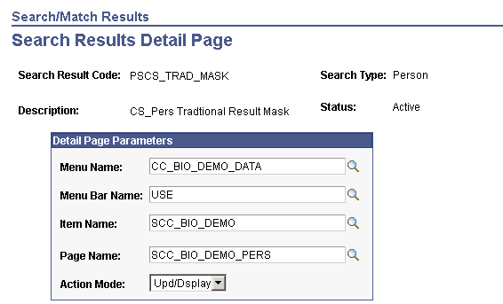

Access the Search Results Detail page (click the Page Navigation button that appears on the Search Results page when you select the Use Detail Page option).
Image: Search Results Detail page
This example illustrates the fields and controls on the Search Results Detail page. You can find definitions for the fields and controls later on this page.
Detail Page Parameters
Field or Control
Definition
Menu Name, Menu Bar Name, Item Name, and Page Name
Select each item that corresponds to the page that you want to use to provide more details about a specific ID.
Action Mode
Select the action mode to define in which mode you want your users to access the detail page. Options are:
Add
Correction
Data Entry
Update/Display
Update

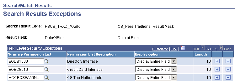

Access the Search Results Exceptions page (click the Exceptions link on the Search Results page).
Image: Search Results Exceptions page
This example illustrates the fields and controls on the Search Results Exceptions page. You can find definitions for the fields and controls later on this page.
You can define exceptions to the search results that you set up on the Search Results page. For example, you might have partially masked the birth date field in your search results, but you want the entire field to appear for those who have a need to know. Using primary permission lists, you can set those exceptions here.
See Preparing for User Profiles Management.
Field Level Security Exceptions
Field or Control
Definition
Primary Permission List and Permission List Description
Select the primary permission lists of the users who will be exceptions to the result field selected. When you exit the field, the system displays the permission list description.
Display Option
Select the display option to use as the exception to the display option selected on the Search Rules page.
Access the Search Result Permissions page (select Set Up SACR, then select System Administration, then select Utilities, then select Search/Match, then select Search/Match Results, then select Search Result Permissions).
Image: Search Result Permissions
This example illustrates the fields and controls on the Search Result Permissions. You can find definitions for the fields and controls later on this page.
Field or Control
Definition
Full Access
Select this check box to enable all users to use the search result code
Enter roles to restrict the use of this search result code to users that have this role inside their security profile.
Component
This field is available only when the Search Type is Person.
If you use automatic search and want to display a warning message to alert users when potential duplicate IDs exist and you want to display the results of the automatic search, select the same component name or names that you selected on the Search Permissions page for the search parameter. You can restrict the search to specific components whether you give permissions to all roles or to only specific roles.
Note: A component name can be associated with only one search result code. However, the same search result code can be used inside several component names. Select all components where the search result code should be used. If Search/Match finds potential matching IDs that correspond to the data entered, the system returns a Search Results page showing the matching IDs that were found.
